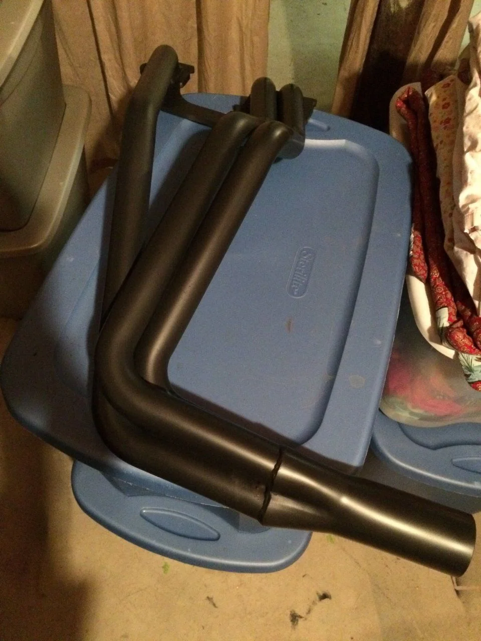

Well when it rains it pours ... Just after the brakes went and I fixed it ... My header cracked... Down at the collector so I welded it ...but... The FetwoOthree monster strikes again it is thin and not liking to hold... Now it sounds bad lol...

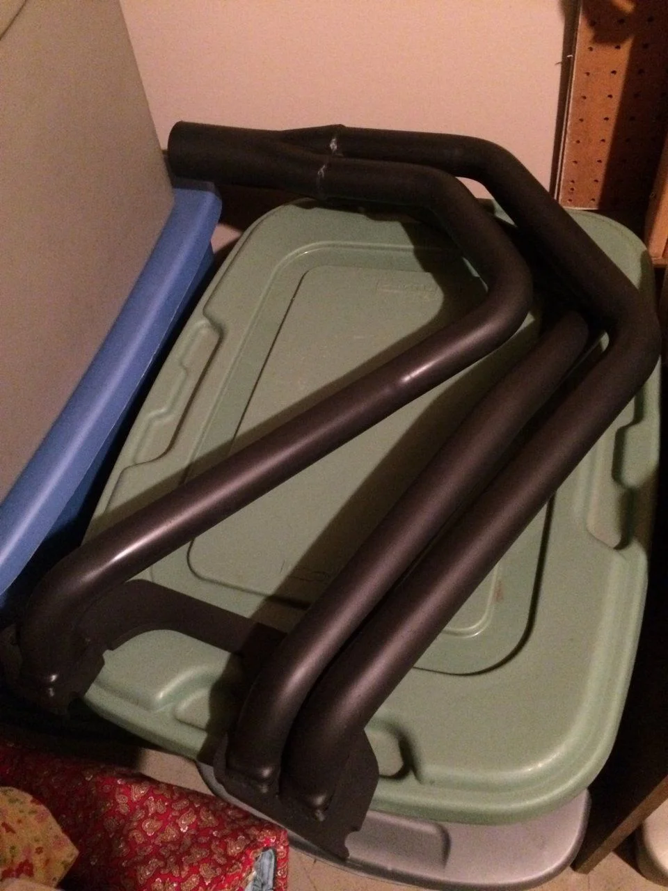

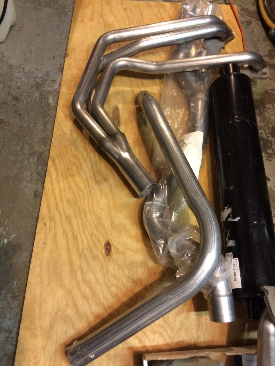

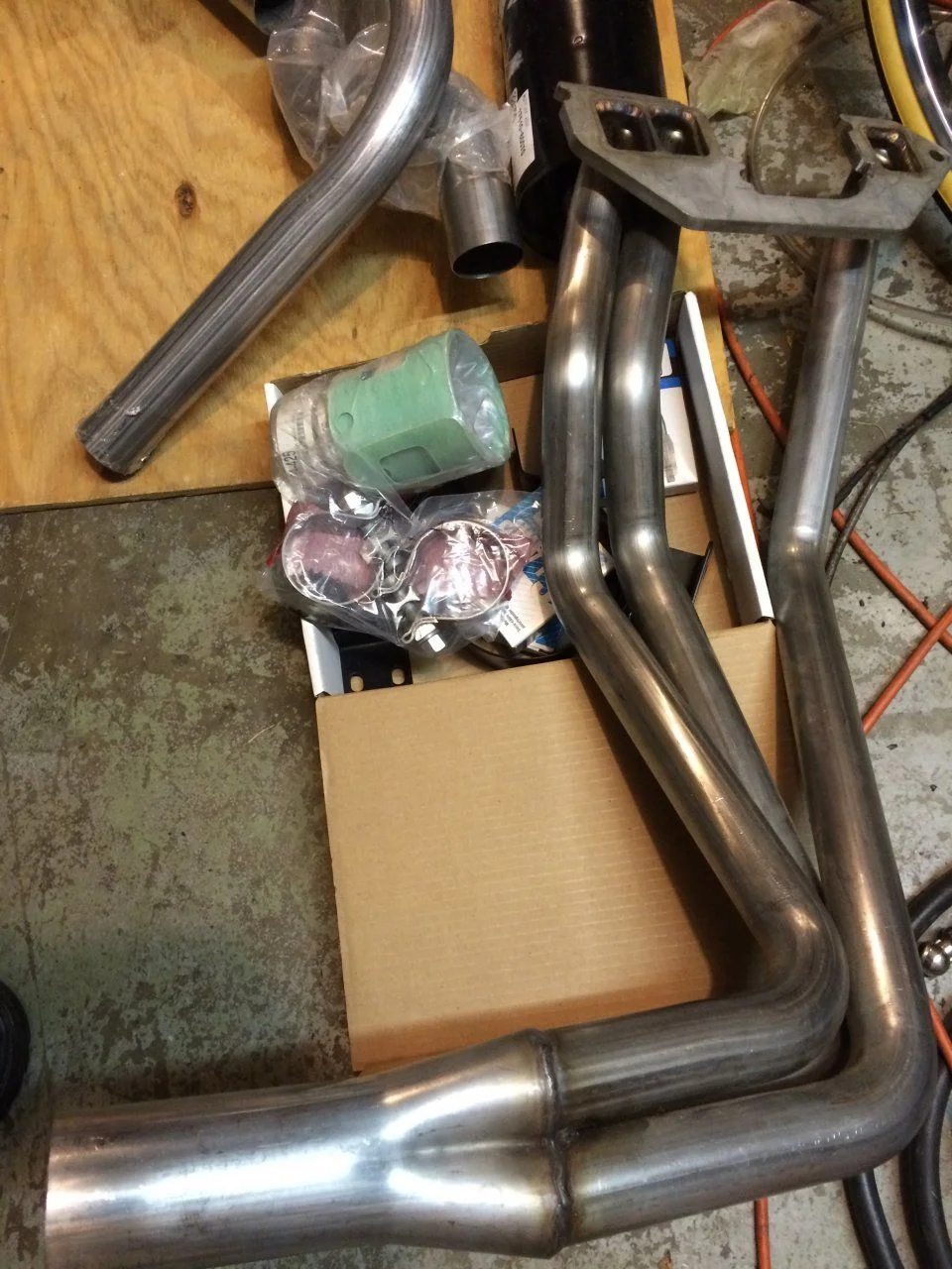

Soooo began a search for a complete exhaust ... Found a new unused SS sor header and complete system picked it up from @TheYoungOne in Reno,Nevada
Just opened it up today ... Waiting on a few things from @beno (your good :) ) going to get the whole thing ceramic coated... Found a guy 1.5 hrs away to coat it :meh:

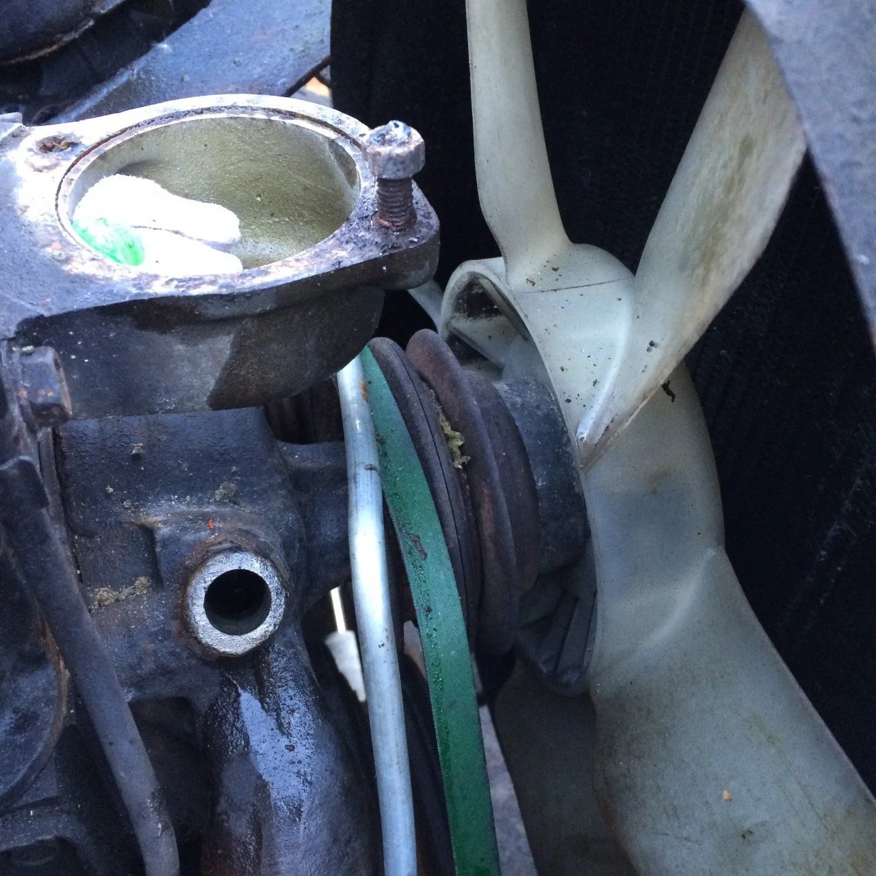

Well they are ceramic coated ... See pics... And was replacing the radiator hoses at the same time... Thermostat and such when broke a bolt... Tried heat and vise grips and also PB blaster... No go
Luckily I had brought my welder home from work... Welded a nut to the end... Finally backed out the bolt... Hew :)

Personally , I would have went the route of having it Jet-Hot coated after what my ceramic did over time . But then again , this was a tri-y on a Sami 4 banger that ran some pretty high egt's when used hard . It's sure been hard getting used to a sub-4k rpm limit on the inline 6 tractor engine , I'm more used to hearing shift points north of 8500....lol .
