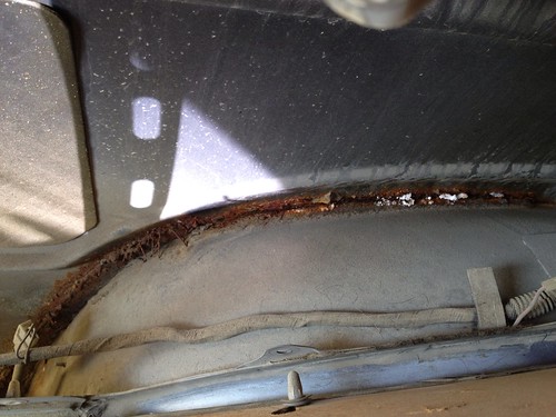

So this summer I have a few things on the agenda for BeBe.
1. Knuckle rebuild on both sides
2. Fix rust and weld in new steel where needed
3. Paint BeBe with Monstaliner (this has been hotly debated but decided I am gonna do it as she will never be a garage queen nor a show car and I want something durable)
So what I am looking for form the club is help on #2 mainly.... I have a friend with a welder and he has offered but is working a new job and is pretty unreliable at the moment. However, I am hoping to salvage the wheel wells without cutting out any metal but need to see if someone has a media blaster that I can come and borrow to clean out the inside of the wheel wells and possibly help with the replacement of necessary metal.
I had originally planned on doing this myself but monetarily it is not going to happen with purchasing a welder plus learning how to weld.
This is what the inside of both wheel wells pretty much look like. The white is just crap in there and not daylight. Actually pushing on the metal it still seems pretty firm (which is why I hope I can salvage it). Once done I plan to paint the interior of the wheel wells with Monstaliner's Chassis Saver or a like product.

I'm down to help where I can. That's a nasty spot for sheet metal replacement for the rust.

BTW... You'd still be money ahead getting a welder and learning to weld. The mig set ups makes welding so easy and you can learn it from now to when you want to do some meaningful welding.
I borrowed a friends 110v lincolin procured some scrap and started practicing for about and hour a night for a few mos. then started my SOA!!
You have pretty much no limits on what you can do when you can weld.
