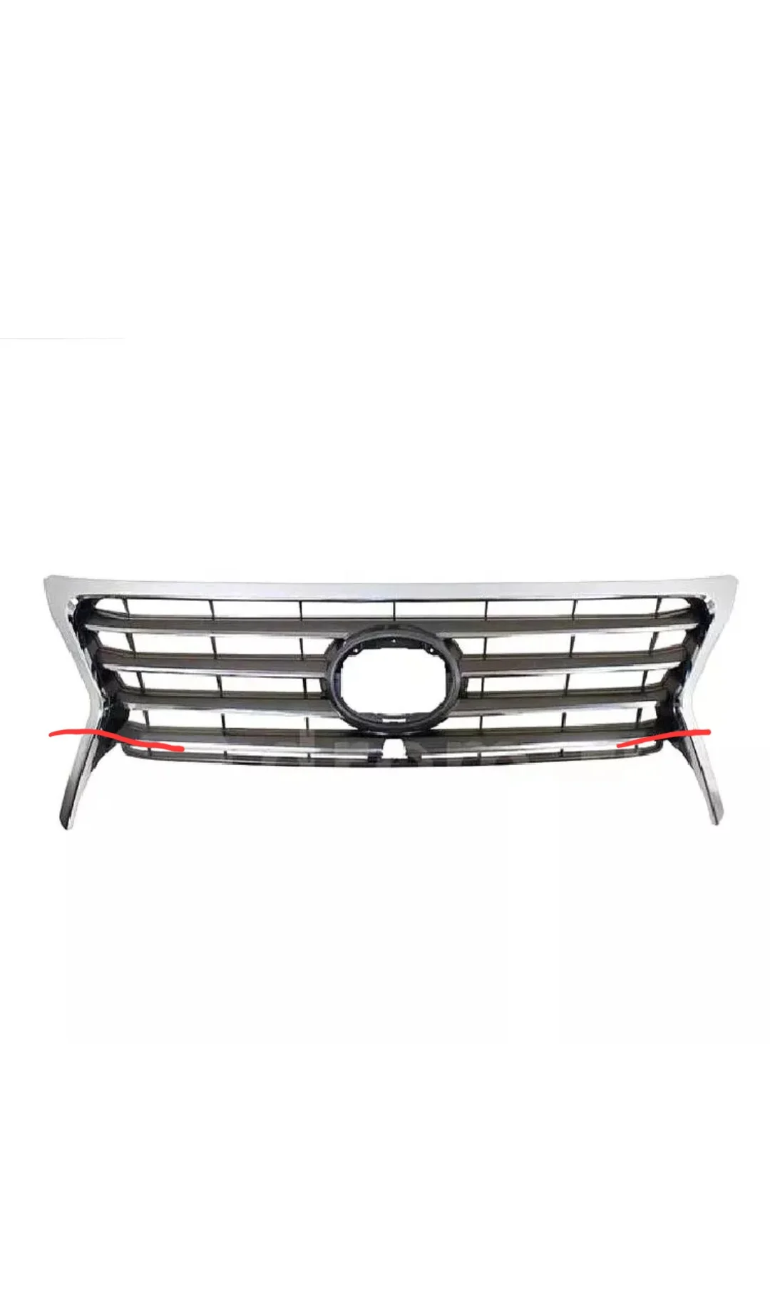

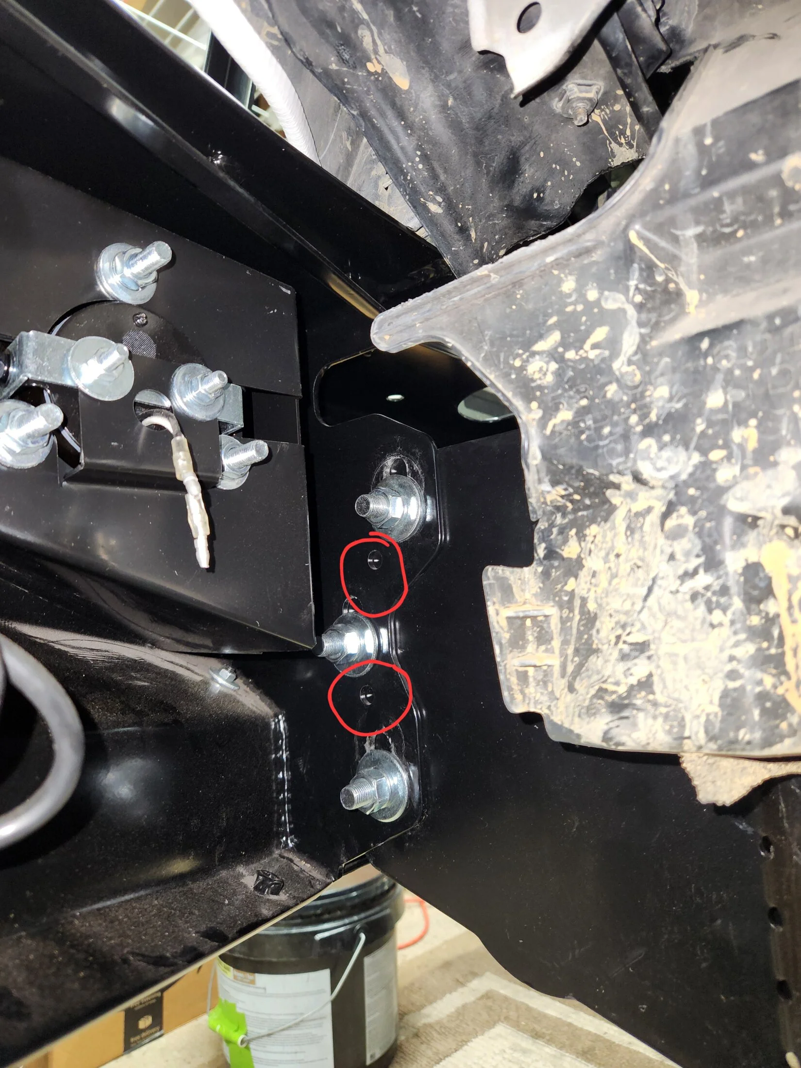

Did you have to trim the lowest bit of the grille (rung directly below where the camera installed)? How about the fascia connector (pictured)?
I'm trying to mount as high and tight as possible and the bumper is impacting this area. The only paths forward are to lower the bumper OR cut the pictured fascia connector and the lowest "rung" of the grille. However, I am concerned about the long term durability of this setup due to the limited remaining mount points.

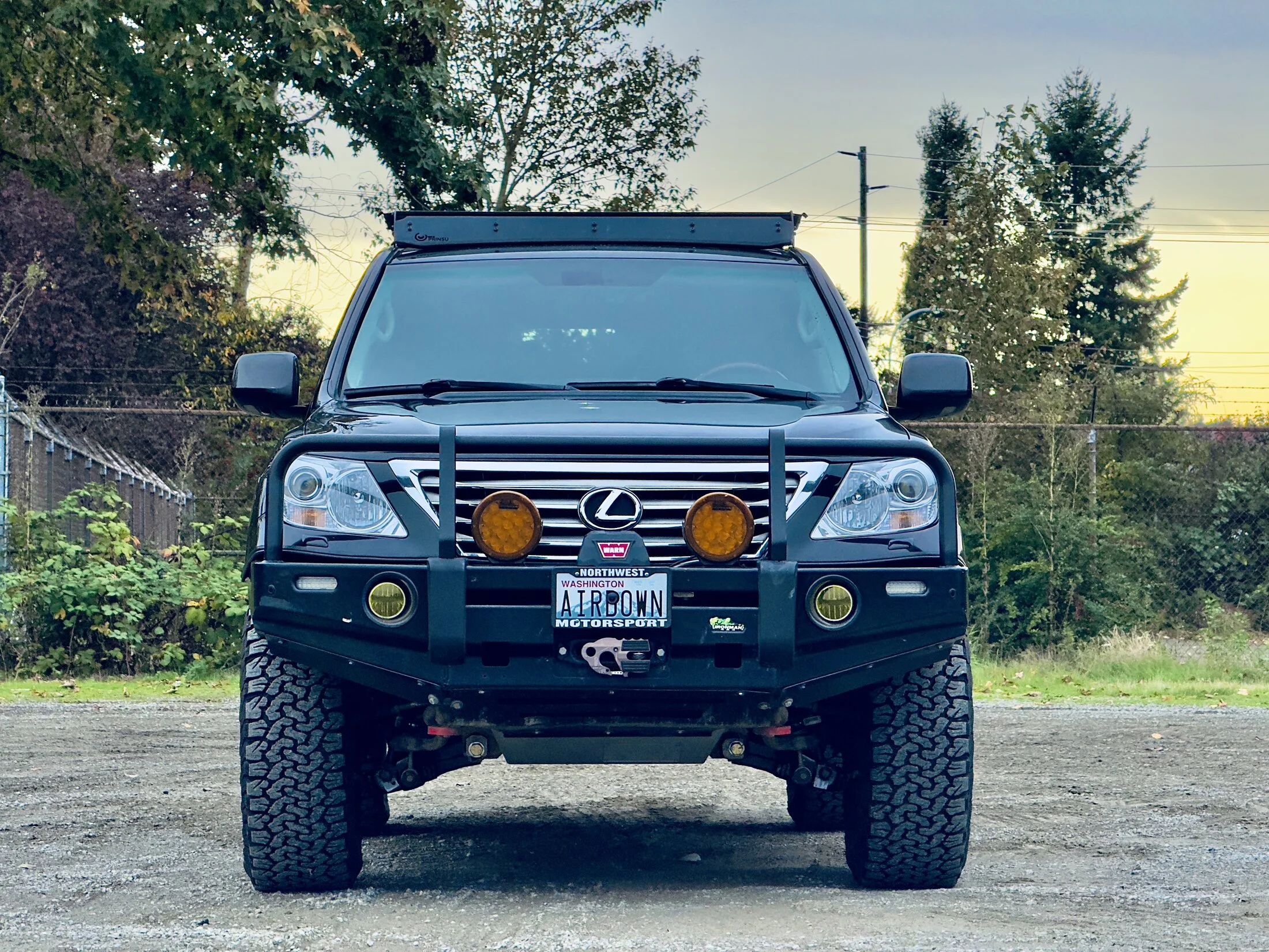

Mine is an 08 and I jammed that sucker up as high is it would go. I also cut the middle out of the metal grill support so it wouldn’t block access to my winch clutch under the pass through. It looks like you are in the ballpark.
👋 hey

Yes I cut bottom rung of grill

Mine does not make contact but that’s because 08 grill is slightly narrower. I’ve seen 2012-2015 installs and you may have to trim the “spindle” part of the grill a bit.

I followed your thread and cut the metal support bracket between the headlights. The white connector shown above rests on the non-body colored metal support bracket that we both cut out. Sounds like you may not have had a plastic connector between the fascia pieces like my model year.

One more question. How did you manage to drill the pinning holes? There's no room to get a drill in which makes me think I need to pull the entire bumper cover off again and HOPE my paint marks for the pinning hole location stick. I'd much rather match drill.
To be honest it’s been a while but I believe I pulled the bumper off and drilled the pinning holes.

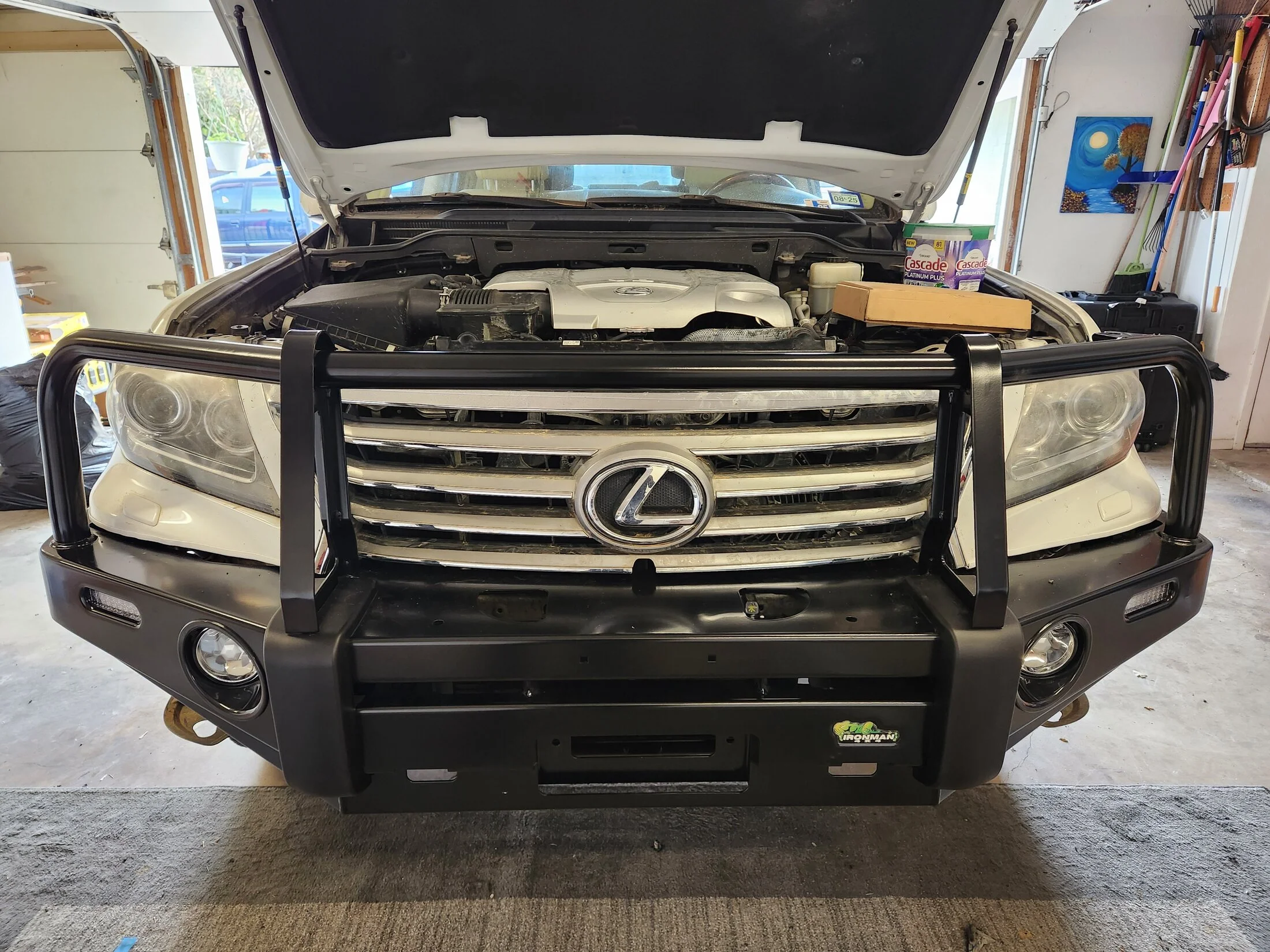

Definitely happy with the quality of my install. It took a lot of time and thought. The ironman directions really are useless and I have some reservations about the design choices of the bumper such as too many fasteners for under plates, poor integration with factory skid, and general missed opportunities to improve front ground clearance (aka empty space behind the bash plate and outward extension of the bumper). Mine was also missing a few of the pieces that were supposed to be in the hardware kit and has a fair amount of left over hardware... which is slightly concerning. If Dobinsons had bumpers in stock when I ordered this I would have paid more and gone for them.
All that being said, I like the look, the price, and it's an improvement over stock. Also the seperate winch mount and bumper cover is absolutely awesome. More companies should design it this way.
Definitely happy with the quality of my install. It took a lot of time and thought. The ironman directions really are useless and I have some reservations about the design choices of the bumper such as too many fasteners for under plates, poor integration with factory skid, and general missed opportunities to improve front ground clearance (aka empty space underneath bash plate and bumper). Mine was also missing a few of the pieces that were supposed to be in the hardware kit and has a fair amount of left over hardware... which is slightly concerning. If Dobinsons had bumpers in stock when I ordered this I would have paid more and gone for them.
All that being said, I like the look and it's an improvement over stock. Also the seperate winch mount and bumper cover is absolutely awesome. More companies should design it this way.
