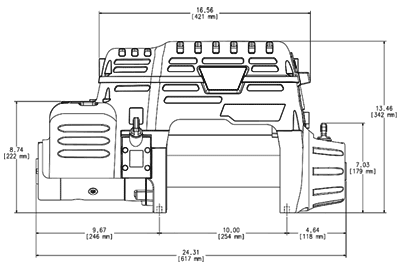

power plant picture
here what the power plant looks like...
I do not see why that wouldn't mount in an ARB. That looks like that same size as mine except the top of it which I do not have. I would think it may block the air flow somewhat but maybe far enough in front of the grill it may not matter. If you can find a dimensional drawing that I can use I can do some measurements on my exisiting one and let you know what I find.
Here you go..

It is the top that will hinder install...Apparently people have made them fit, but I guarantee you that the ARB will have to be cut to make it fit unless you space the winch back far enough from the ARB to clear where the ARB bumper bends back and where the "lips" are that a non-integrated solenoid winch tucks under. I think the really problematic side will be the left side of the winch (as you are looking at it).

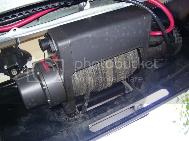

I found this pic with a quick search to help out anyone researching this, I don't personally like the way it's being backspaced, but at least this shows it will fit. Not my pic, apology in advance for using without asking.
