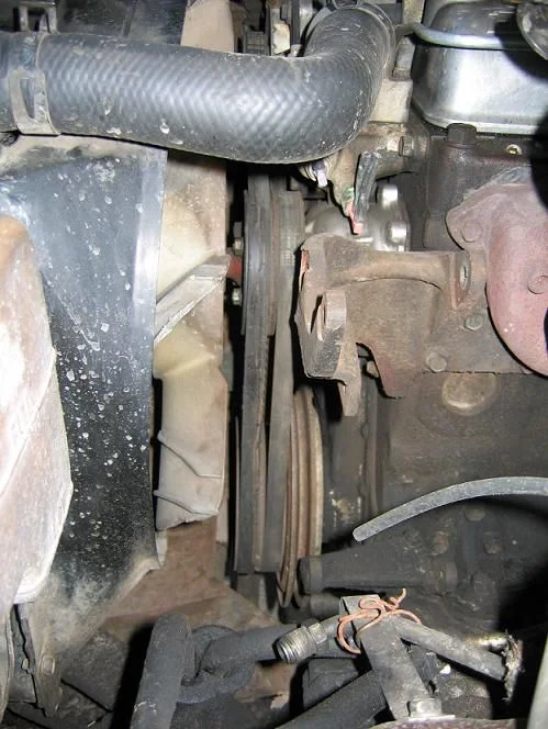

okay... here is one of my "custom" fixes.. I did this for a temp fix and the belt never broke, and i ran it like this for three years.
no smog pump, no a/c, and no power steering
