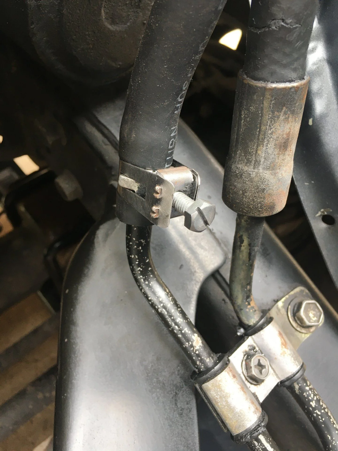

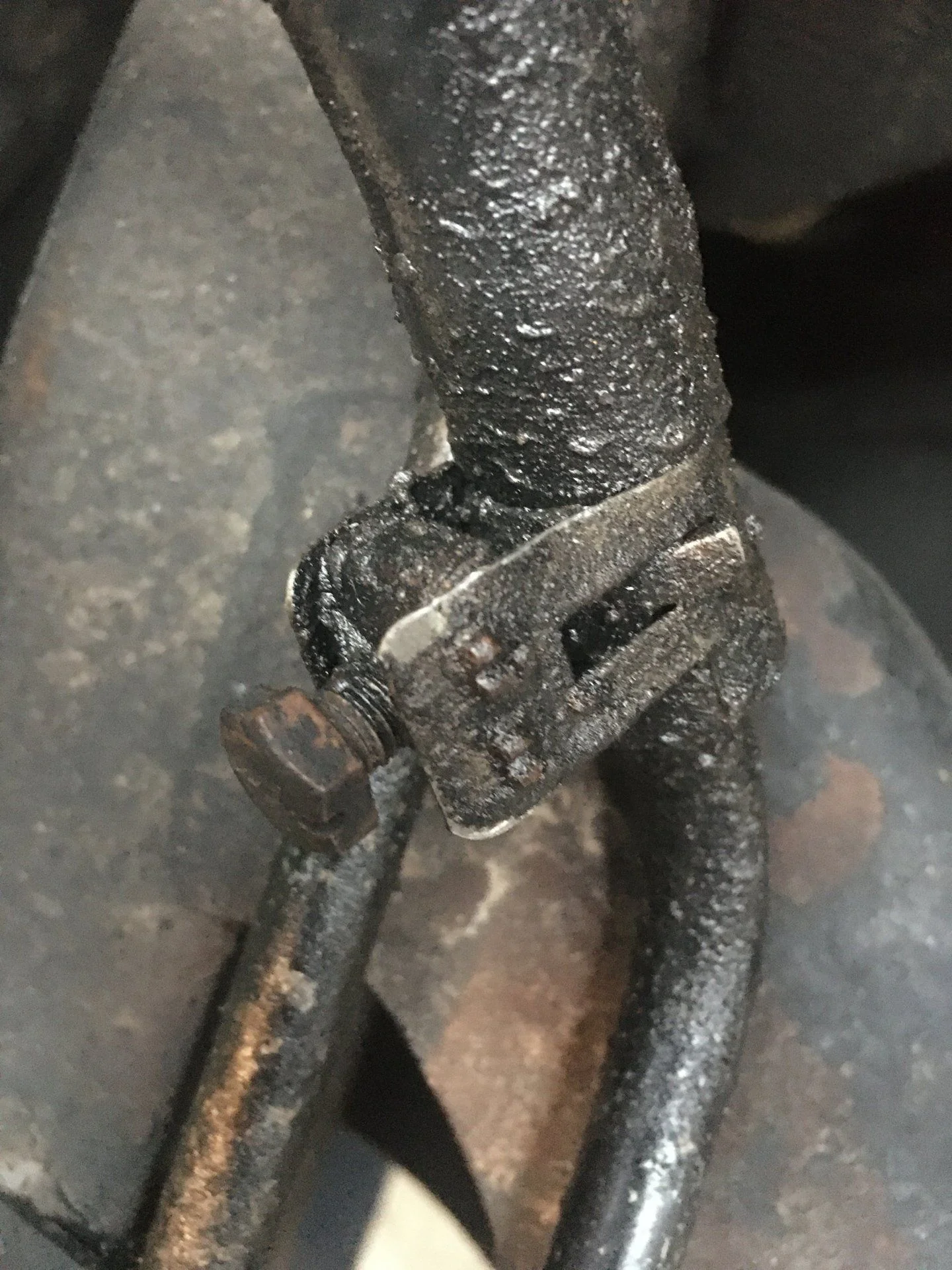

And....are the OEM tower type clamps (pics below) on the PS line some sort of magical type of clamp?? Don’t recall seeing them anywhere other than the PS line.
Just curious if these are specifically suited to seal PS fluid better, or any hose clamp works fine, these should clean up well but one of mine is likely trashed.
You can use 3/8 atf rated hose and fuel injection style clamps. You might find the old clamps are oil soaked enough that they come off and can be reused.
I used some leftover -6AN hose (3/8" ID) and a couple spring clamps. The 3/8 is a pretty tight fit since the metal nipples are a metric size, but it fit and works well. Had to warm up the hose ends so they'd slip over the nipples easier.
Good to know, still wonder why Toyota used these unique clamps here. (?)
No big deal, just curious. These look well preserved in their natural protectant, will probably have to swap out the one by the pump reservoir.

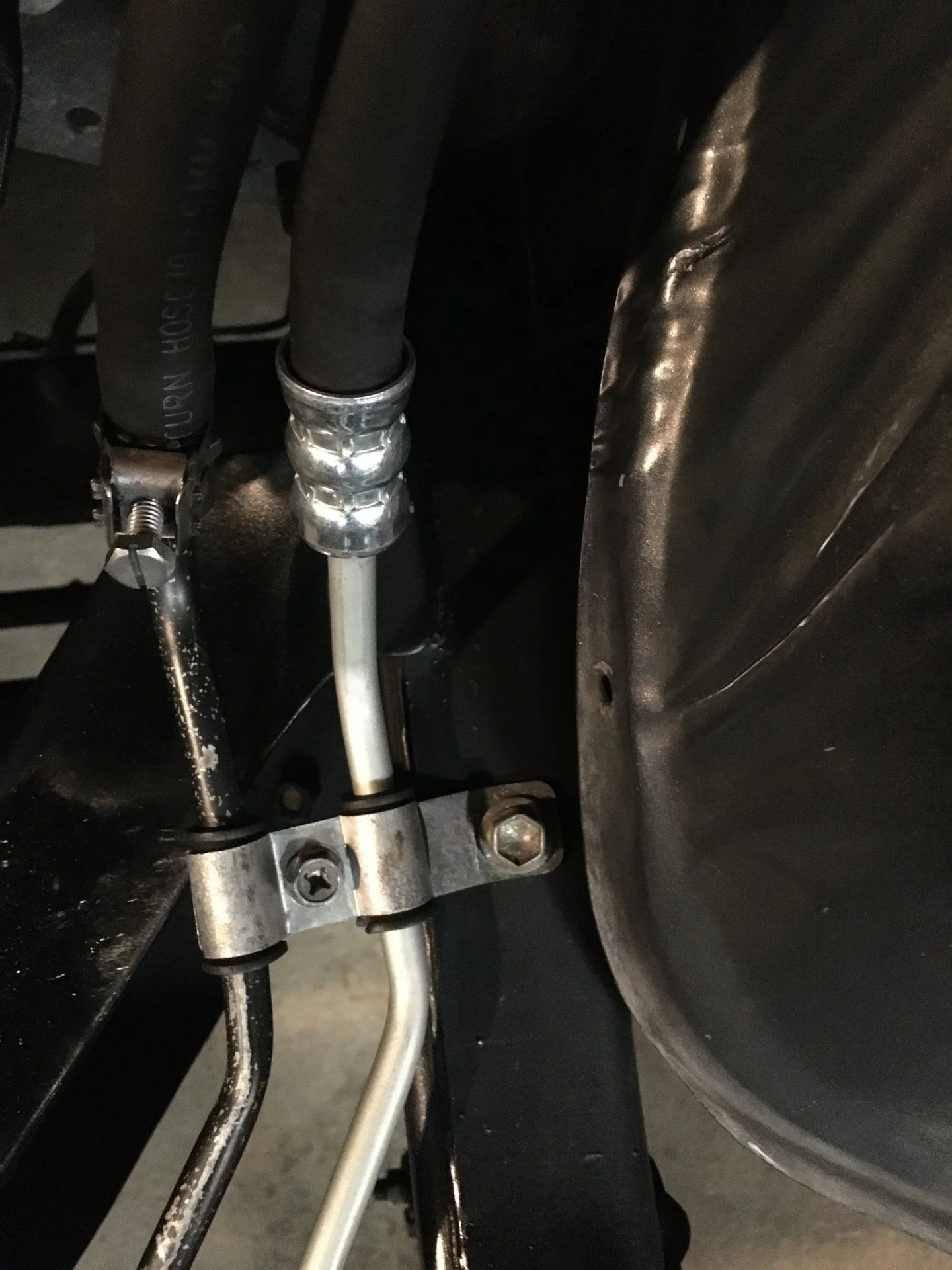

Small job, but got these PS return hoses replaced yesterday.

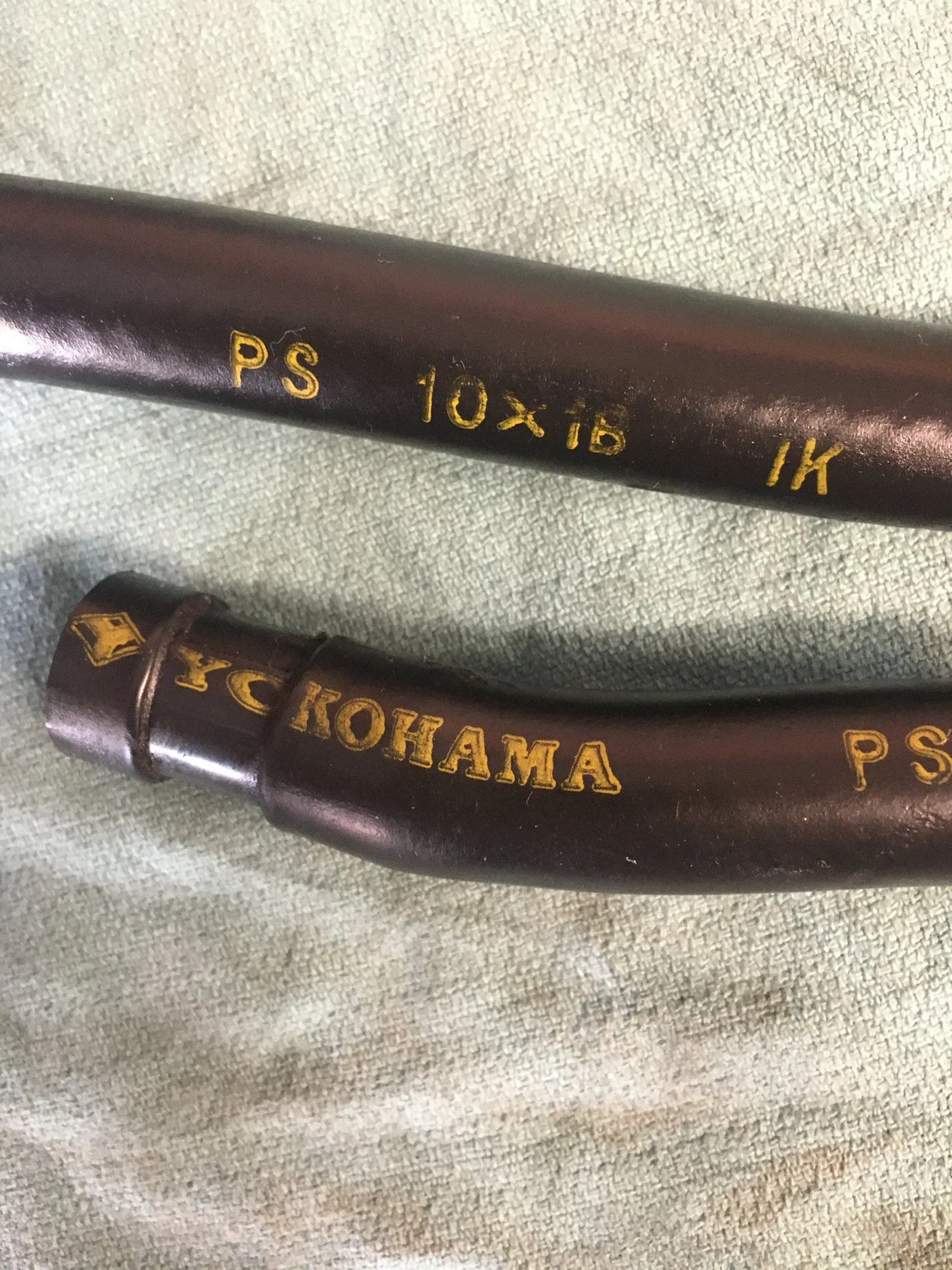

I used some off the shelf 3/8” ID from the LPS. Holy hell that is a tight fit!...even with using some silicone grease on the new hose and hard lines. 3/8 is 9.5mm equivalent, OEM ID is 10mm (pic below of original) I even have complete access to the front of the engine bay right now, that would’ve been a b*tch otherwise.
The original clamps cleaned up super nice, had to ‘rebuild’ one, they were well covered in preservant for a long time.
Orig. return line w sizing:

The old hoses were pretty brittle, hopefully this cleans up some of the PS sludge that seems to get everywhere.

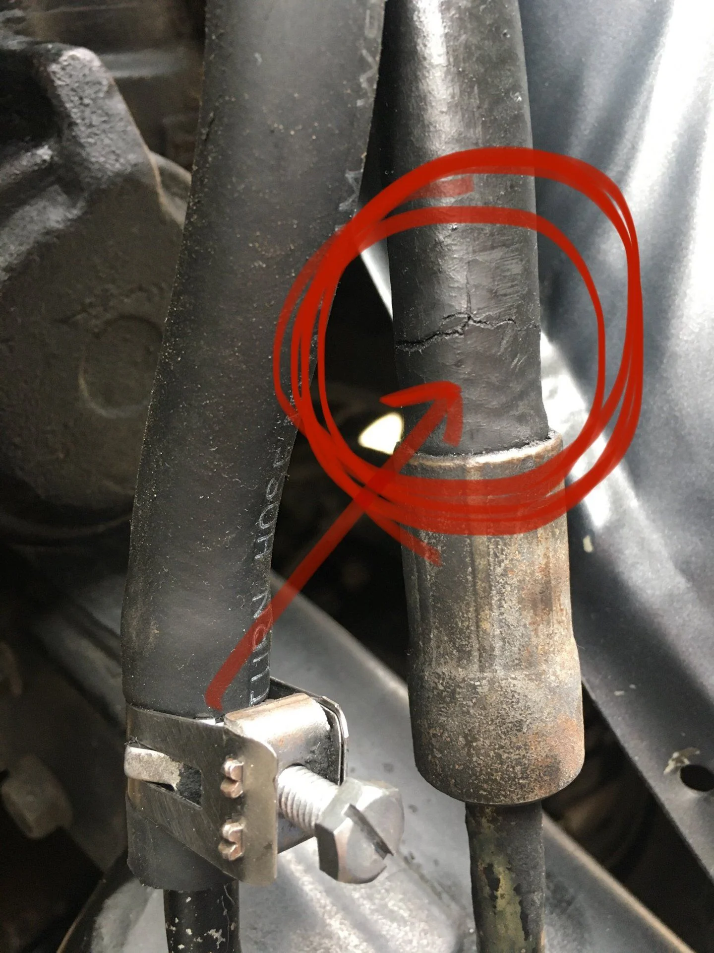

Just noticed this (pic below) while posting that last photo, did NOT see this while working in there.
Looks like this has to be done while I’m here.
I’ve seen a couple aftermarket high pressure lines available...is one better than the other??

Pictures say a 1000 words...think it was about time to replace the high pressure line. It was really brittle and crumbling badly, the underlying hose reinforcement felt solid...but still. Having the whole front core support out made this super easy, shame on Toyota for this PS line routing.
Original hose near the steering box:
Passenger side junction (hiding under the protective sleeve):

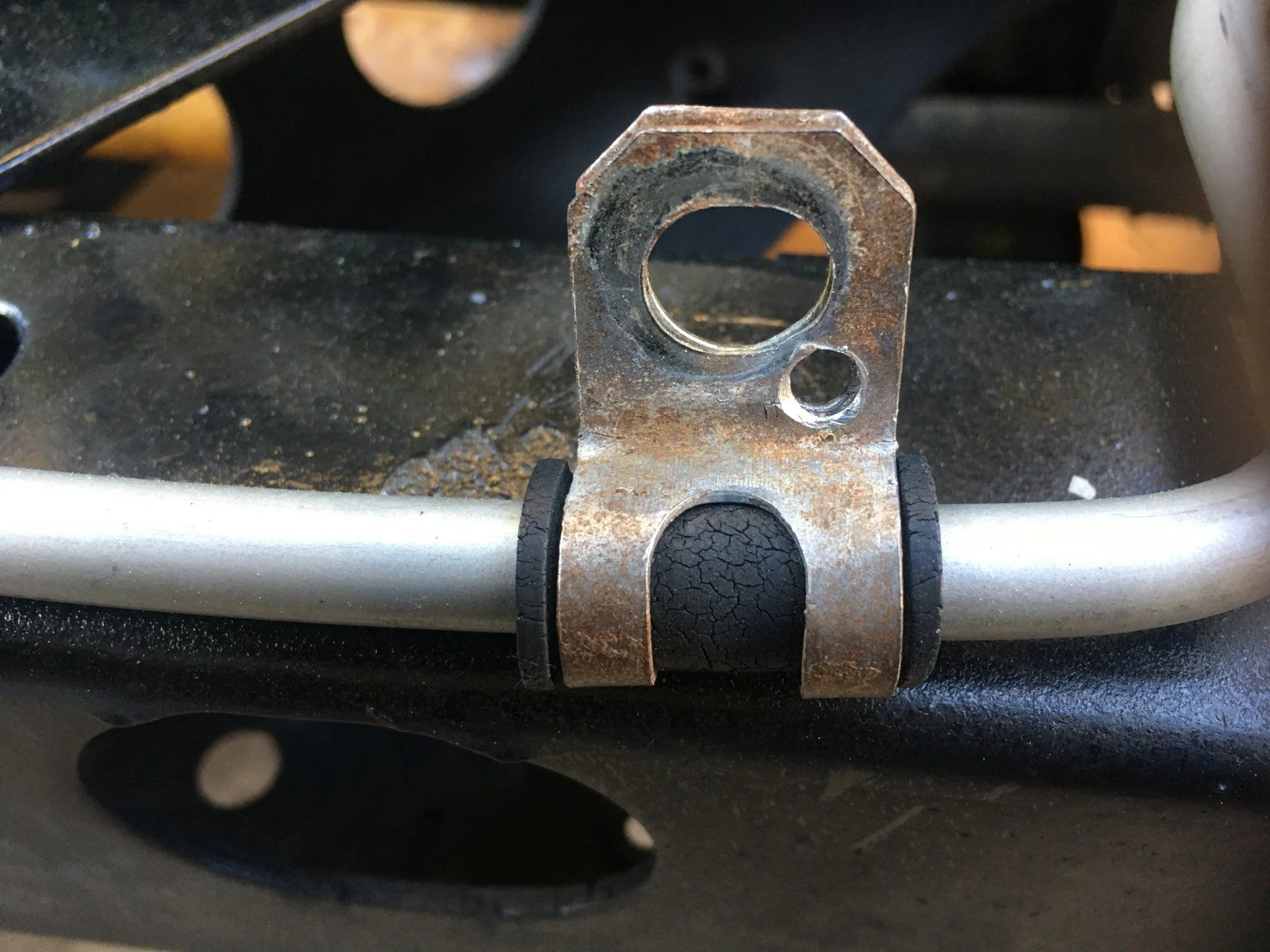

The new Gates HP line (Rockauto) comes with some cheapo looking mount hardware. The OEM clamps are very nice but the two front clamps along the crossmember are permanently spot welded to the orig. hard line.
A 3/16 drill made quick work of the spot welds and remounted the orig. clamps on the new line.

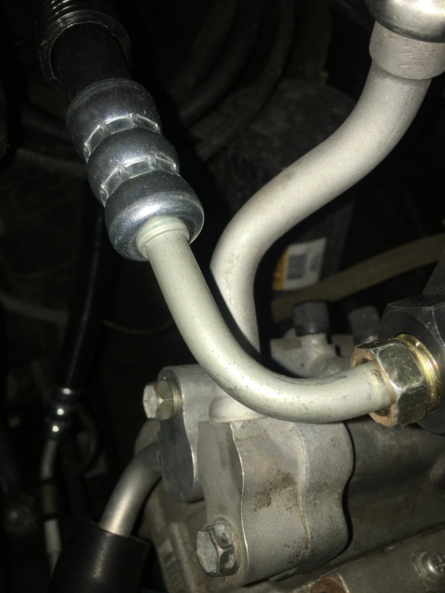

PS Pumps:
I replaced my original fj62 pump with a cityracer pump awhile back, the orig seemed leaky and tired and the cityracer was an immediate plug n play option.
I probably could’ve done a more thorough flush/bleed at the time, but figured the system would completely bleed itself naturally too.
Either way, the replacement pump has never “felt right”. Choppy, groaning, works ok but then stutters sometimes, also noticed evidence of some leakage while replacing these lines. Maybe the old lines were leaking near the pump, hard to tell.
