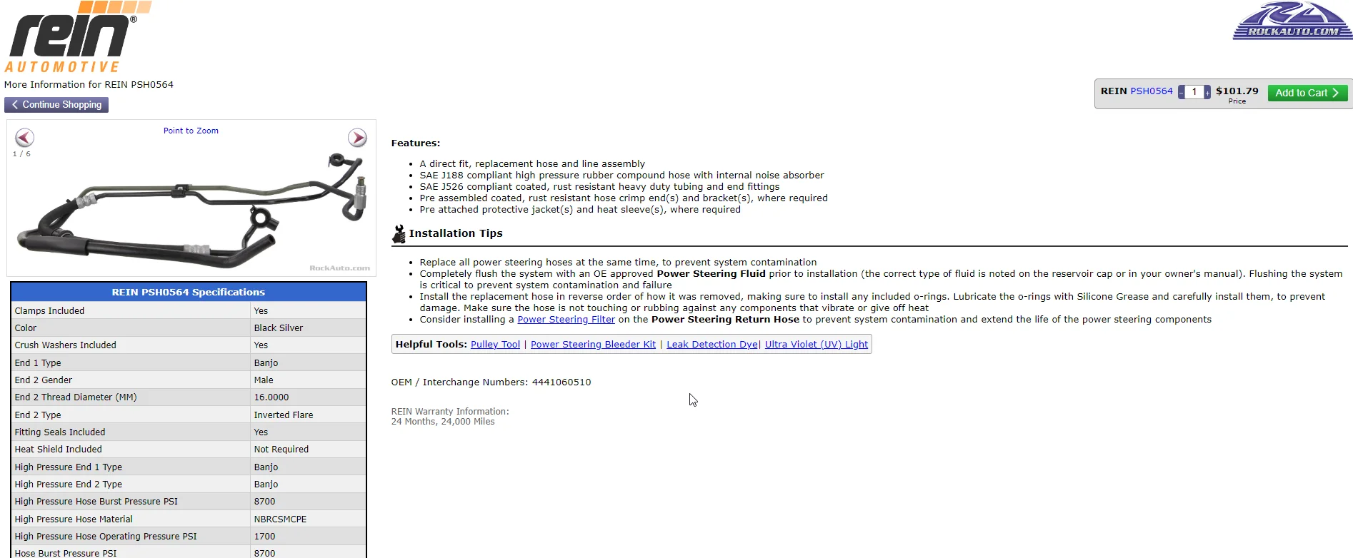

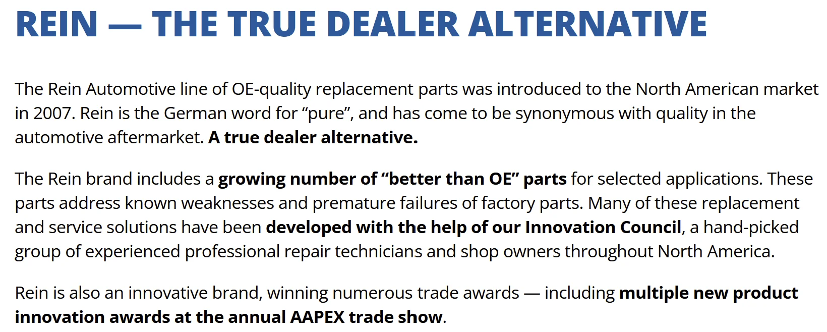

The Rein appears to be the OEM supplied hose. I put one on my son's 2000 LX470; I can't tell the difference between the Rein and the one we took off. It wouldn't be worth saving $25 to me.

I'm not sure where you're seeing this is the OEM supplier. Not saying there is anything wrong with it, but its not OEM.
I didn't say it was advertised that way. I said I couldn't tell the difference between the parts.
