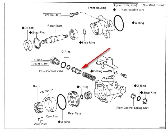

Did you check the functionality of the flow control valve.
When this valve gets stuck in the bore you will have the issues you are experiencing.
HI Sved, where is this located as I'm Googling and my truck doesn't seem to have this?

Sorry for my lack of knowledge... but when I Google Flow Control Valve for the 2H Power Steering I get this... EBAY PART But in the video 1.45mins this is completely different and is a sprung valve built into the pump itself.
Both are flow valves for the Power Steering?
The valve can be stuck in the bore or the spring is to weak/ worn out .
HI Sved, thanks for your help. I'm trying to source a new Flow Control Valve and Compression Spring but there seem to be 6 options for the Valve... see here https://www.amayama.com/en/catalogs...ssis-2/vane-pump-reservoir-power-steering-130 4433060010 through to 4433060060 and my local Toyota dealer says the same. Any idea how to identify the one I need?
Separately the Compression Spring 9050112447 is no longer available (I will check my specs against your diagram to check I need one first) but on another post someone says that 9050112103 can be used instead... again sorry, but do you know if this is true? I have a history or ordering the wrong parts :)
The valve and the housing are matched with a mark A to F
Spring should be ok to reuse.

After some swearing and some bruised knuckles (on the hottest day of the year :) ) I have the valve out. BUT to my dismay it has a B and a C in the casting. See the image for these. Do you know which it is? The B is next to the where the valve came out.
and
Which marking does the valve have ?
Was the valve stuck or loose in the bore ?
If I remember correctly there should be a mark on the machined side of the pump. You first picture on the left side ,which can not be seen in that picture.
I understand you took the valve out from the bottom.
If you mount it back and take of the top hose then you can test the valve by slowly pushing it down into the bore .it should return easily without binding. If it binds you can give it a twist with a screwdriver and see if it loosens.
