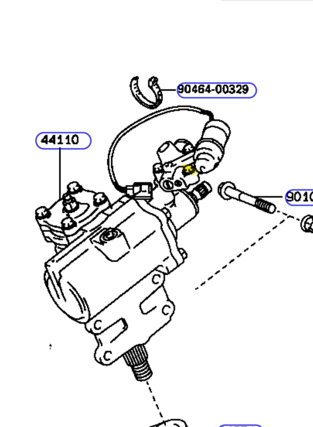

Has anyone ever seen a leak from this bolt? (See attached photo) I’ve identified that this as the source of my power steering fluid leak.
Thank you. Glad it’s an O-ring fix and not something more expensive. Is there anything else I’ll need to replace once I pull those bolts?They have o-rings under them.
96711-19014
