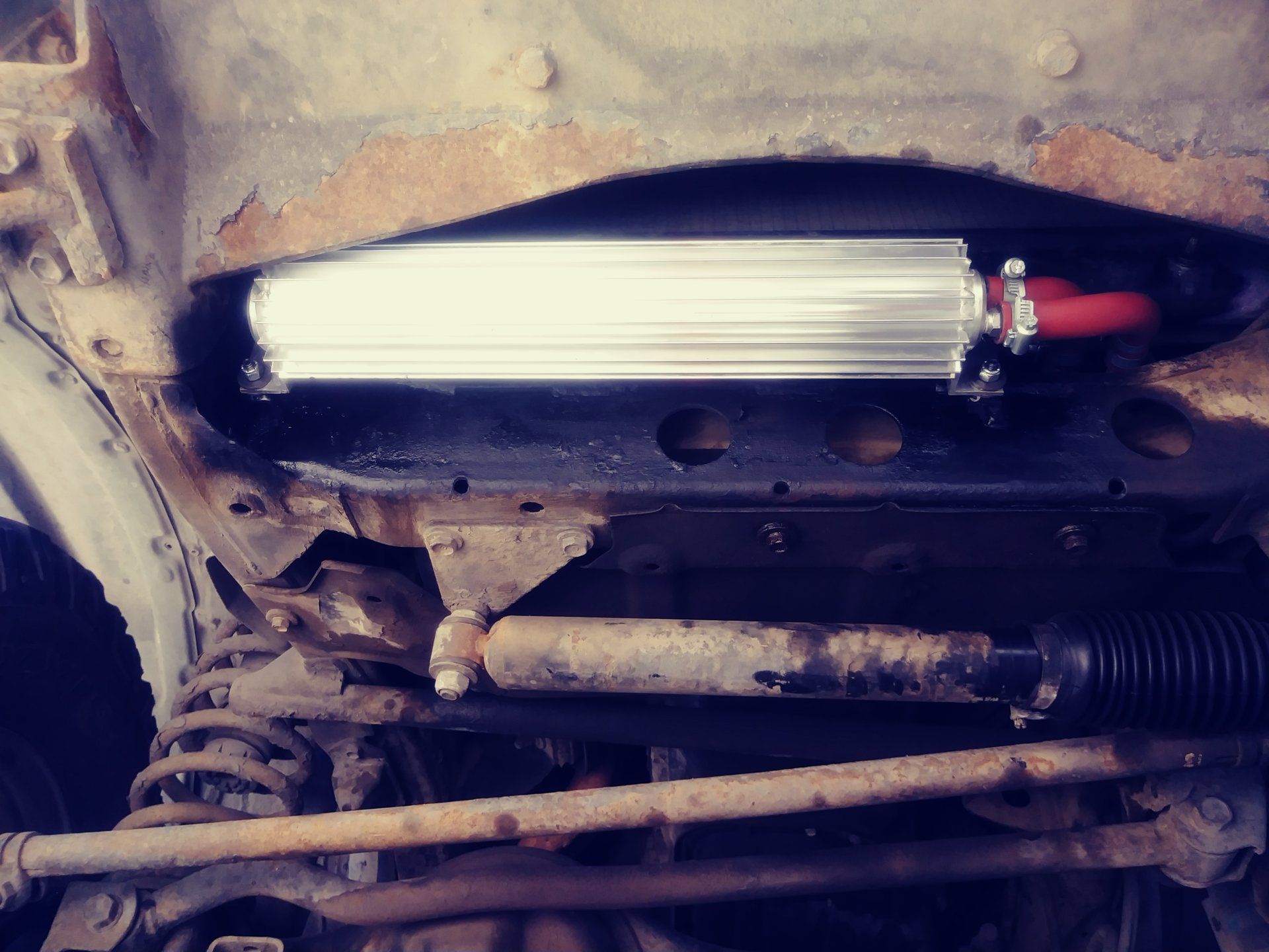

Now I just replaced the "paper clip" cooler (that got crushed on a rock) on the steering system with an aluminum cooler and refilled the system with the rest of the ATF I had left over. The pump groaned and the fluid foamed like a milkshake. I cant seem to get the air out. I now have a mix of ATF and PS fluid in there.

I assume the fluids are miscible so likely you just have air up in there. Run it, let it settle, run it, etc.
you can mix atf and ps fluid, they are compatible together. youll want to turn the wheel lock to lock to help bleed out the air, let it sit and run again
