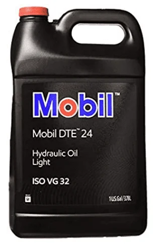

I also flushed all the old dirty oil out and used some Mobil DTE 24 ISO VG 32 oil I had left over from a dump trailer project I built a few years ago. It claimed to be a light hydraulic oil and I decided to try it.
After I got all the air out of the system by running the steering wheel from lock-to-lock 20 times, I found the steering was as good as ever but there is a small amount of whine coming from the pump. Not much but now that I am fixated on it, I hear it.
I wonder if this is coming from the gear on the pump not meshing will the gear inside the engine although I pounded it on there pretty good and it looked correctly seated; or possibly the ISO oil not being exactly the right viscosity for the system.

We’ve put DTE 24 in several trucks and never had an issue with noise. A problem with the gear would typically cause chatter (especially if the gear teeth are marred), but groaning is typically cavitation, brought on by air getting into the system. On mine it was the o ring for the input barb on the pump.
Air in the system could be an issue. If I am getting air in as the pump runs, would I see bubbles in the fluid in the reservoir when I turn off the engine or would the air be trapped somewhere else in the system?
