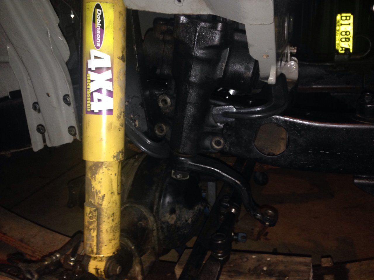

Hi
I am doing a 60 series power steering conversion on my bj40.
I have an Australian 60 series box and want to run a kit through it but don't know what year 60 it's out of.
I think they changed around 1984...
How can I tell if I have a pre or post 84 model box?
Looks like an early, but not sure? On the early, the 4 mount bolt holes are a rectangle, on the later the uppers are slightly offset from the lowers, so a parallelogram.
