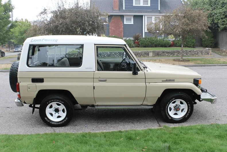

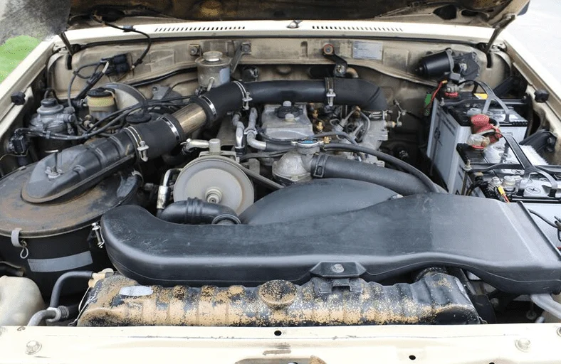

This BJ73 is local, that's a big selling point. Also with it being a 1985, it's an older one and has that classic all brown look inside. But looks to be some rust on the rear quarters. Understanding the 3B, a turbo would be first on the list after shoring up the routine maintenance and confirming it's turbo ready.
Will be checking it out in person in a few hours, so more to come. Initial thoughts? What are some specifics to look for with the 3B?

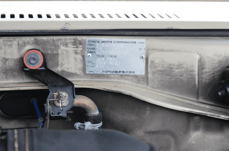

This one has been for sale for a while. The seller has it listed as a BJ70, which as you pointed out its actually a BJ73 (a JDM one at that, with the RHD)

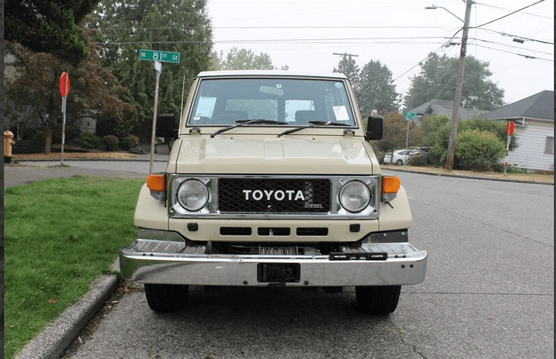

I think at $23k they are asking a little too high. There appears to be decent surface rust on the frame from the photos. I would be curious to check out the whole underside and see what condition its in. There are also rust spots showing on the paint which means there is rust underneath. They are notorious for rust/rot in the windshield frame. Interior is in good shape so that is nice.
Since you are local, I would see if they will allow for a 3rd party inspection. Torfab up in Everett is the local go-to Land Cruiser shop. They are busy I believe, but should be able to do a pre-buy inspection. I would have them check the compression on the 3b and just a general once over for issues.

It looks pretty crusty and I personally wouldn't be a buyer at half of that price, unless the interior was 100% complete and perfect.
Having gone head to toe through a BJ73, I can tell you the 3B is definitely getting really hard to get parts for and some of them are down right non-existent. To add a turbo you'll want to take the head off and check things out. Pre-cups are almost certainly going to be cracked and need to be replaced, but if the head is cracked you'll end up in a spiral. The large valve heads are unobtanium unless you want to roll the dice with Chinesium (and still may end up with the wrong head and poor castings).

Clearly issues with rust underneath an aftermarket paint job is a big red flag for me.
Surface rust on frame isn't terrible, but will need to be dealt with.
Skid plate has significant rust makes the rest of the underbody suspect.
Looks like it is missing rear headrests and roll bar/seatbelts for rear seat.

Oh boy was it a mess. Positive is that I got to check out the dims and feel of a 73, really like it. The FRP is sweet, but not too sure if it would be a proper match with the Pacific northwest. Better maintained, perhaps.
This one in particular, I agree with most who chimed in, was worth half the asking price at best. Rust throughout, couldn’t get it to start, puddles on the floorboard, you name it.
