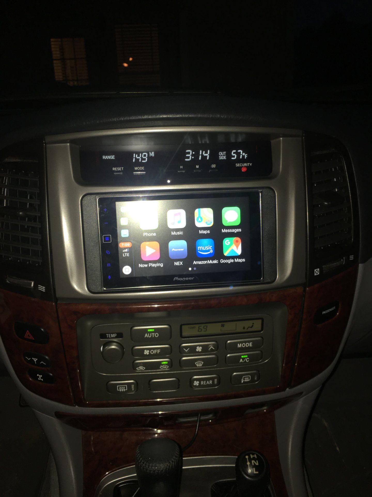

KershZ71, what adapter did you use to fit that stereo into the Toyota 200mm faceplate?
I ordered this and it came with 2 different inserts.
