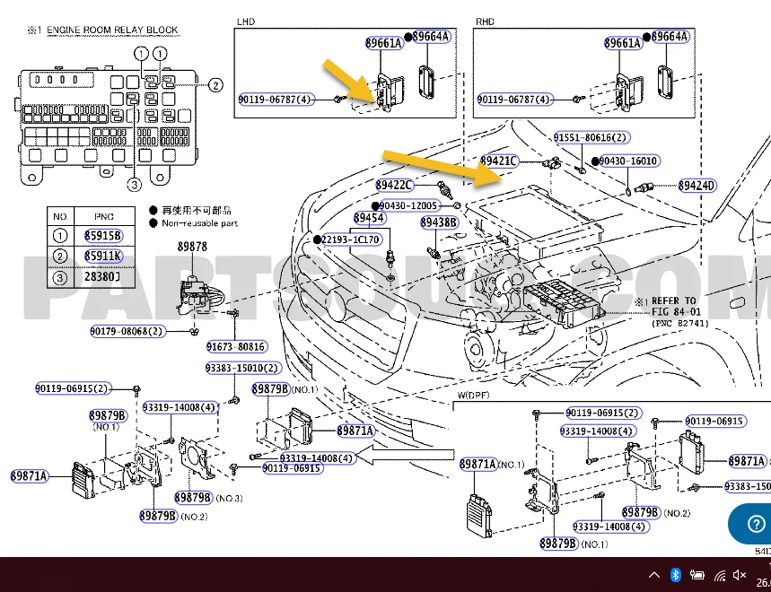

There is 2 connectors to the ECM. the one in the bottom is the smallest. it was the loose one. its connector locking clips were damaged. i do not know how that happened, because i bought the car used. some mechanic probably had do disconnect it and damaged the clip. don't know.
this picture illustrates where on the car this connector is
Is that a ECM? If I am looking at the right part, I believe that is just a firewall bulkhead passthrough connector.
From memory on our 200s the ECM/ECU/TCU (part no 89661 in the diagram) is attached to the firewall inside the cabin and the harness clips directly into it through a sealed bulkhead.
Yes that part in the diagram 89661A is the ECM. I just replaced one. I got a used ECM pre-programmed with the VIN off eBay then took it to a key shop for them to program the keys/FOBS. Drove it with the old one to the key shop then swap it out at the key shop. Took like 10 minutes. The VIN is programmed in to the ECM.
The ECM goes through the gasket (89664A) the bolts to he firewall. Then the harness clips to the ECM. Sounds like the hook on the ECM has broken off on his.
