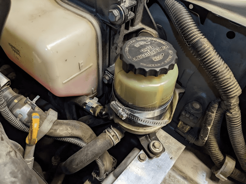

I bought a Thors Lightning compressor on sale at Prime days and was brain storming on if I could mount it in the emgine compartment. Measuring the power steering reservoir area, and thinking if I move it off to the side, there might be enough room.
So I went down a rabbit hole and moved the reservoir off to the side to see if it would fit. I had to take off one of the hoses on the reservoir to get it on the other side of another hose to allow it to be moved.
Before:
After:
I then checked to see if the compressor fit. It looks like it will....barely. I will have to make a custom bracket to lift the compressor up so it sits above the bracket mounting the airbox it will fit.
What do you guys think? Do you foresee any problems with this? I plan to shield the hoses touching each other with rubber shielding just in case and those screws mounting the reservoir are temporary and will be changed out.

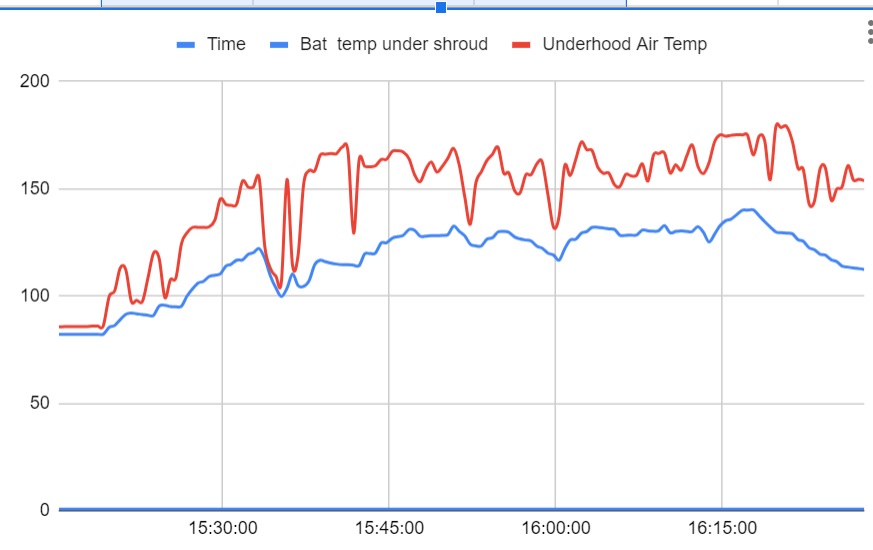

I would caution that area for that compressor. It does see some heat and environmental factors. Enough that it will probably cause an early failure, or failure right when you need it. Low speed off-road crawling really spikes the heat underhood.
I'll say I have my compressors there too, but they are commercial grade IP rated.
Here's a couple threads with more context and temp data.

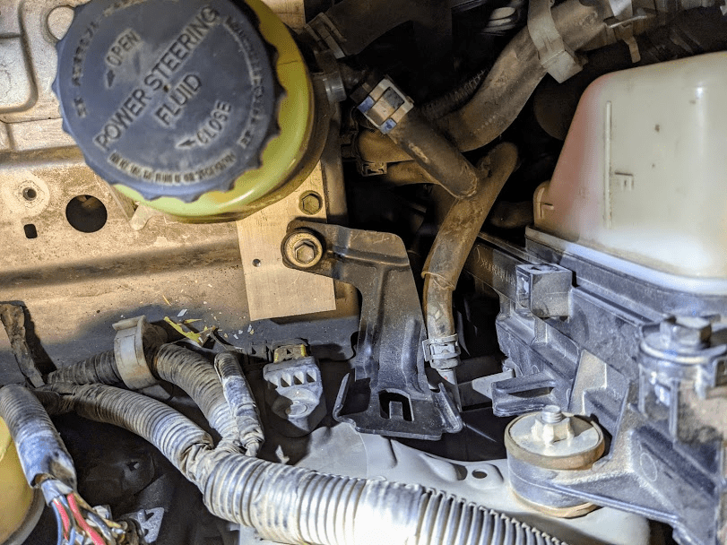

Having done a power steering relocation mod recently for a yet to be completed twinz project, thought this would be useful for others on how to create a simple and effective relocation bracket. I know others have needed to relocate the PS for other reasons, including fitting dual batts.
Here's the relocation position. This is probably as simple as it gets, as there's no need for any re-plumbing or cracking open the PS circuit for that matter. Plumbing elbows and clearance fits like a glove in this position while also maintaining rubber isolation. Using an unused mounting ear off the radiator.
Remove PS tripod bracket from fender and PS resevoir.
Two major fab steps. One inner fender modification.
1) Modify bracket by cutting it in half, preserving this half of the bracket with one foot and the reservoir holder upright
2) Create a band clamp with a mounting ear and hole large enough for an M8 bolt. I used a 4" band clamp I had around in the garage, but it was longer than I needed so possibly a 3" one could work? Best with a 4" as it's easy enough to cut off excess. Bend and fold a mounting ear into the band. Though want to mock and bend once so as not to fatigue break the strap. It should fold easily in a vice or pliers.
3) Use aluminum stock to make a bracket extension from existing hole to partial tripod bracket. Or drill and tap hole directly in fender which should work. I mounted to flat stock that also integrates to the rest of my project.
I have the second TC in free air adjacent to the PS reservoir. The spots where the two curves come closer together was a brief freeway section. Generally the shroud seems to work well in keeping temps stable and quite a bit lower than underhood air temp at city speeds.

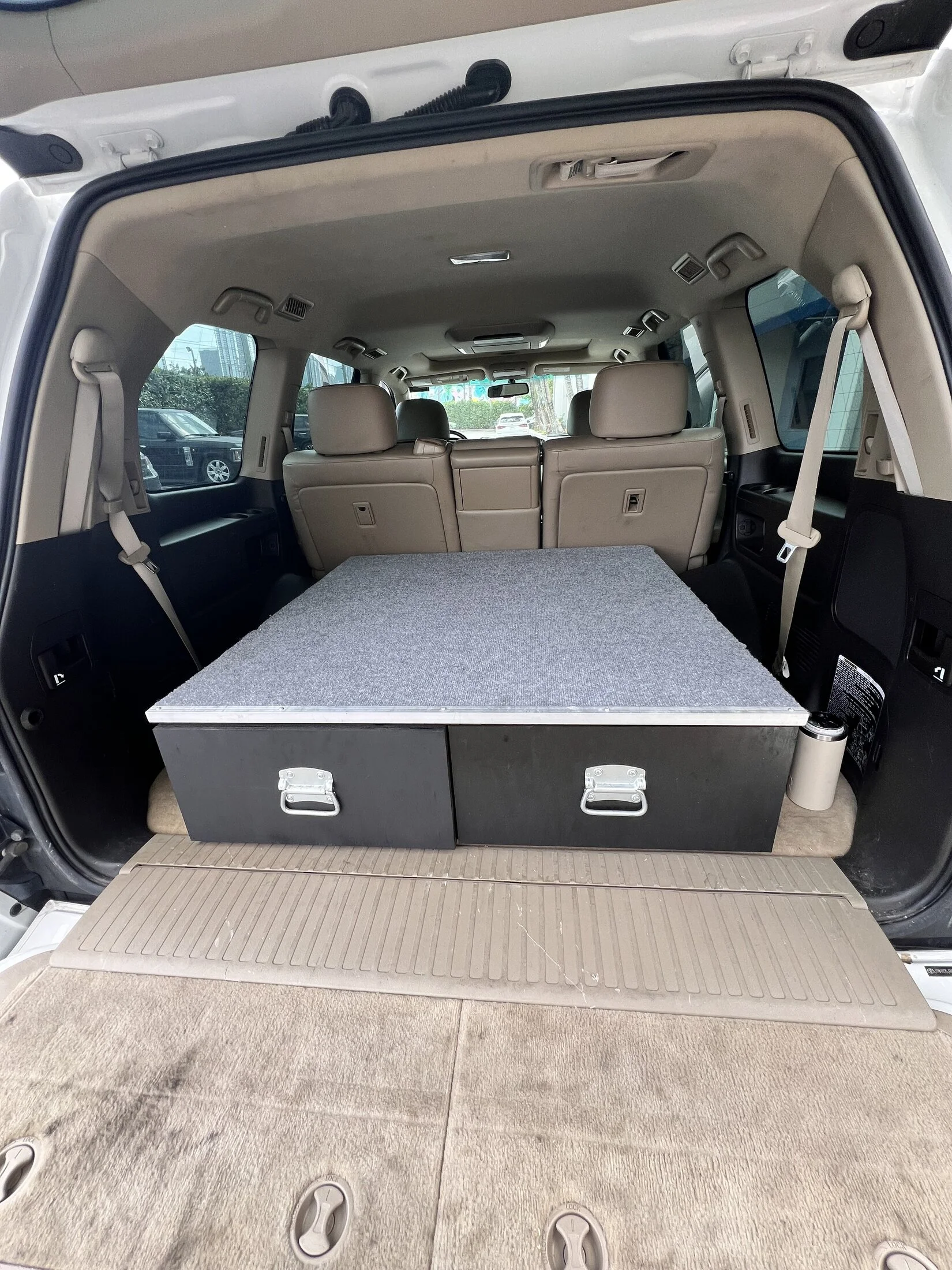

What about mounting it on a molle driver side rear window panel? It does have some weight to it. That concerns me. I don't know how strong the mounting points are.
I have one of these too and my plan is to mount it in the trunk. I have space on the sides of my drawers, since they were made to fit with the rear seats installed so I can fit it on side.
Thors lighting has a setup for quick disconnects so I am going to run wires under the truck and somehow… get them into the back, probably where the jack goes. I am going to hard mount the compressor down, I think this will be the most convenient for me since I have the air hoses in the drawers anyways.
I asked Victory if the molle side panels could handle the weight and they wouldn't commit to a yes. They said the mounting points are strong but never tested a compressor that heavy attached to it, so do it at your own risk
