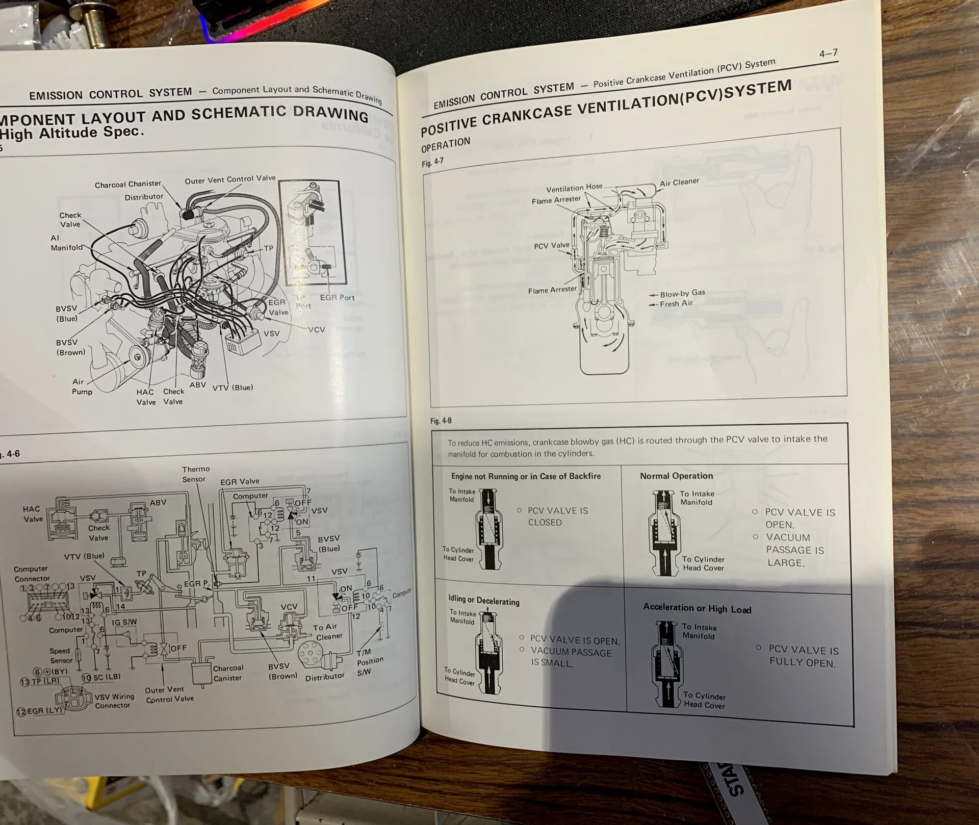

- remember : Positive Crankcase Ventalation or
PCV

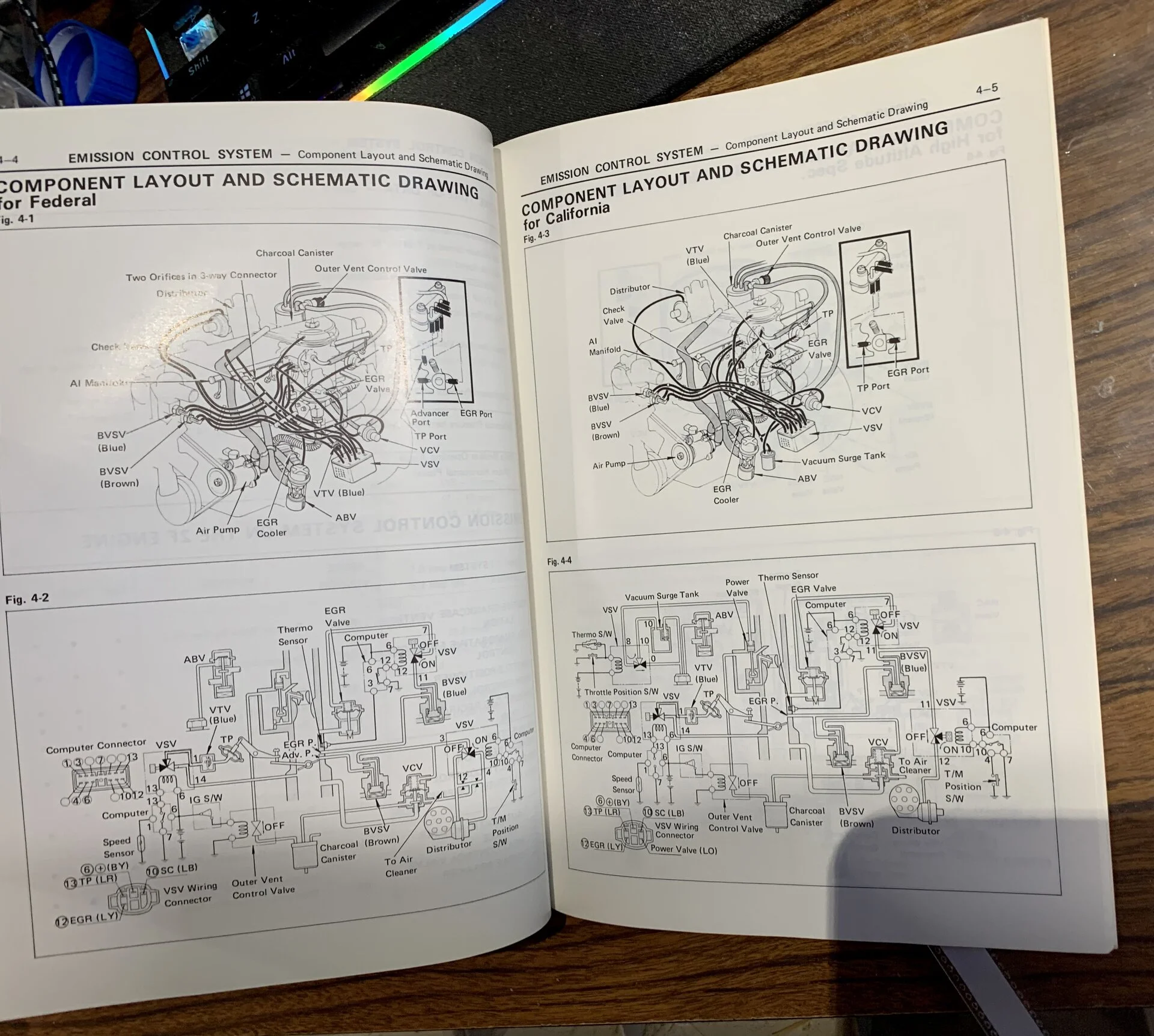

- now u need this :
- without it , your throwing darts 🎯 blindfolded in the dark
