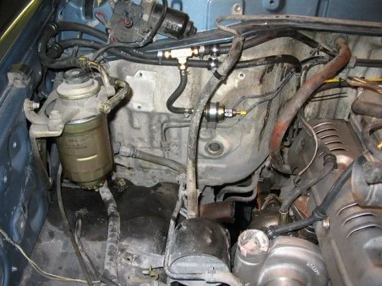

This is how it sits in my troopy(someone elses pic)
attachment.php
Here's where I installed mine on my swap. Works well and no issues in over 10,000 miles.
Doug
It is exactly the same as the Nissan TD4.2 filter which is mounted high up on the firewall well above the lift pump in the rotary IP. I wonder if the filter part numbers are the same. Sure looks the same. It is a none issue putting it up on the firewall. You are right to be concerned about where it is now. You can put them down there but they better be in a heavy duty steel case. They are also much easier to service up on the firewall.
The brackets are aluminum and it is easy to service all the filters in one area. The SS lines and AN fittings last forever. The 135 degree off the filter head worked great.
Being in the engine compartment is much safer than under the vehicle too.
I had to remote mount the oil filter to clear the front drive shaft wth the Isuzu.
Doug
