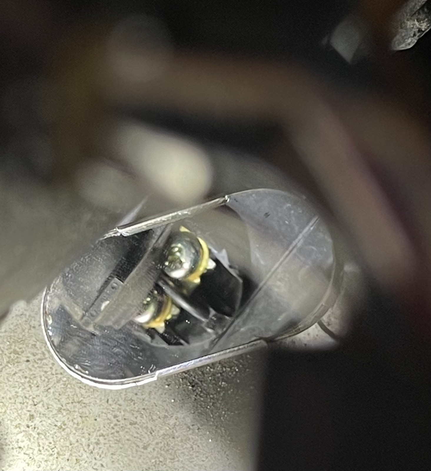

I have a 2006, North East truck, 231K miles and the two screws that goes to the brake motor looks like this. Can i assume it's been changed before? All of these i've seen have some sort of rust or corosion on it, esp from Northern trucks. Mine is spotless, looks like new
They are really clean and cleaner than the mileage would suggest. The ones I see with the most damage or corrosion are located on the ABS unit itself and not on the motor. I would be happy to see this if it was my vehicle. Lots of suggestions for adding dielectric grease and a vent hole in the rubber, I think that might be a valid point.
I've found 23 yr old rust buckets from Canada & Boston with clean brake control wire screws. Also supper clean 13 yr old, low mile, no rust with corrosion on screws.
IMHO, the factor that determines if corroded. Is if brake fluid gets on the wires, which fluid then follows wire(s) into the boot(s). Brake reservoir, if overfilled. Will often force out fluid from cap and or grommets, and run/drip onto brake control wires.
