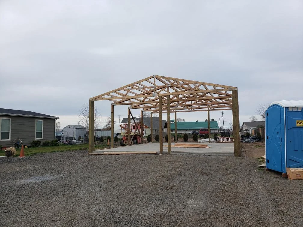

This is currently what's been built. Shop is 40'x32'x12' tall. Both garage doors will be 10' tall as well. I believe one is 10' wide and the other 12' wide (been a while since I've looked at the plans).
There are a few different ways to frame a pole barn for interior walls. Instead of writing an extensive dissertation on the subject, I would recommend talking to your builder first. Then we (the mud community) could answer any remaining questions. There are also several differnt methods to insulate your shop. Some are more cost effective than others. Fiberglass batting is usually the most economical. You should consider insulating the ceiling along with the walls and a mositure barrier is highly recommended, especially if you live in the southeastern US. I'm currently finishing the inside of my pole barn style shop and I won't be using sheetrock because I am too likely to knock a hole in it. My shop build thread is here in this fourm if you would like to check out how I am approaching some of your questions.
Looks good so far.
As far as the interior goes I would do T-111 plywood instead of sheet rock.

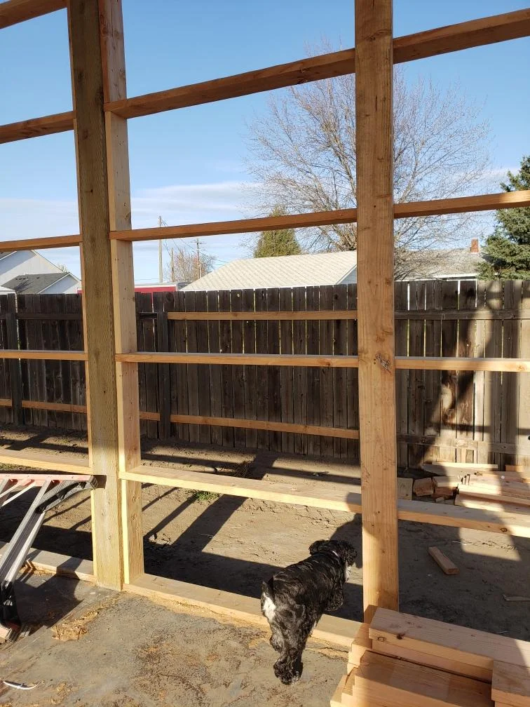

Got some more photos today of the progress. Looks like all I need to do is vertical studs for being able to finish the interior. Interesting to me that they laid the boards flat with the concrete and not flat with the siding.
Definitely hoping to be able to run electrical without drilling holes, if not I'll have to research the lumber code for the max allowable hole to be drilled.
Edit: looks like they're actually comedian girts (shows how little I know) should make it easier to finish without doing vertical studs unless those are still needed?

I hate it when they run the 2x6's like that. On a pole building, you want the 2x6's to be attached to the outside face of the posts so the 6" direction is vertical. This installation allows the sheeting/siding to act as part of the structure of the building (which it is).
If he ran the 2x6's on the outside of the posts you could then frame your interior walls out with vertical 2x4's flush with the inside of your 6x6 posts. There will be a 2" gap between the inside of outer wall 2x6's and the 2x4's- This is a very good thing! You can use 6" fiberglass batts this way or (preferred) use 2.5" of closed cell spray foam. If you plan to use spray foam it's very important you install a vapor barrier under your siding if you aren't sheeting with plywood. If you spray the foam directly onto the backside of the sheeting you will never, ever be able to remove the siding for maintenance/repairs/modifications.
You would be amazed the difference spray foam makes over batt or cellulose. The spray foam 100% seals a building and stiffens the structure. No more drafts and no creaks in a windstorm.
The way your building's walls are frame out you will have to use 1/4" furring strips on the faces of all the 2x6's to sheetrock over the posts as the posts are 5-3/4", not 5-1/2 like the 2x6's.
