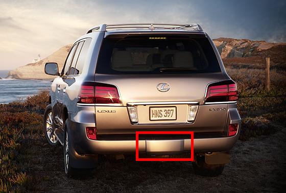

Add LEDs to the rear reflectors in the bumper. Thread(s) on here somewhere documenting where it was already done.

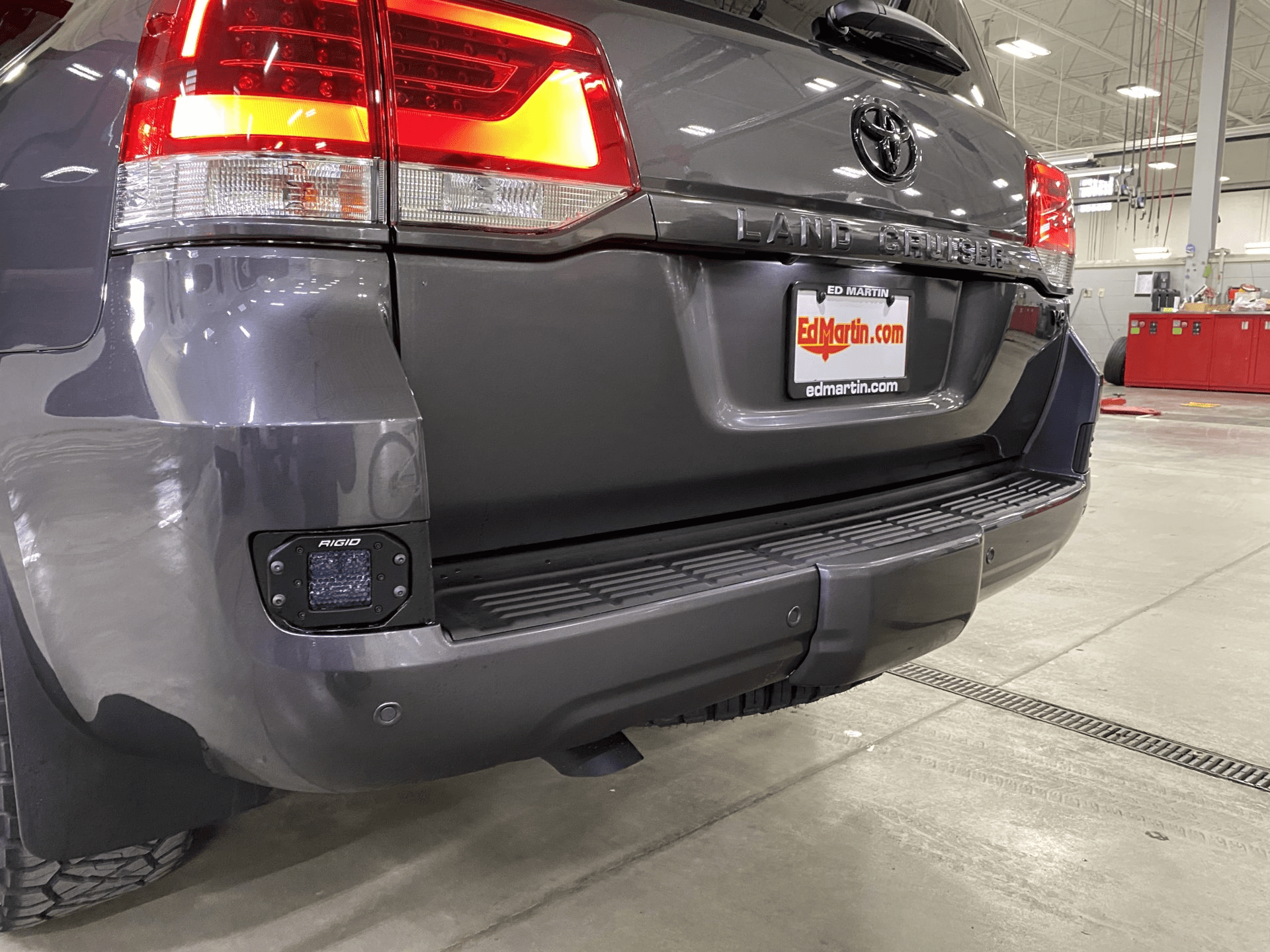

Here's a thread with some great examples. You could also enable the existing rear fog lenses to be functional lamps.
Those light retrofit’s would be perfect. I read through the thread-appears they may not be available except custom through that particular Toyota dealer.
