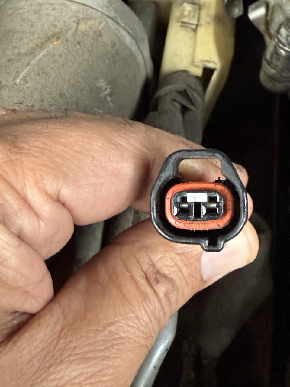

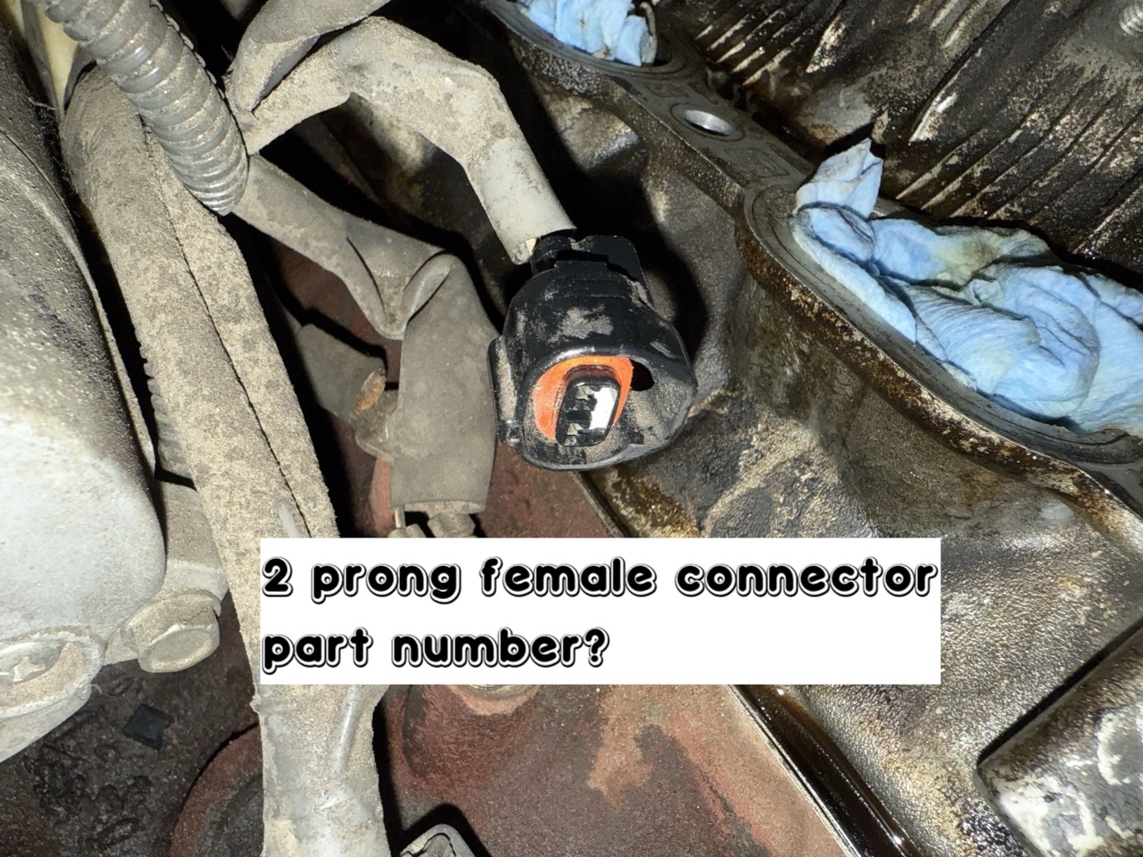

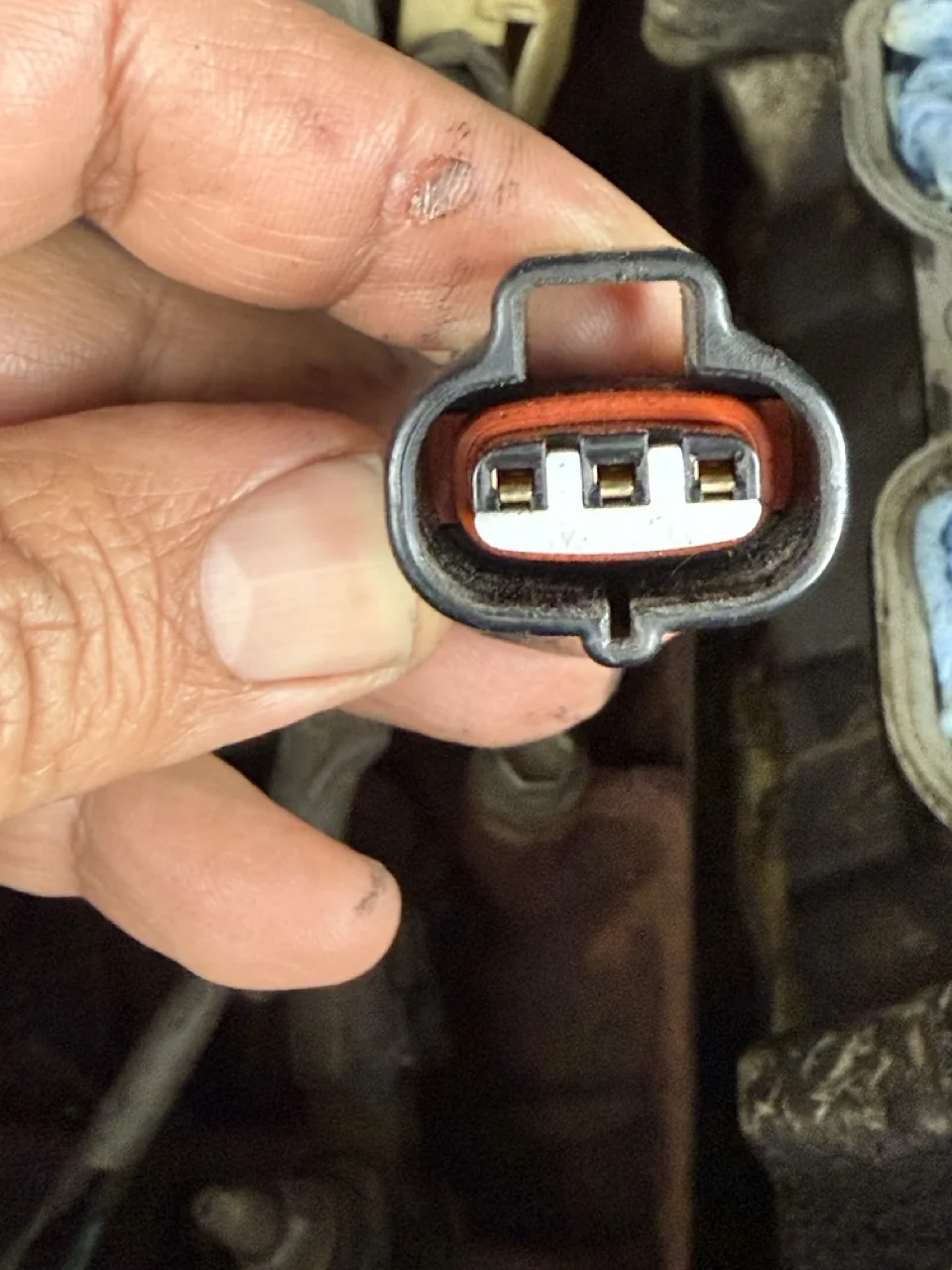

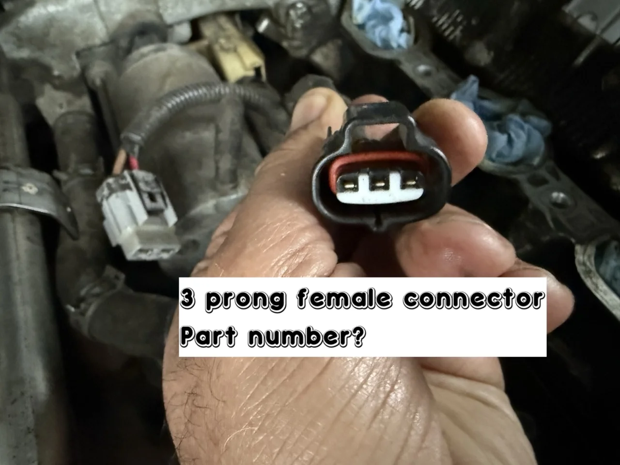

I was working 2006 Lexus lX470 and two female connectors broke while disconnecting SAIS Secondary air injector pump. Can someone please help identify these two female connectors, and write part number for it?
Thanks in advance!
Never mind I found it. Three prong connector part number is 90980-10845 and the two prong connector part number is 90980-11149. This is for 2006 and 2007 LX470, not sure if it's the same for early models. Hope this will help someone in future!
