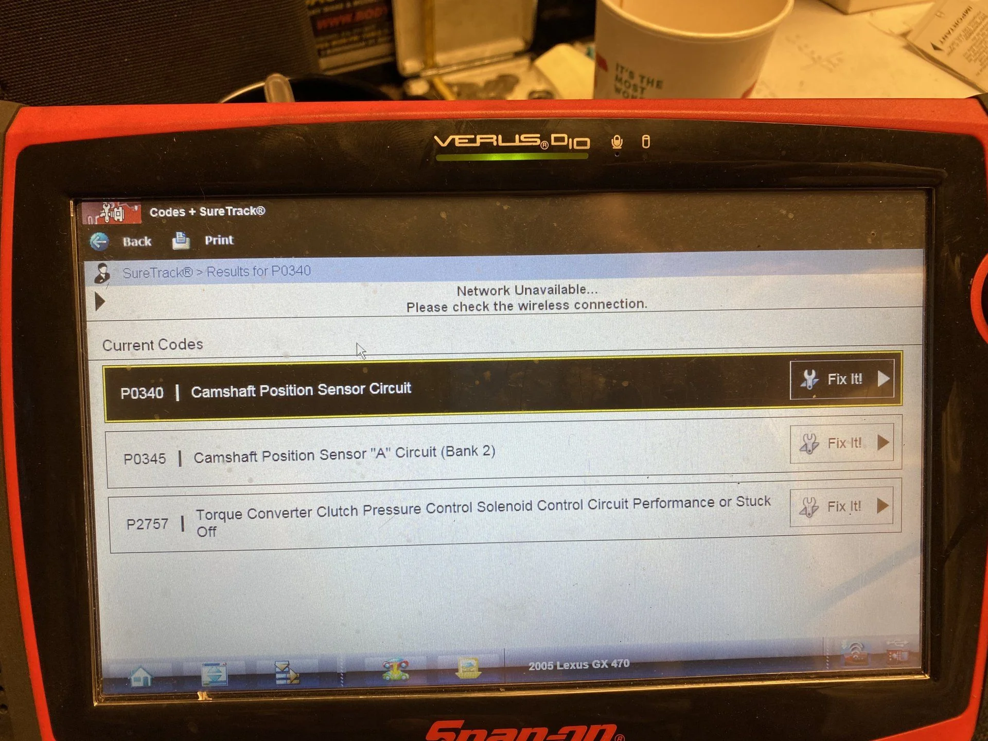

Last year wasn't the best for many of us; for me, the last day of the year had another cherry on the top. Yesterday I noticed an oil leak under my car; the leak looks like engine oil. This observation coincided with four warning lights on my dash. Then, I connected a scanner and got three serious errors:
WARNINGS:
VSC TRAC, VSC OFF, ANTI-SKID, CHECK ENGINE.
ERRORS:
P0340| Camshaft Position Circuit
P0345| Camshaft Position Sensor "A" Circuit (Bank 2)
P2757| Torque Converter Clutch Pressure Control Solenoid Control Circuit Performance or Stuck Off

First off, ANYTHING that trips the CEL will trip those three other lights with it. Scary the first time, then just an annoying Toyota quirk thereafter. Secondly, it's possible (albeit not necessarily probable) that your sensors are tripping due to your battery situation. I'd rule that out first as I don't see how a camshaft code and transmission code are related to one another. Once the charging system is addressed, including an inspection of the grounds, if it was mine I'd flush the transmission so I could rule out low or bad fluid.

Thanks very much, I followed these suggestions and got a new battery installed. I cleared up the codes with the scanner and then had no issues diving for the next couple of hours. However, the problem with gearing and the same error codes came back again. When you recommended checking the grounds, did you mean I should look at wirings underneath the car? I am not sure if there is any schematic manual of the electrical system.
If you have the capability check the freeze frame on the codes. Look to see what the battery voltage is reading when the code was thrown. If the voltage is reading low, below 12 volts or so you may have a charging system issue, or electrical. Pretty sure Toyota has a service bulletin for that, common issue with those codes. Also just having recent repairs Id look real close at what they did and make sure everything is tight and in order!

Your earlier post referenced the transmission code for P2757| Torque Converter Clutch Pressure Control Solenoid Control Circuit Performance or Stuck Off
If there are issues with the torque converter, you will have issues going from Park to any gear, but maybe no issues between various drive gears. Overall does not sound good, if it was my truck I would consider taking in to a dealer or a transmission shop to diagnose the problem.
