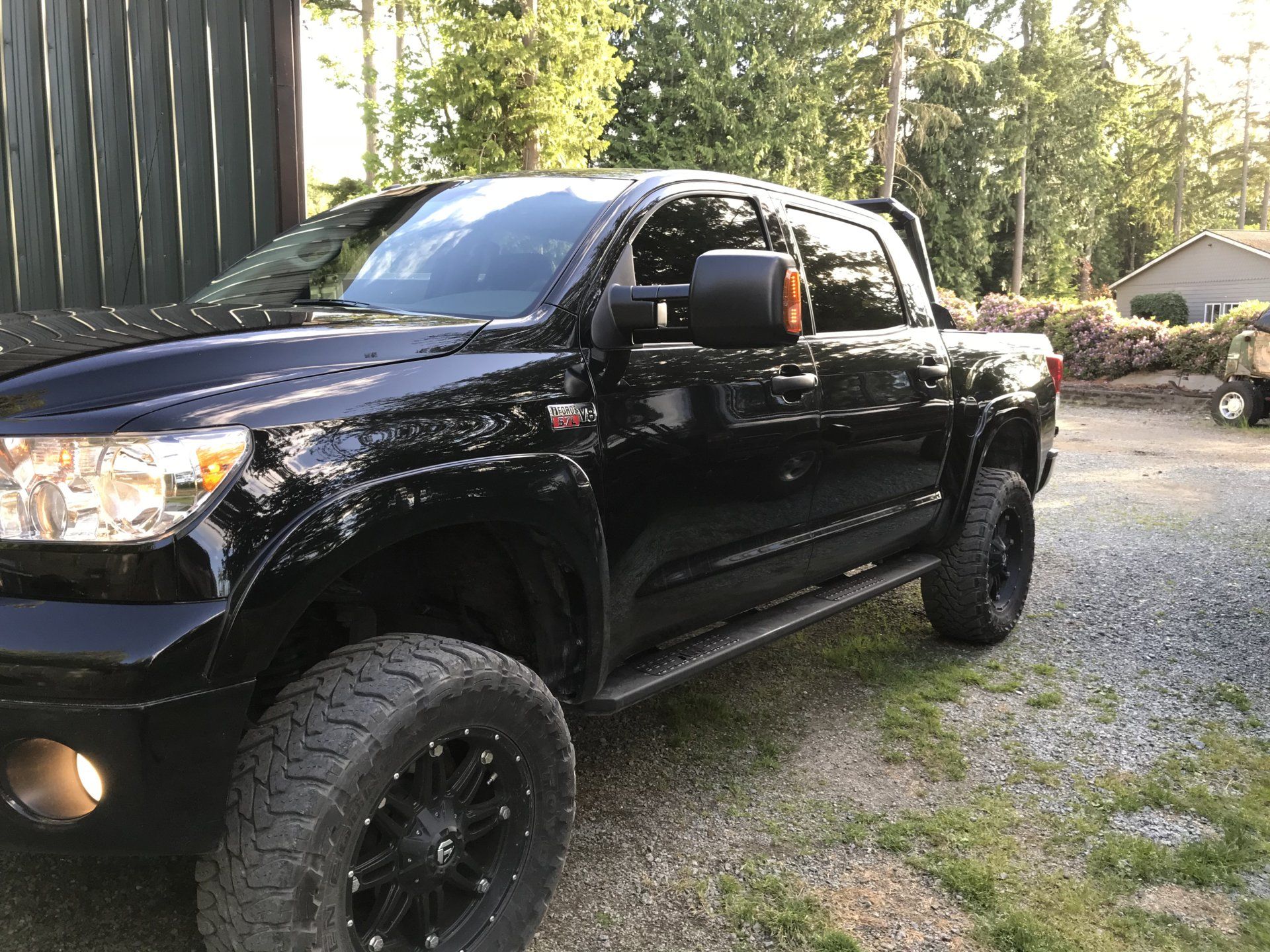

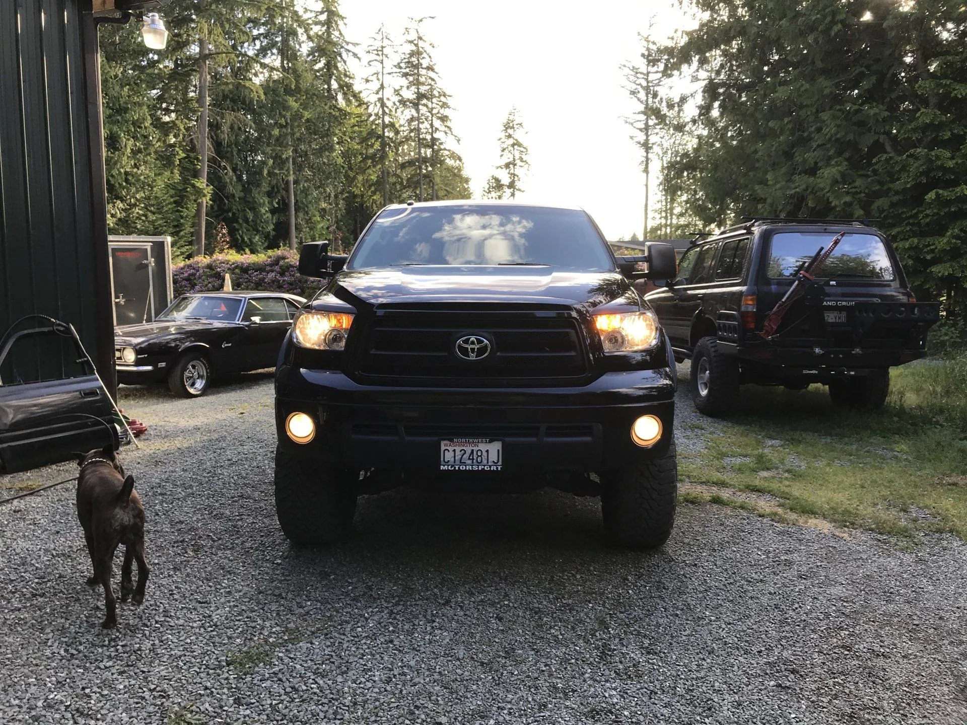

Wanted a shot to show front shot of truck with mirrors (and a sneaky little boxer butt made the shot). The important facts are the mirrors are 16” collapsed, and 19.5” expanded - measured from underside of mirror.

Turn on the running lights:
Waaaaait - whaaaaaaat? What is this crazy scorcery?
OK, so now I’m completely in “how far is this happy bonus going to go?” -mode.

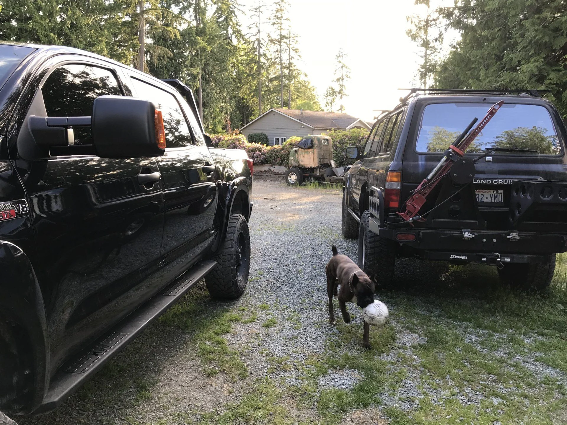

So, the million dollar question - do I have turn signals? :
One well-timed pic (took me ~4 tries, but between the beer & the fact it worked, that was nothin!)
