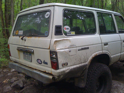

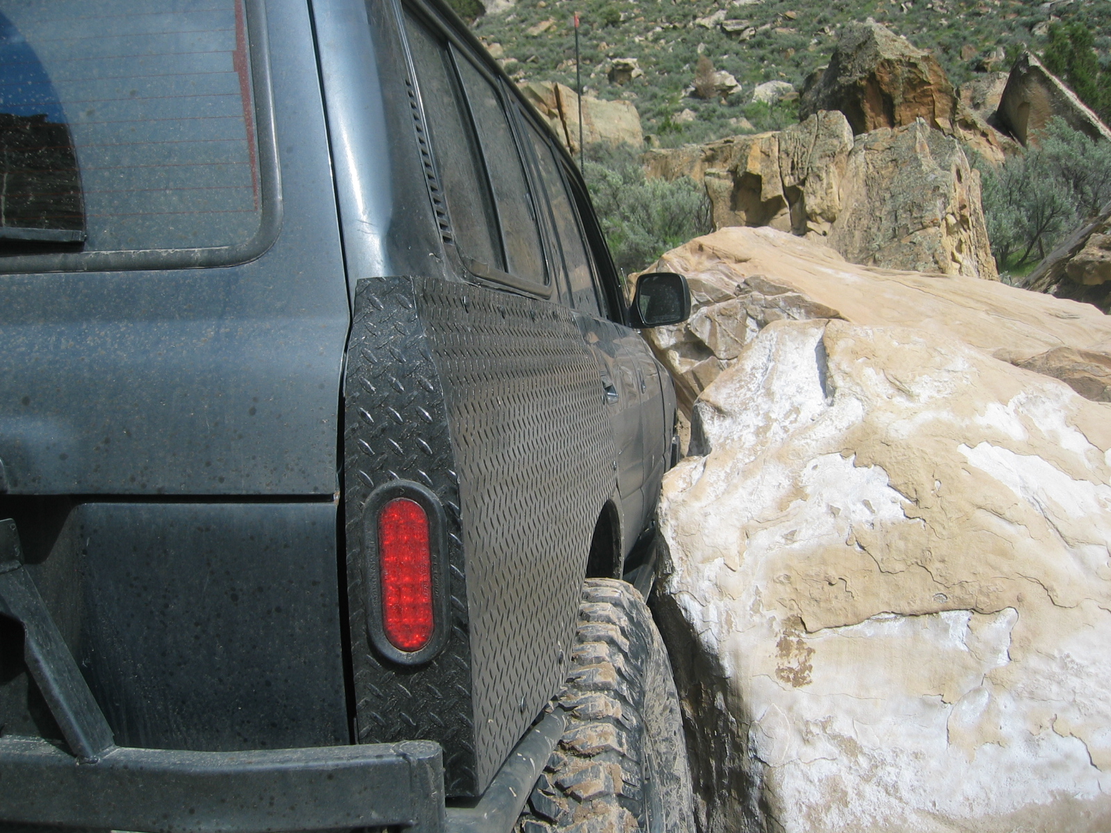

So after bending the hell out of my rear quarter last year at CMCC, I want to add some protection in order to prevent it from happening again. The first thing I thought of was ActionJackson's diamond plate quarters that he fabbed up. They look pretty good and apparently function really well. I would use some LED trailer lights to replace the stock lights and I would also chop my quarters to run a tube underneath the quarter to protect from underneath.
It seems that one could take some measurements and bend up a template that would work pretty easily. The question is how to attach it. Would it be better / stronger to weld a plate like this onto the quarter or would it be better to bolt it on?
Anyone done this on a 60 before?
( img pilfered from Jackson Family Blog )
Just my opinion, but I think it looks better with dents than it would with diamond plate as in that first picture. If you are going to put some plate on there, I wouldn't think it would make much difference if you bolt it on, or weld it on. From the looks of the truck, you probably won't ever take it off again anyway...
From the looks of the truck..... You saying that it's rusty?:hillbilly:
Here's another pic of one. I'm hearing that 1/8" diamond plate tread is the ticket.

I would weld the plate steel on, it would be more work but look better
I'm not a fan of diamond plate and it adds so much more weight. The tubing, if done right is easier to replace and wont hold moisture underneath. I like the tube on the blue 60 in the photo. I also would like to see a"skin" for the "80's like the broncos have.:p
I was thinking about that too and figured thats the reason why the one's I've seen have been bolt on, so moisture could get out from underneath. I was thinking that maybe you could paint the quarter with rust bullet and then weld it on. Maybe I could come up with a really close bolt on solution that would look good:hhmm:

I think "rust bullet" or "por-15" under the panel would do just fine. I like the look of the red 80 in the previous post. It's like what I was trying to describe w/ the old Bronco panels. They fit nice and snug and look good also.;)

If you didnt wanna go THAT far, then Id say rivets. Its semi permanent, and you could take em off if you need later. I personally wouldnt weld those on.
