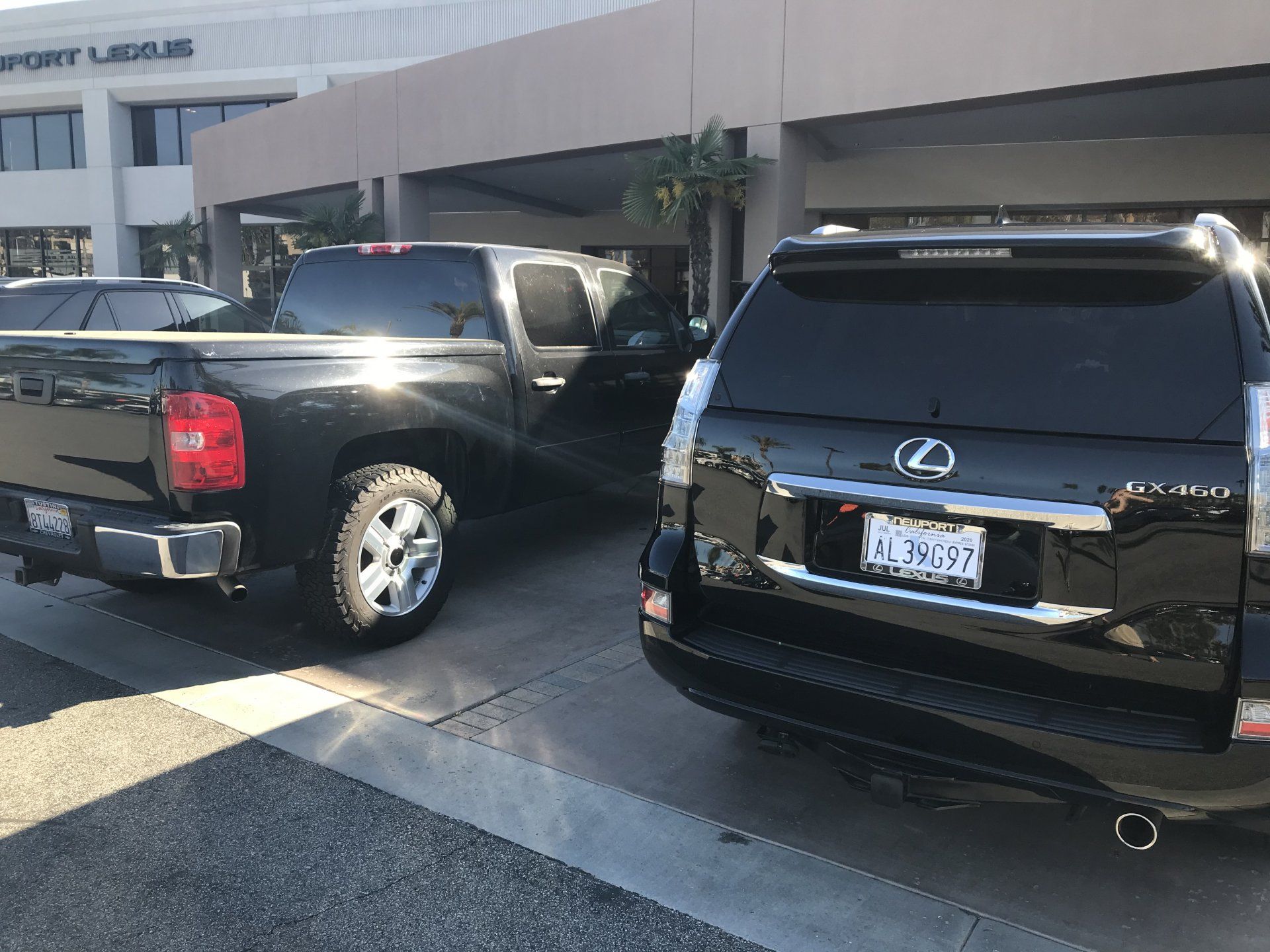

Has anyone plastidipped the chrome window and door molding trim on their GX460? If so, how did it turn out and what did you do in order to prep it? Lastly, how is it holding up?

You'd think the auto mfg’s would stop putting this cheap fake plastic chrome s*** on vehicles since a large portion of people hate it. We do not have a choice when we buy so we all are stuck with it.
