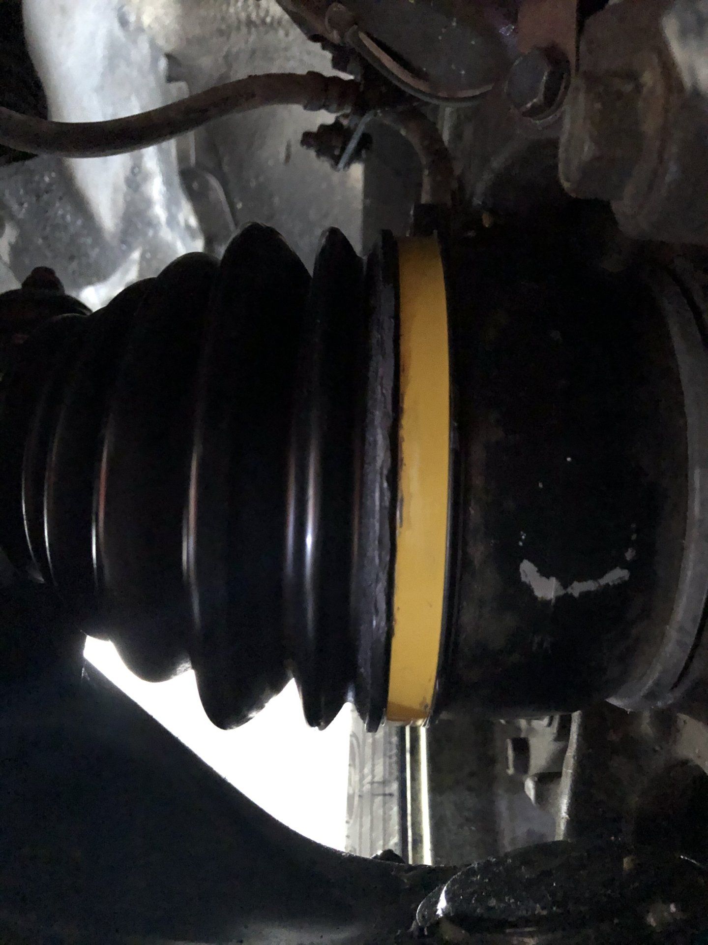

Right next to clamp on the ridge. Very small hole but a surprise amount of grease leaking both while driving and while at rest.
Everything went great with front end work I did (upper and lower ball joints, inner/outer tie rods, sway bar bushings) but must have banged the boot around a bit... Nothing I remember - I can’t believe they could be that sensitive.
Any way to solve besides a new boot?

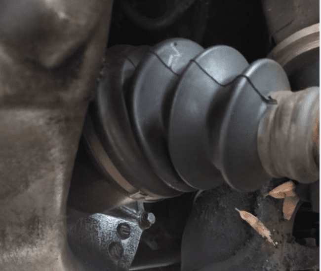

Many years ago, I used silicone emergency repair tape to wrap a CV axle end on that car that was prone to leak and puncturing the inner boot. Silicone tape does not use glue. It must be stretched where it bonds into itself. I found a picture where I had running for several years. It did a good job in this particular application. The silicone tape enhanced boot is running on a vehicle with a lowered suspension. I've learned over the years that lowered and lifted suspensions place unusual stress on CV axle boots and sometimes require additional steps to keep things running for the long haul.
If you are not familiar with using silicone tape, it takes a few tries to get the swing of it. One you get it set, usually the only way to remove it is to cut it off.
Now that I think about it, I should wrap my new 100 series CV axle ends. The neat thing about silicone tape is continues to work after being soaked in oil.
One time I accidentally dropped a roll into a pan of used motor oil. So I pulled it out, wiped it off and it continued to work after being soaked in oil.
The boot in this picture has been running for years without issue.

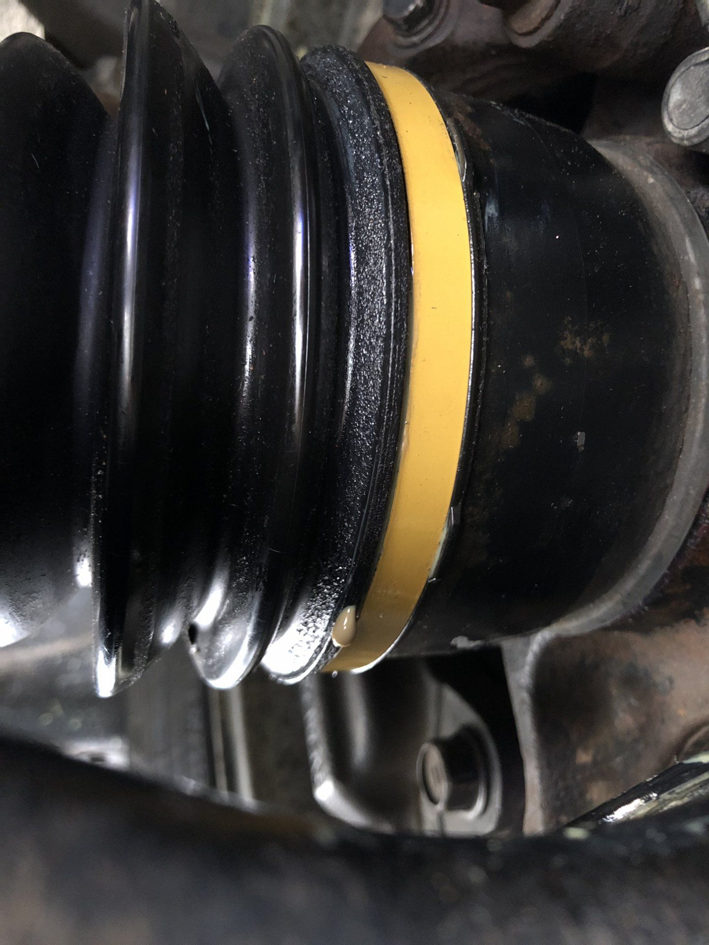

Well I used The Right Stuff from Permatex, we’ll see what happens! Here’s a before and after. Still shocked at the development of the pinhole itself, the boots seem hardier than that. Cleaned it up with degreaser, then alcohol, then air to dry and to push the cv grease back in a bit. Buffed with some emory cloth and then layered in/on the Permatex.
**Edit - took a 30 mile spin and looking good! Will keep an eye on it and go from there. Thanks for the input all!

The Right Stuff did a great job but the boot recently formed a few more pinholes right in that seam just above the repair. Not sure why, it's not lifted as OwnerSC mentioned above (though the torsion bars were turned to bring the front end up just a bit). Repaired again with the Right Stuff and so far so good!
