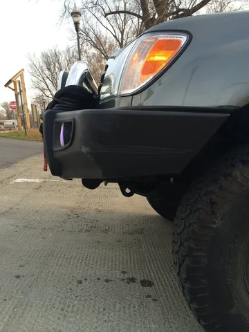

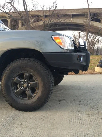

pics needed of gap between '03+ arb bumper and '99 LC body
There is a small half inch gap that is filled with a supplied by ARB rubber gasket/gap filler piece.
It looks good and fit well on my 99
I don't have the ARB but most aftermarket bumpers do create a gap and that is usually there to compensate for any body flex you may experience while on the trail or while winching. You certainly don't want it tucked up against the body or can can say goodbye to a headlight or fender if you are ever winching another vehicle or yourself out....
