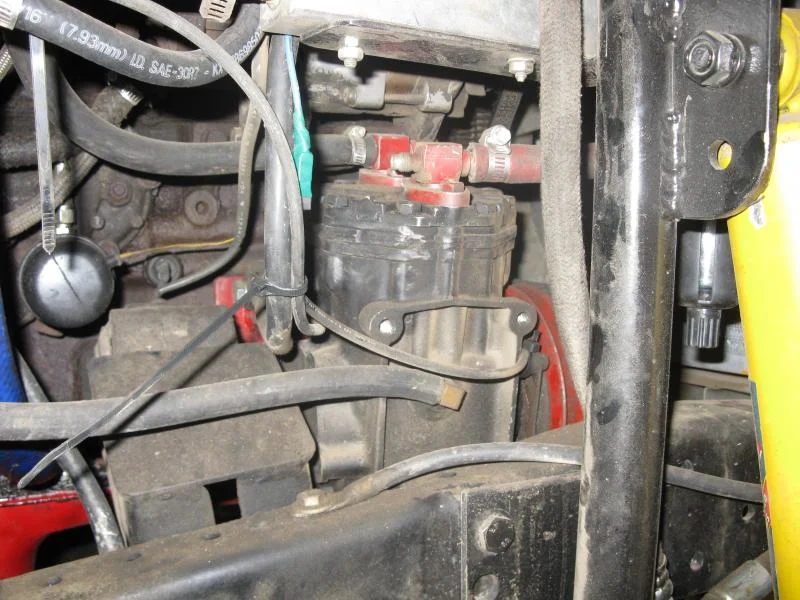

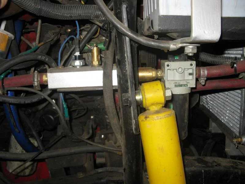

Hi Haryv,
l got your pm,l will post some pictures here.

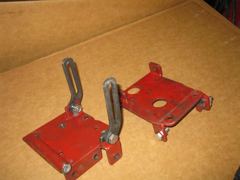

The compressor was mounted on a 81 BJ42,l was building a rockrawler with H55 and Marlin toybob,so the engine was moved forward 4",there was not much room between the engine and the fame,so l built a low profile bracket to mount the york 210.
here are some pics.

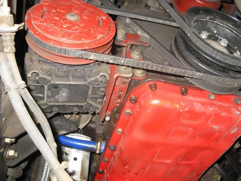

l also bougt a 3B A/C pulley from Toyota.

BTW, to bad you did not have dimensions on the brackets. At least now I can see where you attached the pieces and fabricated up the pieces together. It is a good starting point.

Your pulley arrangement is different then what the dealership shows in there diagram but, the clearity of the diagram is probably in question. I see your first grove powers the alternator and water pump? Then second pulley grove powers the AC pump? then the second bolt on pulley powers steering pump?

l bought the ps and ac pulleyfrom toyota about 4 yrs ago,the ac puller uses a narrow belt and ps the wider belt,they can only bolton one way.l am geting some used pulleys next week,let me know if yo uneed one.
