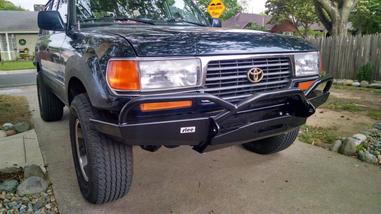

Came with an ARB bumper. Never liked them. Put it on my Facebook and a guy with a 4runner snagged it up. Gave it a shave and took off the hoops, looks pretty good! I just don't like these things
they aren't my cup of tea either, imo, you have to have a lifted truck with giant tires to even begin to make it look right
<3 my shortbus on the other hand...
also, i have the same wheels :D nice...
went with 35s, though
