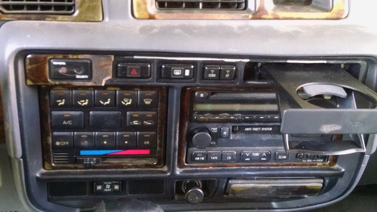

Got the cupholder, went in easy. Now I'm chipping away at the beautiful wood grain plastic
I waited for a REALLY hot day, and brought out my PLASTIC narrow spatula to assist. I had ALL of that crappy wood stuff peeled during my lunch hour. I purposely parked in the sun and kept it closed up. It was 145° inside when I climbed in. Needless to say, I was sweating a bit during that time. It all came off CLEAN! I only had one piece I had to later use solvent to remove adhesive.
