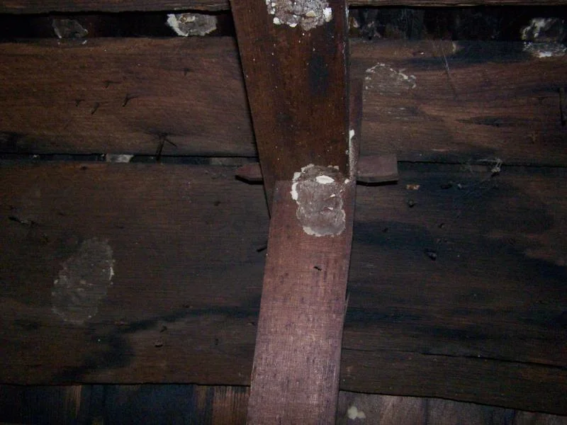

that wood looks awfully like Chestnut---
Thanks, it may be. It is pretty dark and hard to tell for sure but I have heard others mention Chestnut when looking at it.

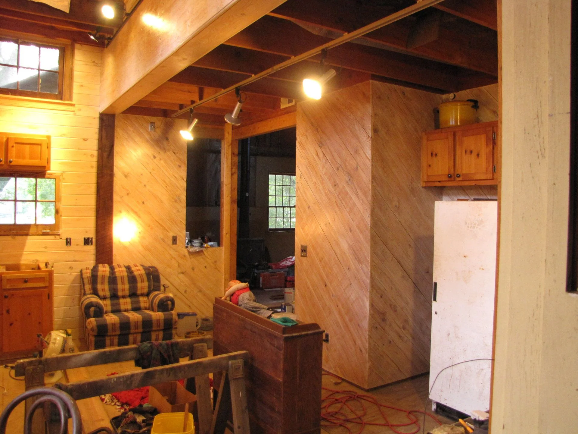

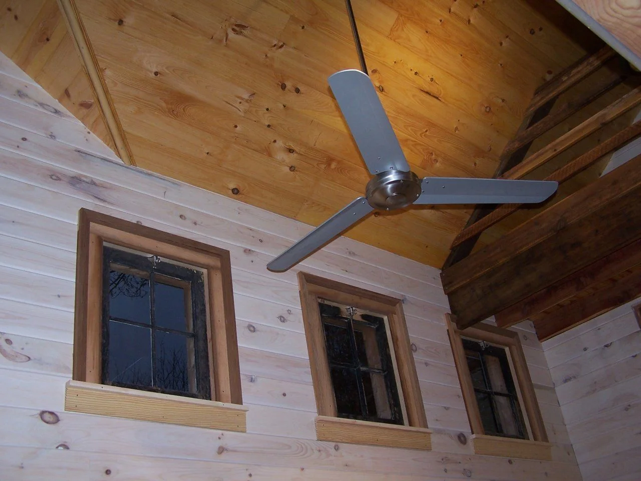

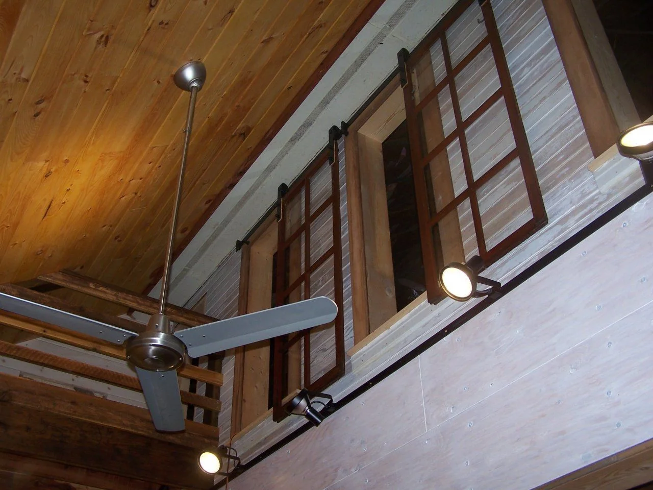

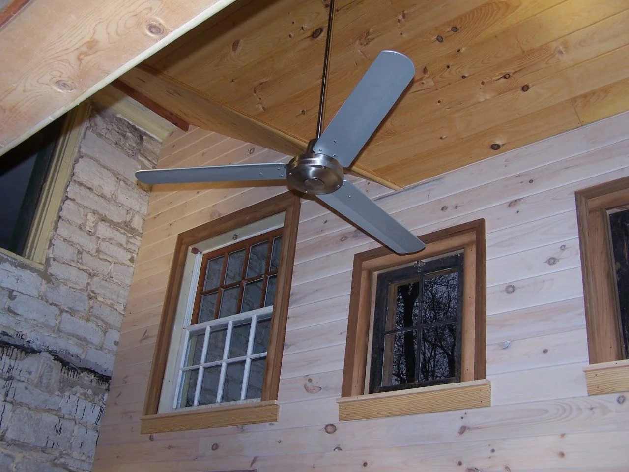

I have not updated the blog in several months. I have been white washing the kitchen walls, putting in the track lighting and ceiling fan, railing on the reading loft, hardware/hinges/latches on the kitchen windows and finishing the trim work around the windows. I will try to get some updated entries soon. My last was when we completed the ceiling in the kitchen.

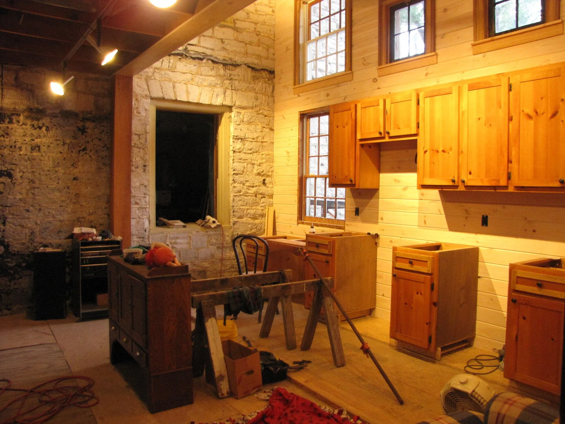

Kitchen ceiling; Kitchen ceiling woodwork.

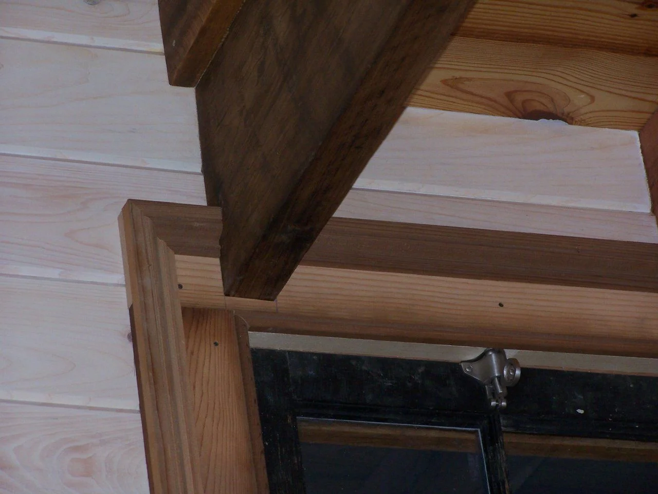

sggoat, I have used a lot of different types of wood in the kitchen renovation/expansion. I have used wood that was on hand in the house, wood that dad had set aside for the 1970's addition. Also wood from a neighbor with a saw mill and wood that came out of the old stone part of the house.

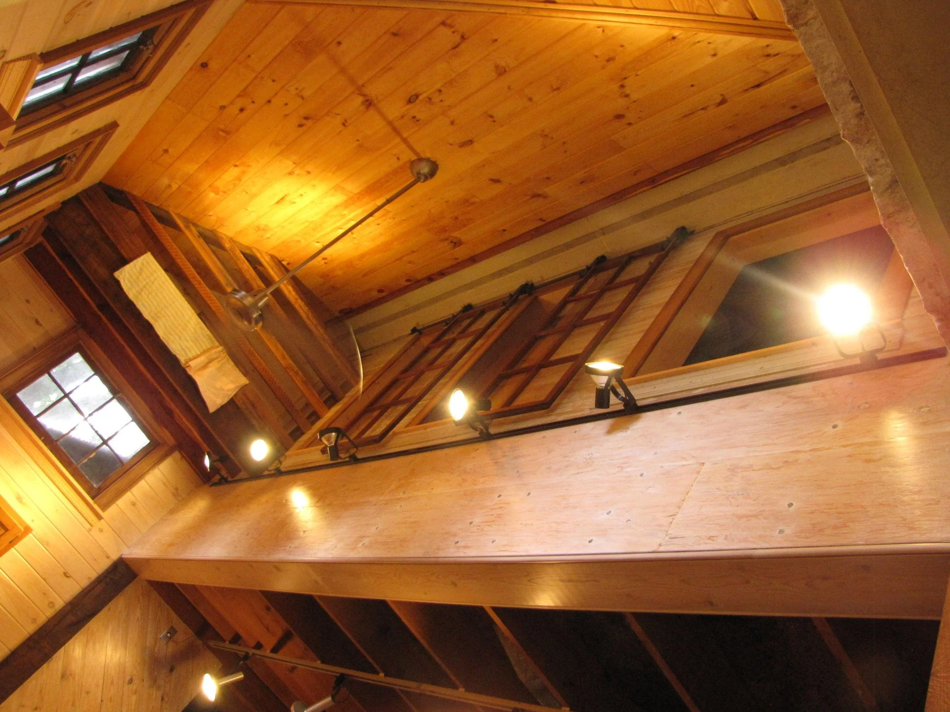

When I built the railing on the reading loft I used some rough sawn poplar we had sitting around as well as some salvaged poplar my dad had gotten some 40 years ago. They were floor joists from an old house they tore down back then and he used them as the ceiling rafters in the addition.
I capped the top of the railing with a board that was taken out of the old stone house roof when dad cut the opening for the door to the third floor loft. He cut the opening in the 1970's and kept the wood. I found one that fit perfectly. I will try to get some updated pictures of this cleaned up board as it may very well be Chestnut.
If it is indeed Chestnut that would make it about 8 or 9 different species used so far in the kitchen. I have pine, cedar and poplar on the walls and ceiling. Oak, cherry and walnut columns. Trim work is pine, poplar and Douglas fir. Some poplar and cedar beams. The railing is poplar and maybe chestnut. Some old bead board from the old porch ceiling that I am not sure what it is. Probably pine.

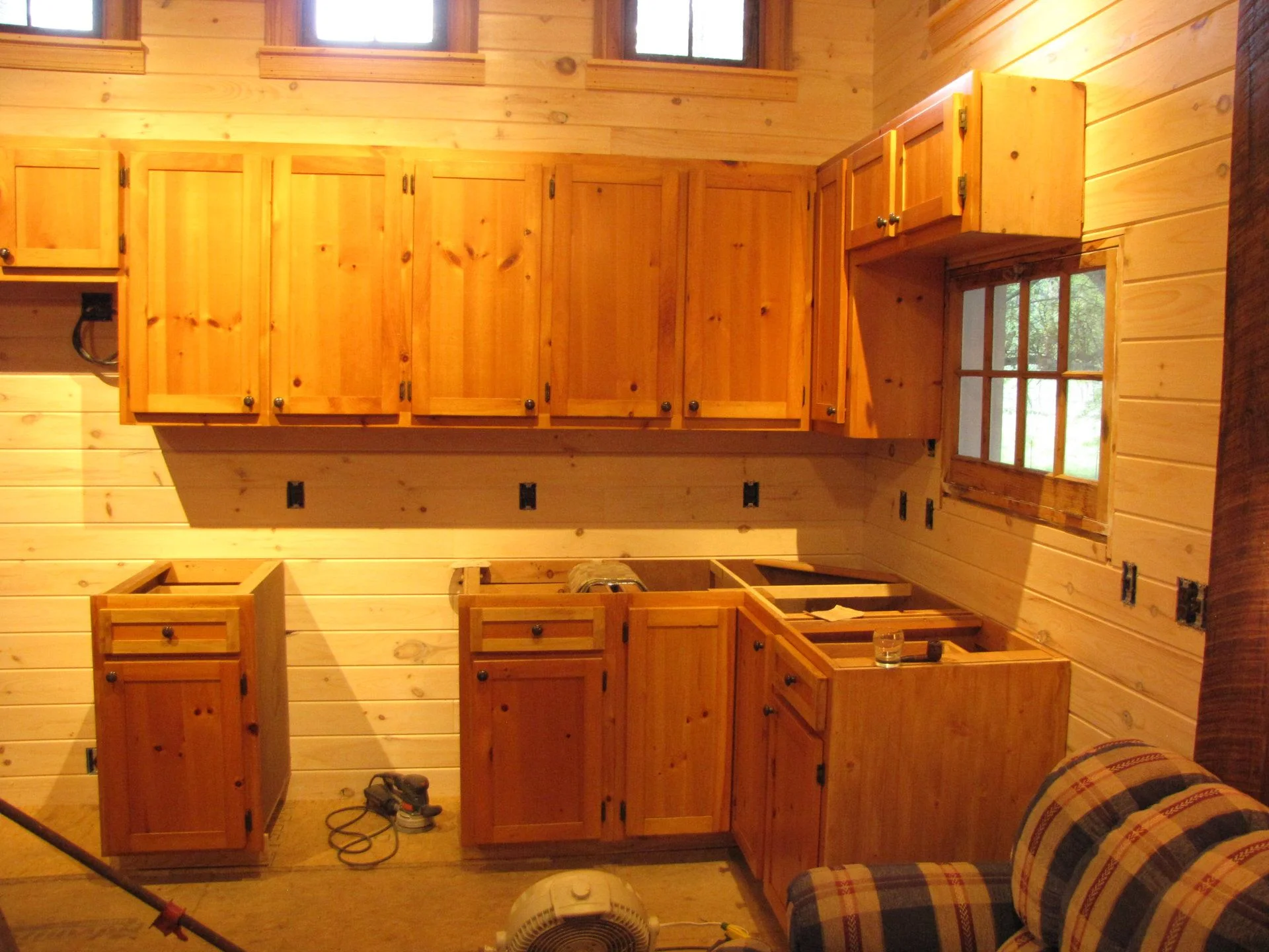

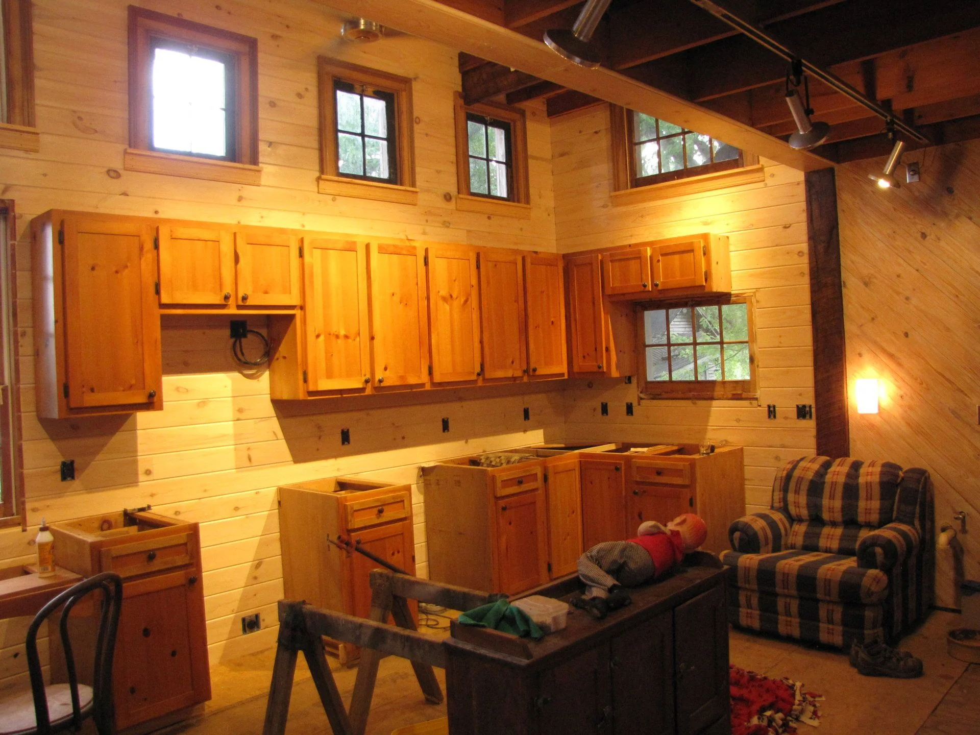

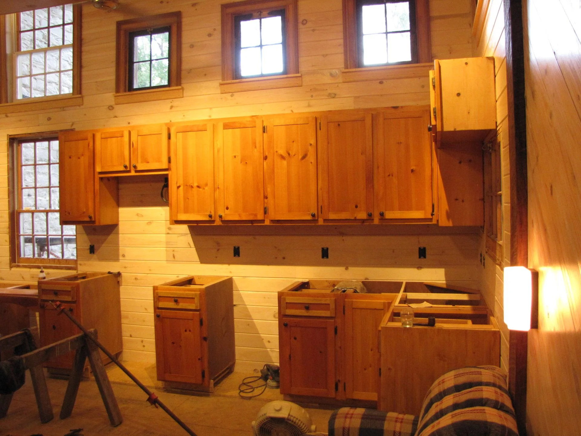

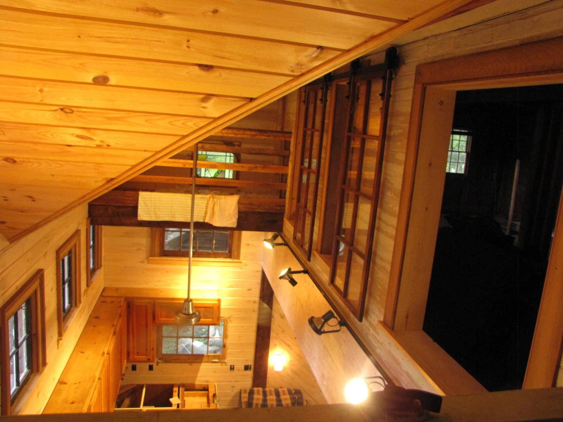

Some kitchen details.

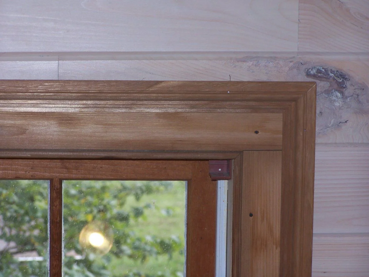

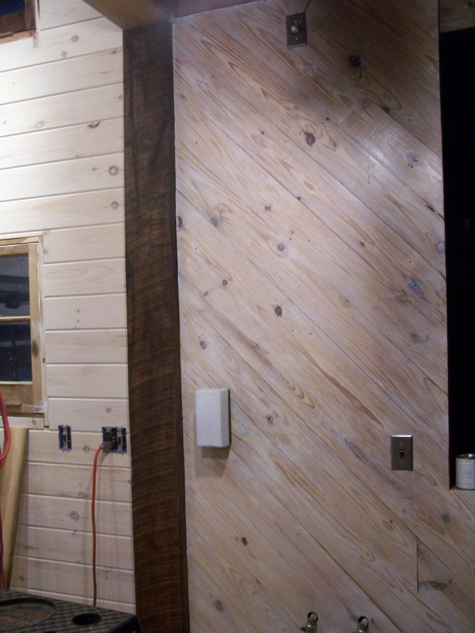

On the walls I used a Zar oil based stain called Coastal Boards. I picked it up at a local hardware store. You can see it listed here on the Zar website. ZAR® Wood Finishing Products It is a bit labor intensive as you rub it all on/in with a cloth or rag. Lots of rags and rubber gloves and sweaty hands in the gloves. Not much fun but I wanted to lighten up the room and break up all the wood some but I wanted the wood to still come through.
I treated all the walls with this stain, the beveled edge tongue and grove white pine wood flooring that I put on bottom side out. Also used this stain on the old bead board wall, the beams spanning the kitchen and the diagonal tongue and groove pine as well which has been up on the walls since the 1970's. I did sand these older walls, did not sand the new beveled pine walls. I got too much of the stain on the diagonal boards and sanded some off. It is a very thick stain, looks just like white oil based paint and may very well be a variation of it.
The Zar stain recommended applying a coat of polyurethane over it. I didn't want much any shine at all so I went with Aqua Zar clear antique flat polyurethane. It is a low VOC water based polyurethane. I went with the water base because it dries crystal clear, won't yellow like oil base. Also less fumes and much easier to work with and clean up. It went on real easy with a brush, real nice. I couldn't find it anywhere local so I ordered it from Amazon. I actually have not finished putting this poly over all the new walls yet. I still have the lower half to finish.
All the other darker woods just have a coat of boiled linseed oil on them.
I will say that it looks quite a bit different in person. The contrast between the white washed or stained walls to the natural oiled wood is much more subtle. The flash and digital image reflects off the white more or something. The walls change a bit depending on what kind and how much light is shining on them.

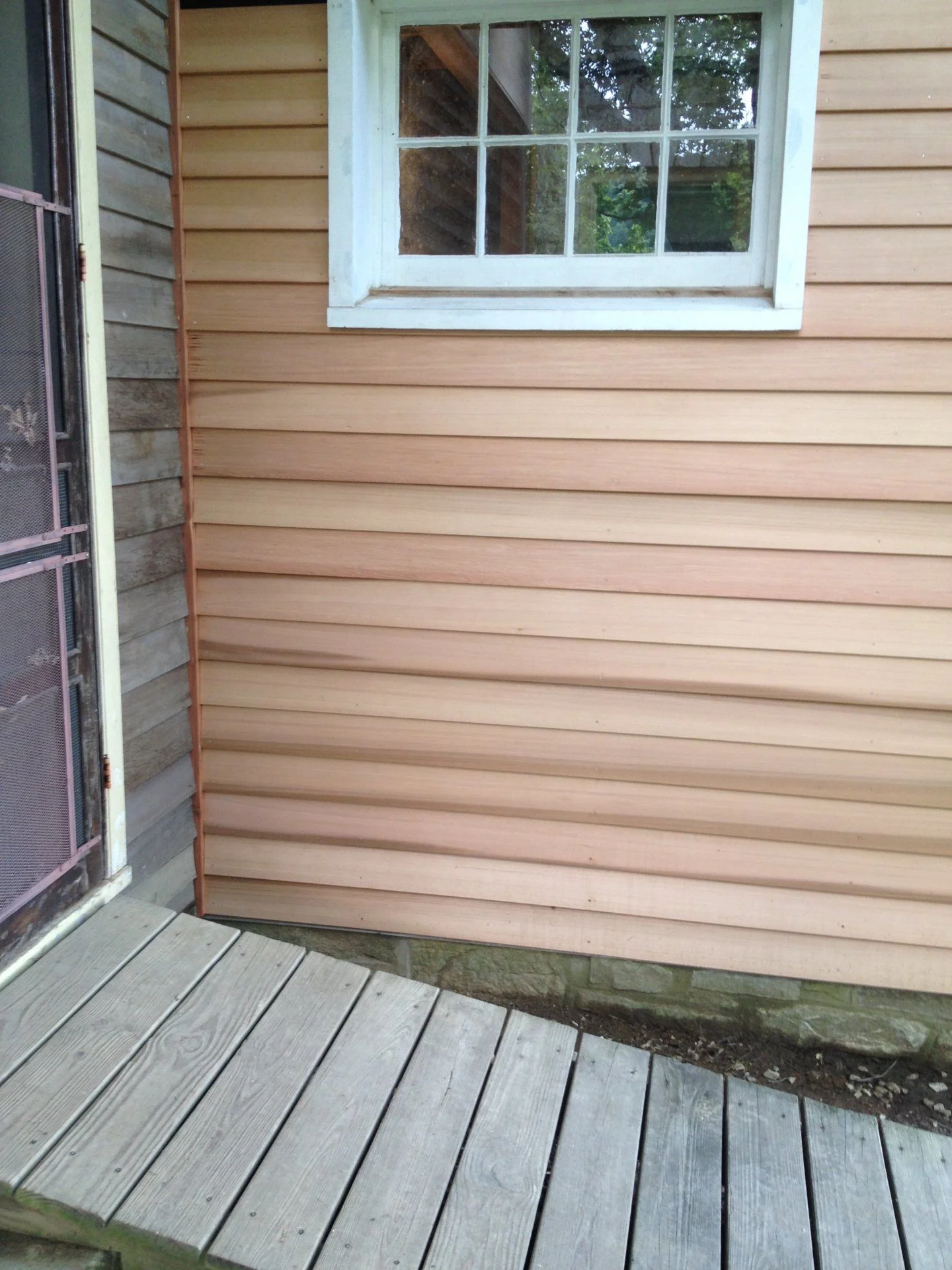

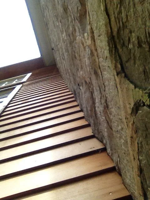

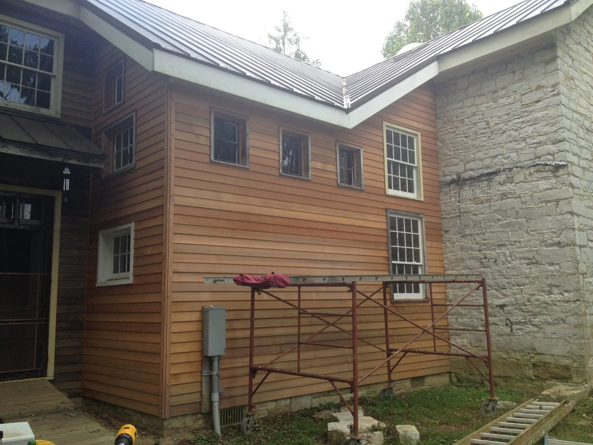

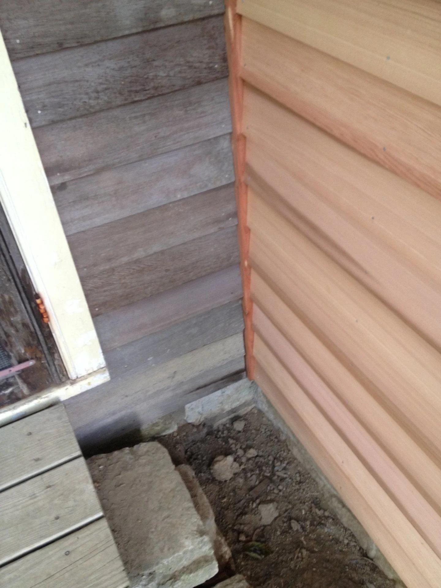

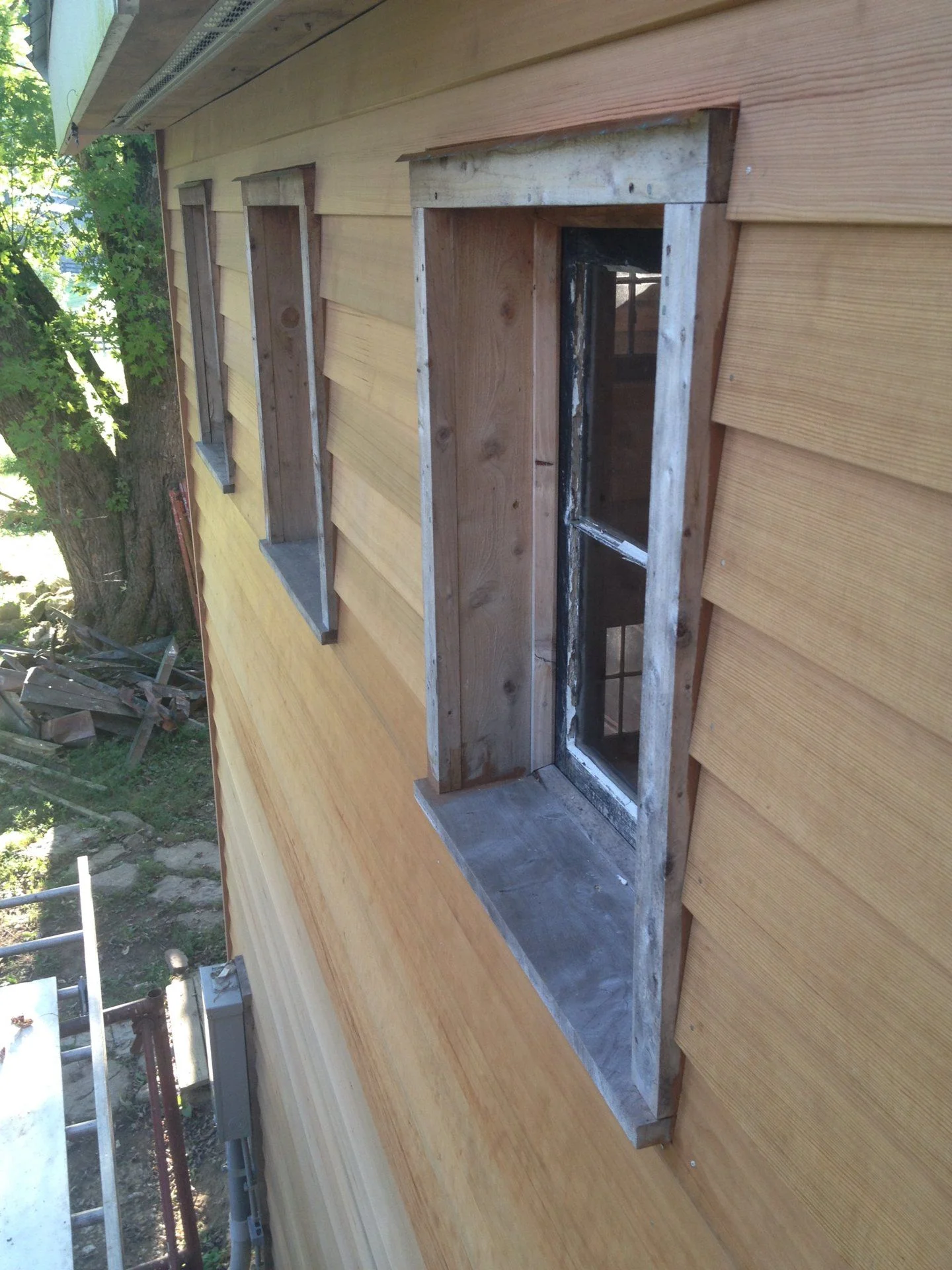

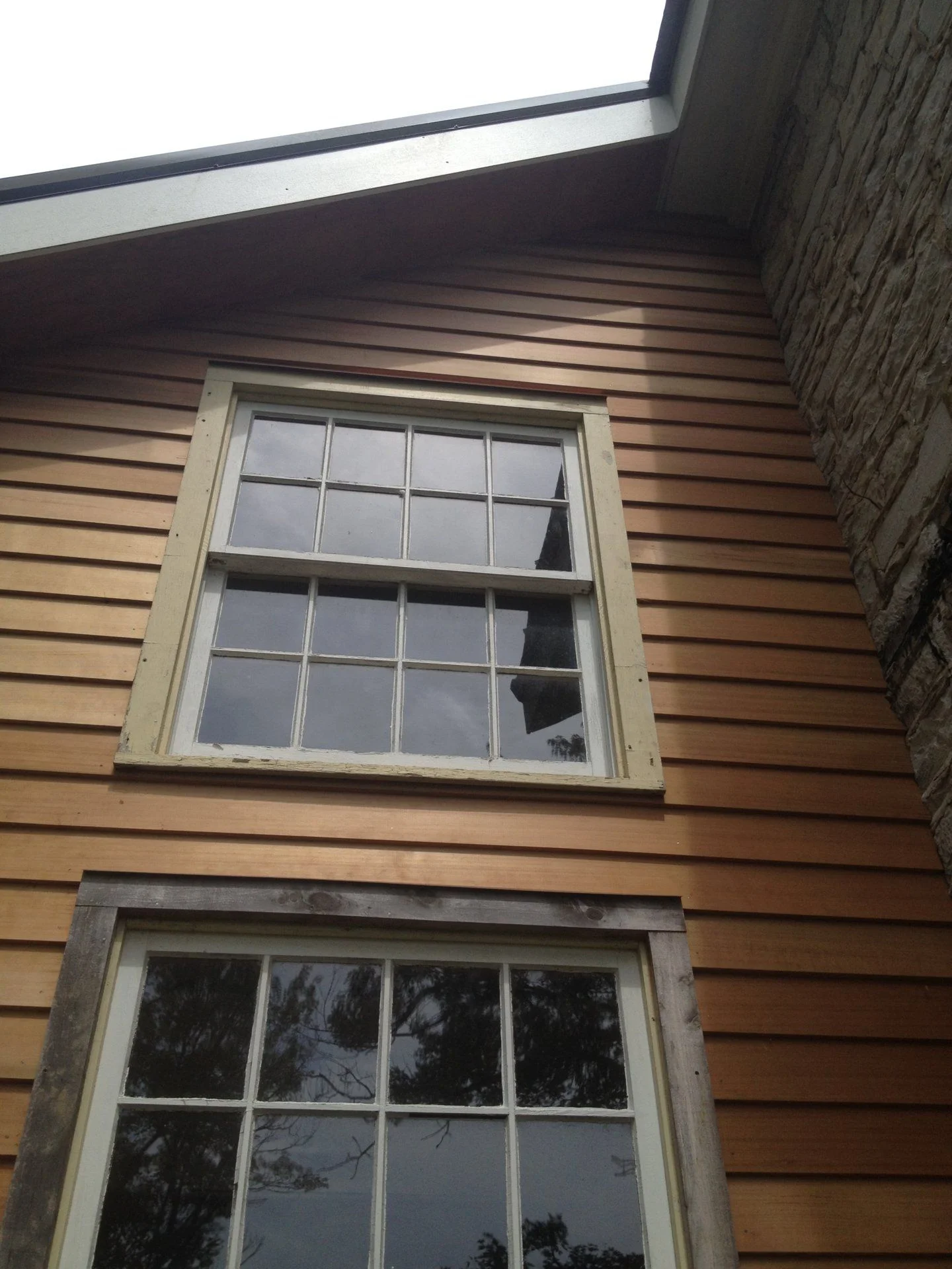

I did finish the siding on the kitchen bump out addition. The local lumber yard delivered some very nice clear western red cedar to my driveway. I was very pleased with the quality of the siding. I had some local eastern cedar on hand and used it to finish out the corners. Matched the corners and siding (Redwood) of the existing addition from the 1970's.

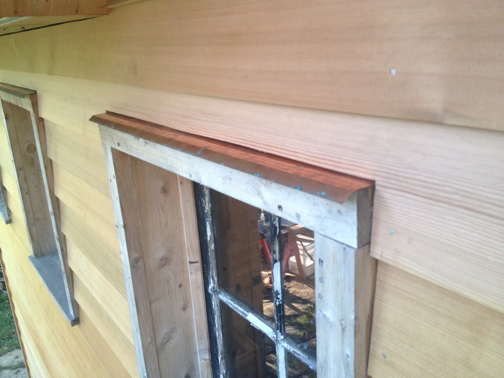

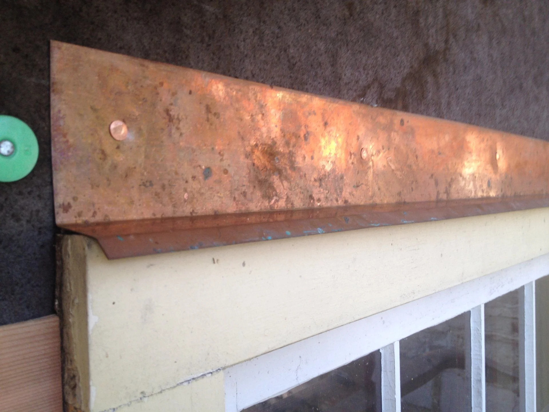

I found some copper flashing in the cellar of the house that was left over from when we (my dad) built the 1970's addition.
The window frames are made out of local cedar. Windows will be painted but the siding will remain natural. I intend to match the siding and window to the 1970's addition to pull it all together.
