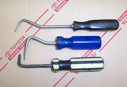

This is what I use. The black one is a Snap On, the blue one is a NAPA, and the yellow one I made from an old screwdriver. FWIW, to reassemble hoses I use WD40 for hydraulic, air and vacuum hoses, and a little liquid soap for coolant hoses if need be.

Thanks guys. Junk I must admit, I had never heard of a vacuum hose remover! Used a google search and found several styles! D'oh. No matter what, seems some search or the other burns my butt every time!!!! Just joking on myself! Thanks for making that as painless as possible though! Photo, thanks I would not have thought of those either! Sheesh, I'm sucking all around here aren't I? Seriously though, thanks guys.

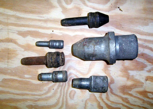

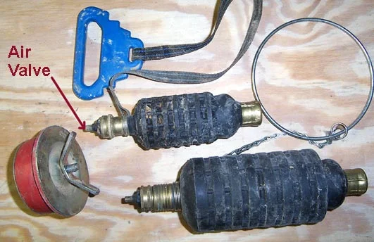

I wish I had that tool when removing my rad hoses. I had to use a adjustable wrench and I pinched the rad pipe. Its out of round now but hold water. Now I need to make them round again.
I looked into muffler expansion tool but its too big. Other than removing it and taking it to a rad shop, how can I get them round again?
I've been using my sharpened and bent screwdriver for that for years, didn't know it was the proper way!
Thanks Junk. Just the latest from CDan.
Kurt,
Here are a few ideas for you. They do make the exhaust expansion tools in different sizes, but as you said they may not go as small as the rad hose size.
Next are air operated test plugs for pipes. I have used them in the past to press back a pipe or tubing into round. Don't know the smallest size they come in. Care would have to be taken not to blow out the tubing. Also, in the pic is a wing nut expansion plug. Rad shops have them to do some of their tests. I have several but could not find them quick for the pic. Anyway, I have used them to return thinner stuff to round be putting the plug in, expanding it and then tapping lightly around the tubing, retightening, tapping again, etc. The drawback is in the depth of the plug.
Last are flaring tools for soft copper water lines. Lube the tool and tap in. Then could also tap around the tubing.
You could also try just a piece of round stock or maybe even a pipe nipple to use as a dolly to tap the tube back to round.
I don't have a stock rad anymore to measure the inside of the tube from. If I did and you liked the flaring tool idea, I could turn something for you (less the flaring part) on the lathe. Or you could have a local machine shop do it.

Go to Sears and get one of these:
They're only $7, they call it a Cotter Key Extractor.
