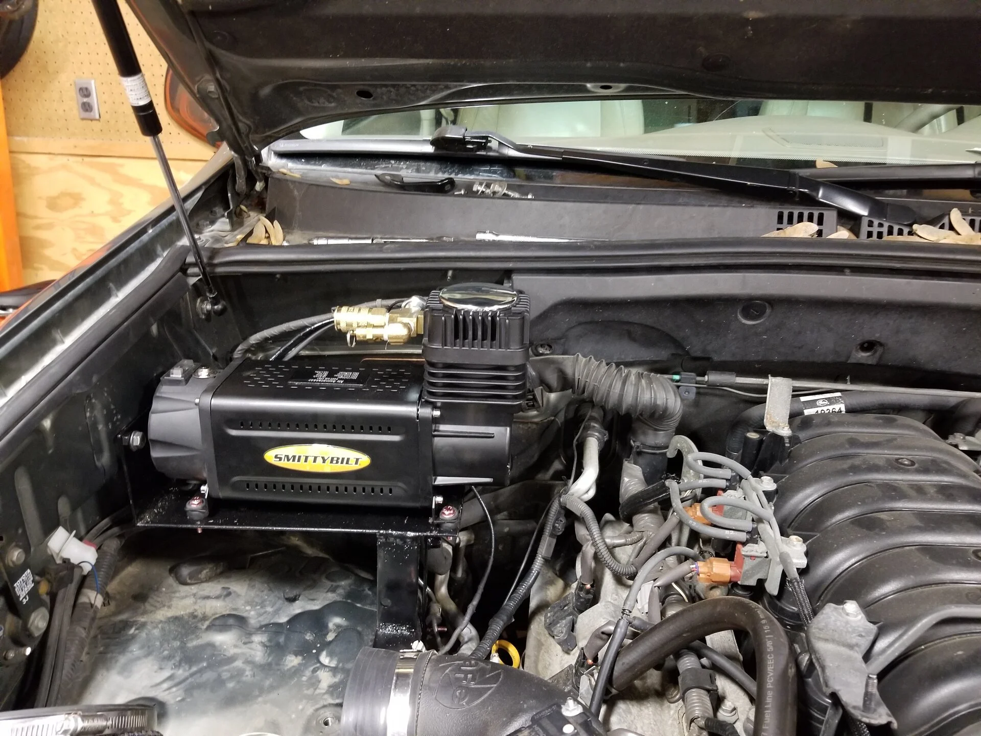

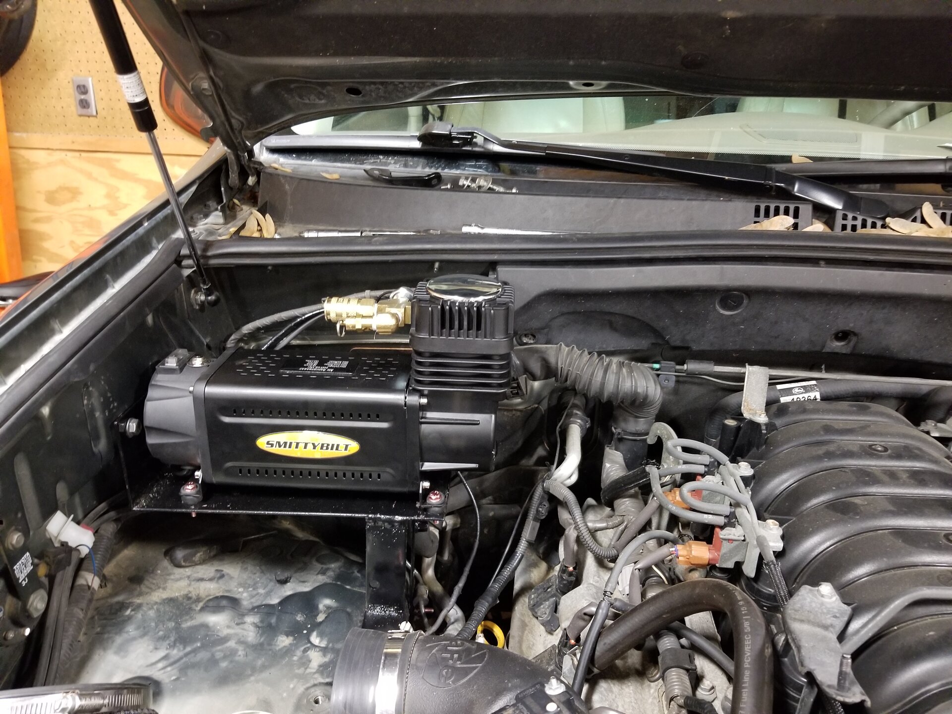

It's not hard to DIY your own bracket - made mine (for a Smittybilt) out of some 10-ga steel sheet using a cheapo Harbor Freight welder and grinder with a cutoff wheel.
It looks good and it seems your smitty built works good from another writeup you did. I think there's threaded M8 or M6 holes on the fender side? How did you attach on the wheel well side?
I added a couple of rivnuts.

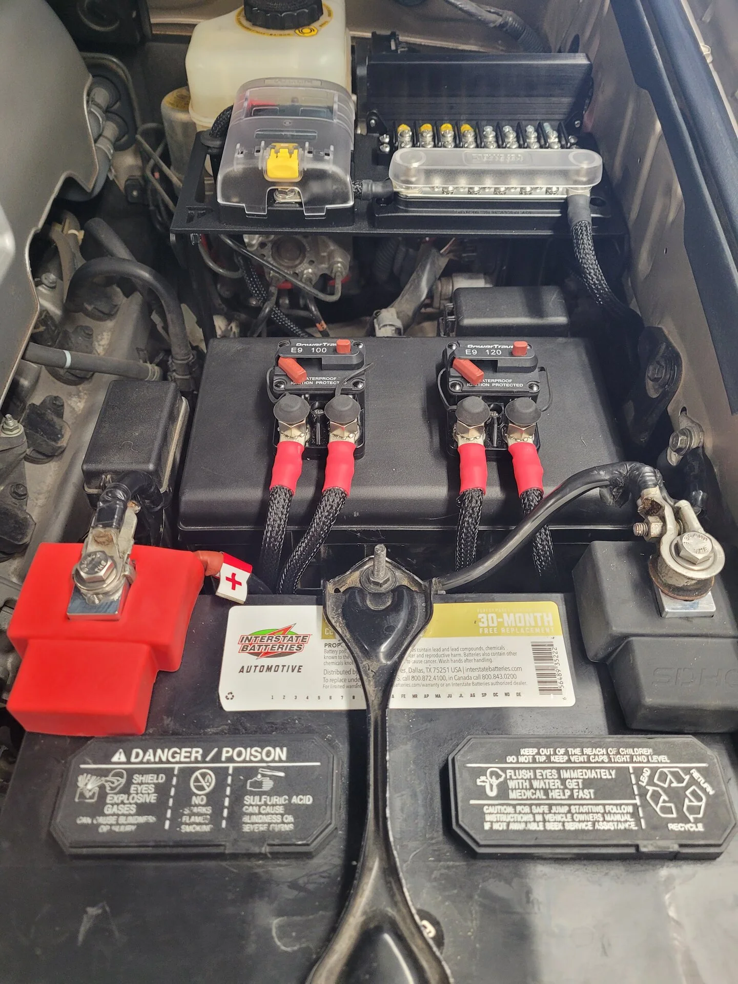

How did you wire it up? If you have a build thread on it I'd love to see.

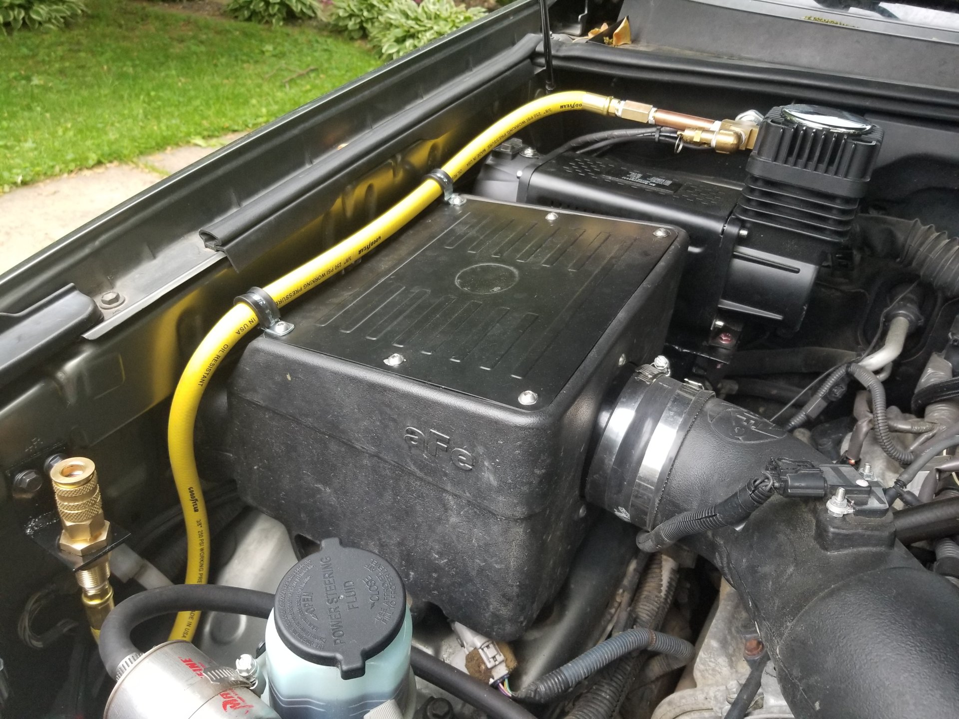

I think the other thread I saw with it had the airbox installed. Here a pic
Not sure if it will work with the stock airbox or not. More photos and wiring info are in my biild thread linked in my signature. An ARB would probably need to be vertical to fit in this location.
I prefer the brackets for driver so that spot can be reserved for duals and power distribution.
