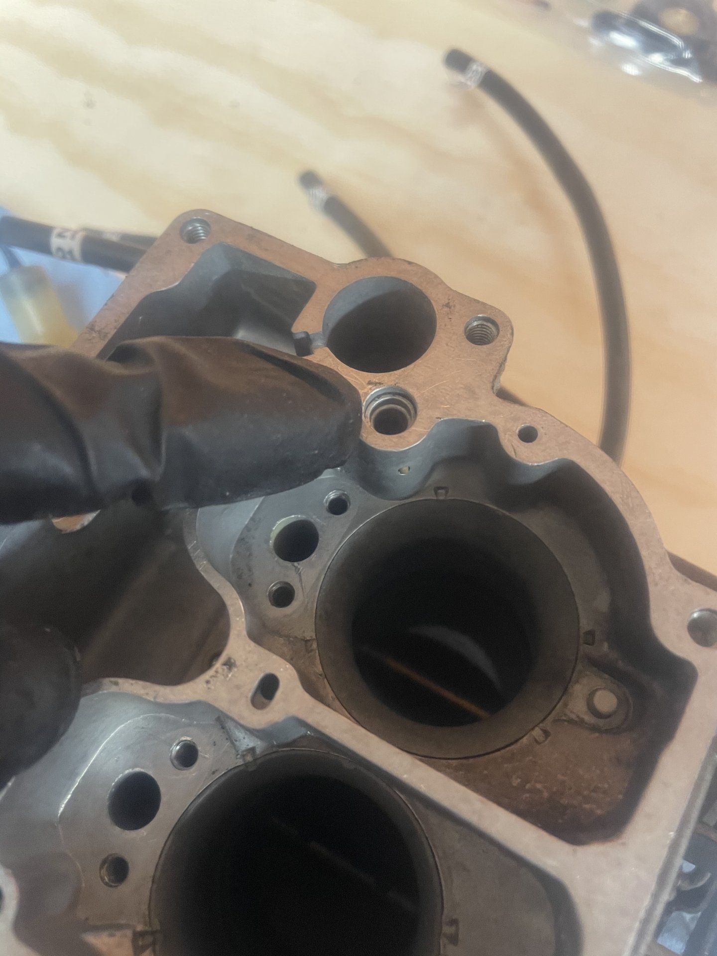

Hey all, title pretty much says it all. I have pictures.

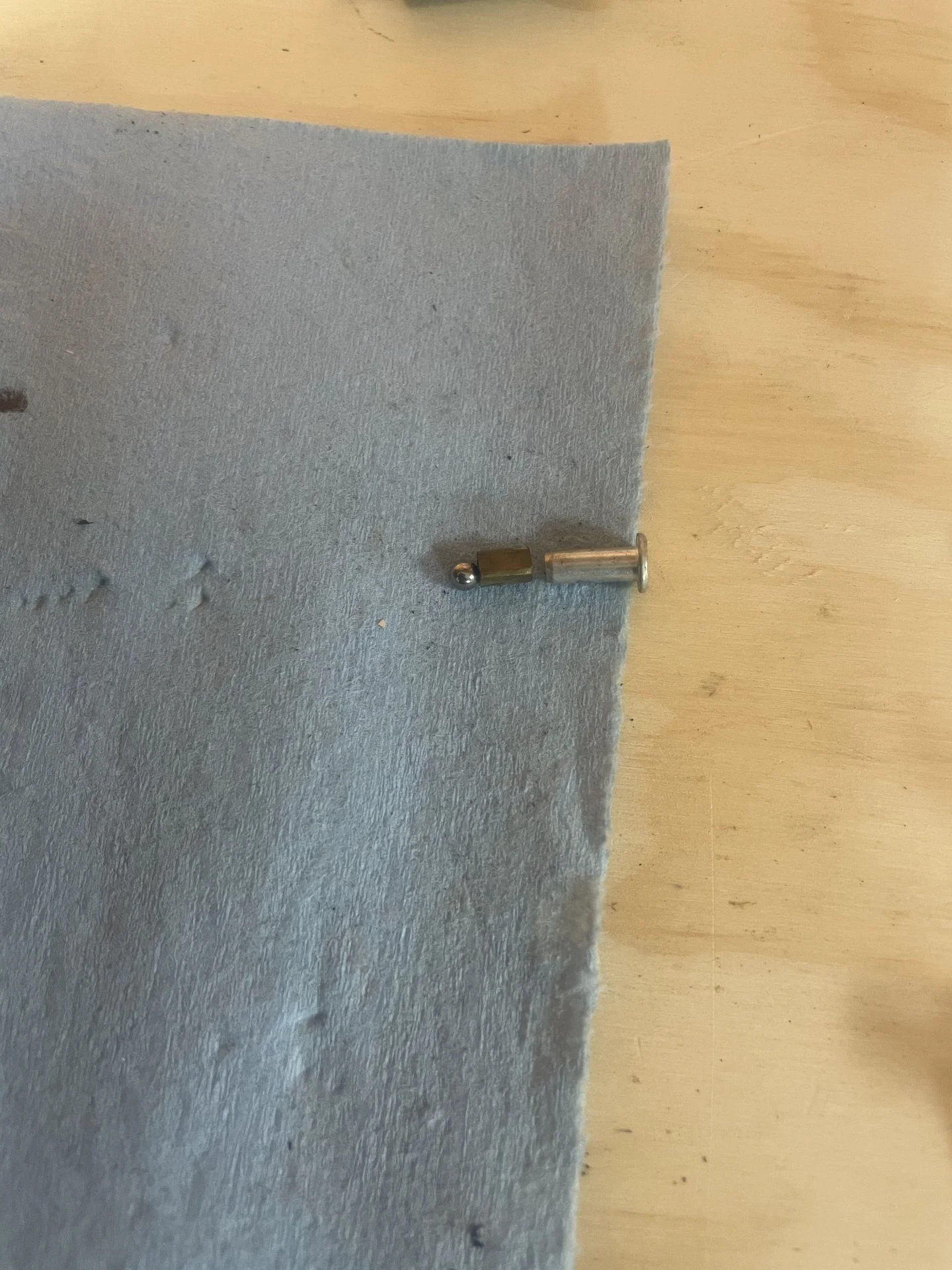

I think the three things fell out of the place I’m pointing to on the carb body, but I don’t know what order they go into it. (I’m trying to be very specific in my notes as I take this thing apart.
Weird thing is, the carb looks like 2F, but the stopper & discharge weight are from a 70-74 F carb.

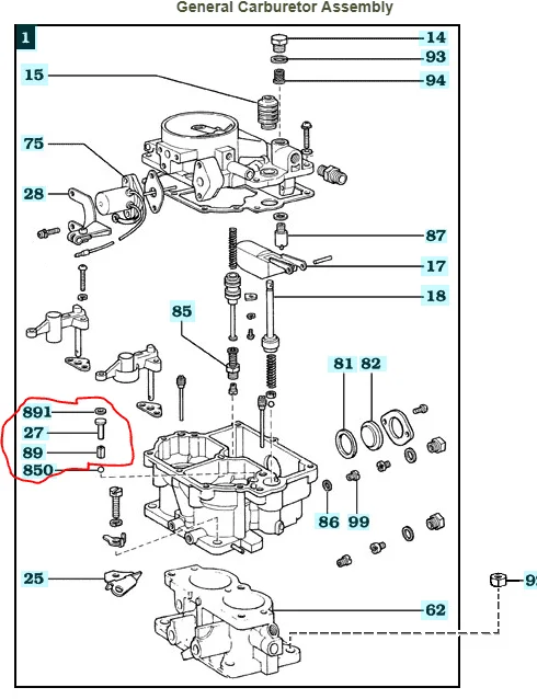

The concern is that somebody else has been in this carb and mixed up parts, so there may be other issues that are not obvious.
Oh damn. And my kit didn’t come with a replacement for those things (except for the ball bearing).
I finished the rebuild — I didn’t realize but I have the manual for the 2F engine which has basically a whole chapter devoted to the carb — it didn’t seem like anything else was out of order, but who knows with the jets and whatnot.
