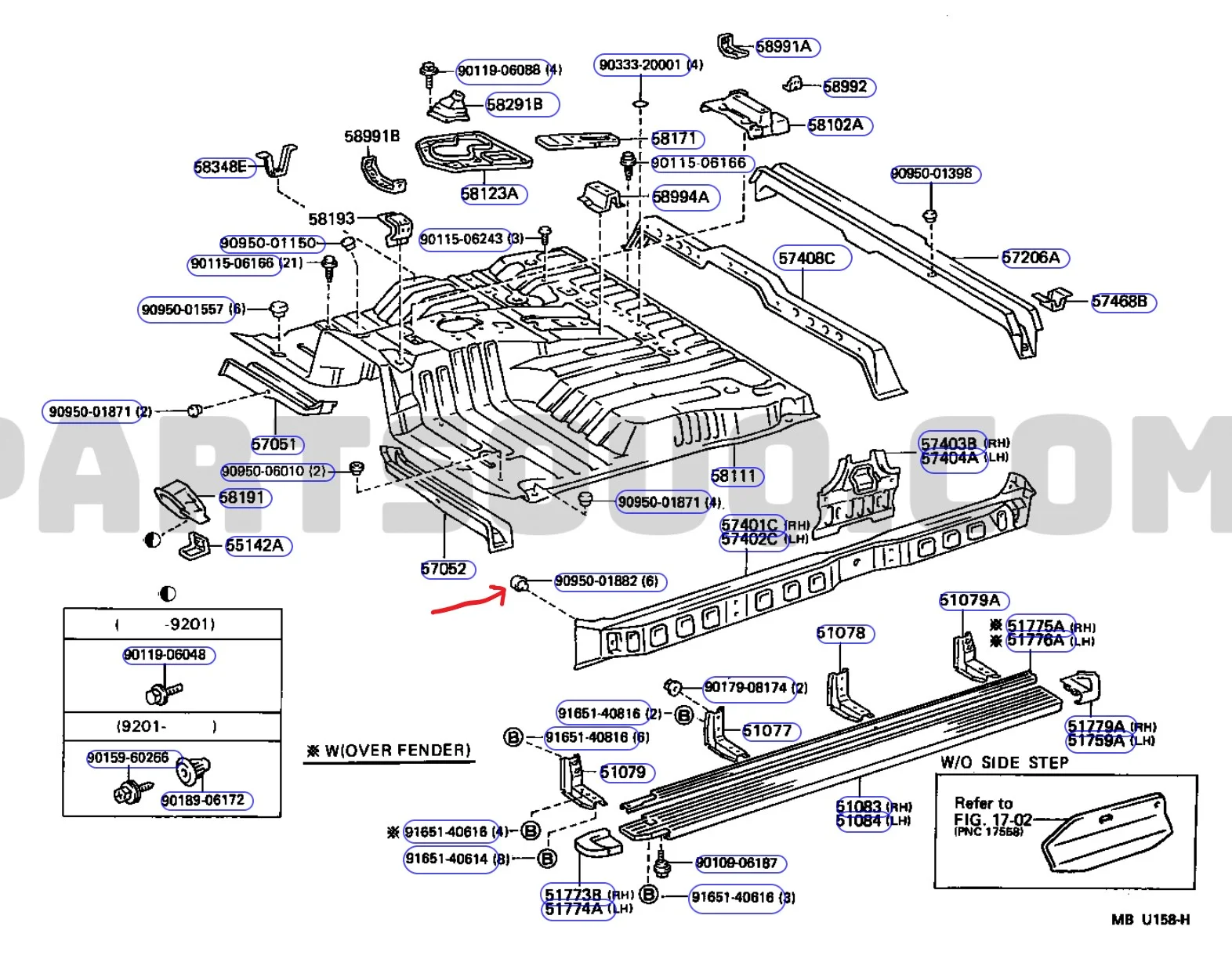

Using Partsouq dot com (enter your VIN first) you can find the rocker panel plugs under Body/Interior in their system then scroll down until you locate the group of parts you're looking for (Front Floor panel in this example). Or you can try a wide search using their Search function but IME it's a bit quicker to first start with the correct Group if you know that (or pick from the listed options).
Note next to the part number 90950-01882 (6) is a number in parenthesis, this indicates how many plugs of that type are required if replacing them all:
FWIW

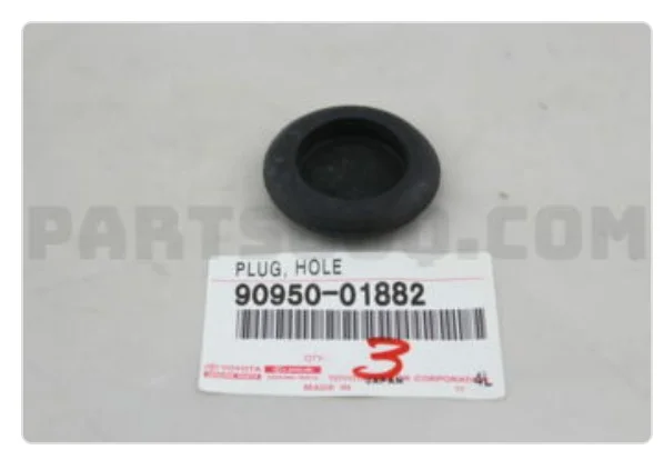

Larger rubber plug (mentioned in post #5) located on the back/inner aspect of the rocker panels:
If you go to Partsouq and look at the diagram above you'll find a few different size/type body plugs and decals (plastic stickers used to cover holes).

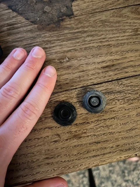

Thanks all so much for the help. Will use partsouq in the future. I believe it's the smaller plug that @Malleus mentioned (picture of the ones I pulled attached which I should've done initially). They're about 3/4" in diameter (the actual hole being about 1/2") and hard black plastic. There are four on the direct underside of each rocker. My passenger siderocker pissed about half a gallon of water out of one when I pulled it.
I mistakenly bought the larger rubber one mentioned, which is what led me to make the post. Anyways, many thanks to everyone for the help.

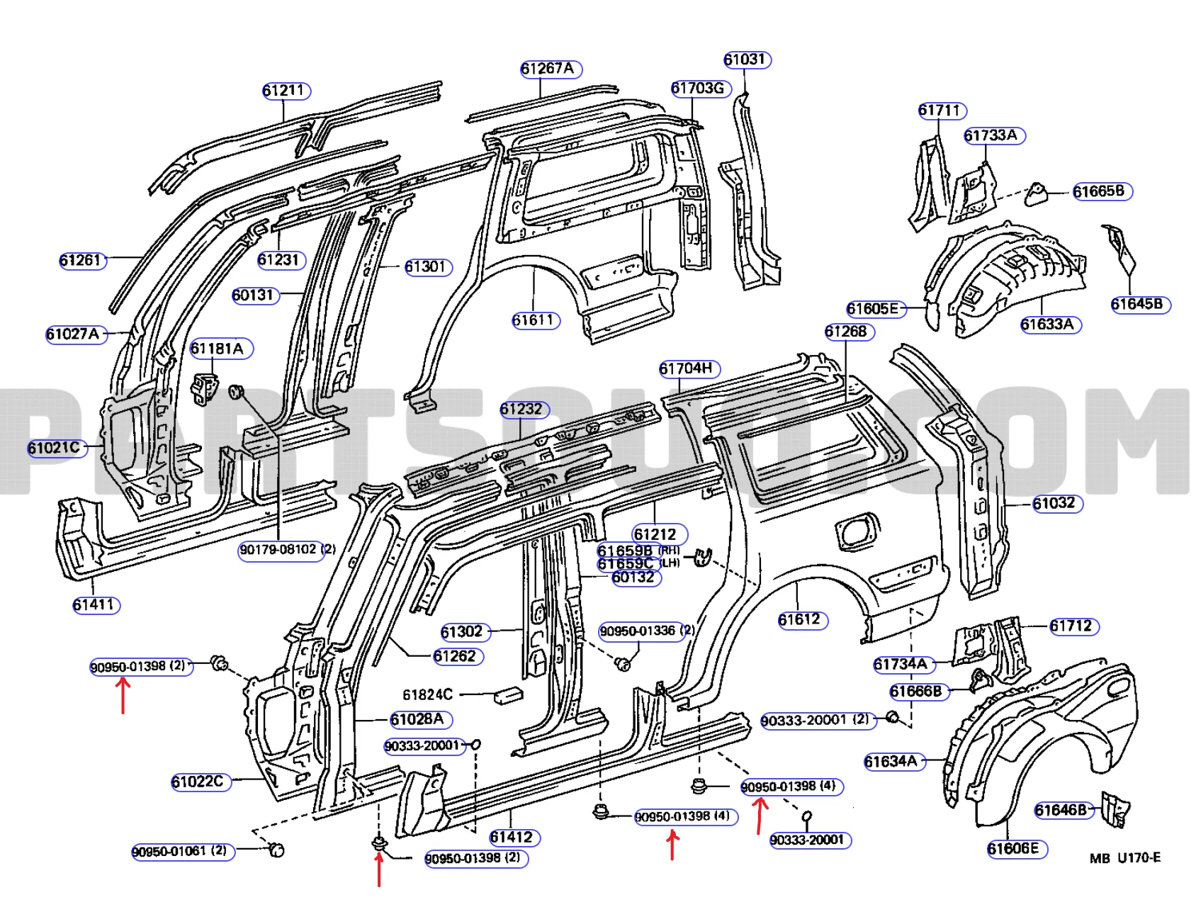

@wjbb : this is the smaller plastic hole plug found on the bottom of the rocker panel. FWIW to remove without
damaging the paint I use a pair of needle nose pliers and grab the small center section (not the whole thing), then wiggle, twist, pull. IME/IMO they should be replaced due to age/shrinkage/damage.
It's found in a few locations:
