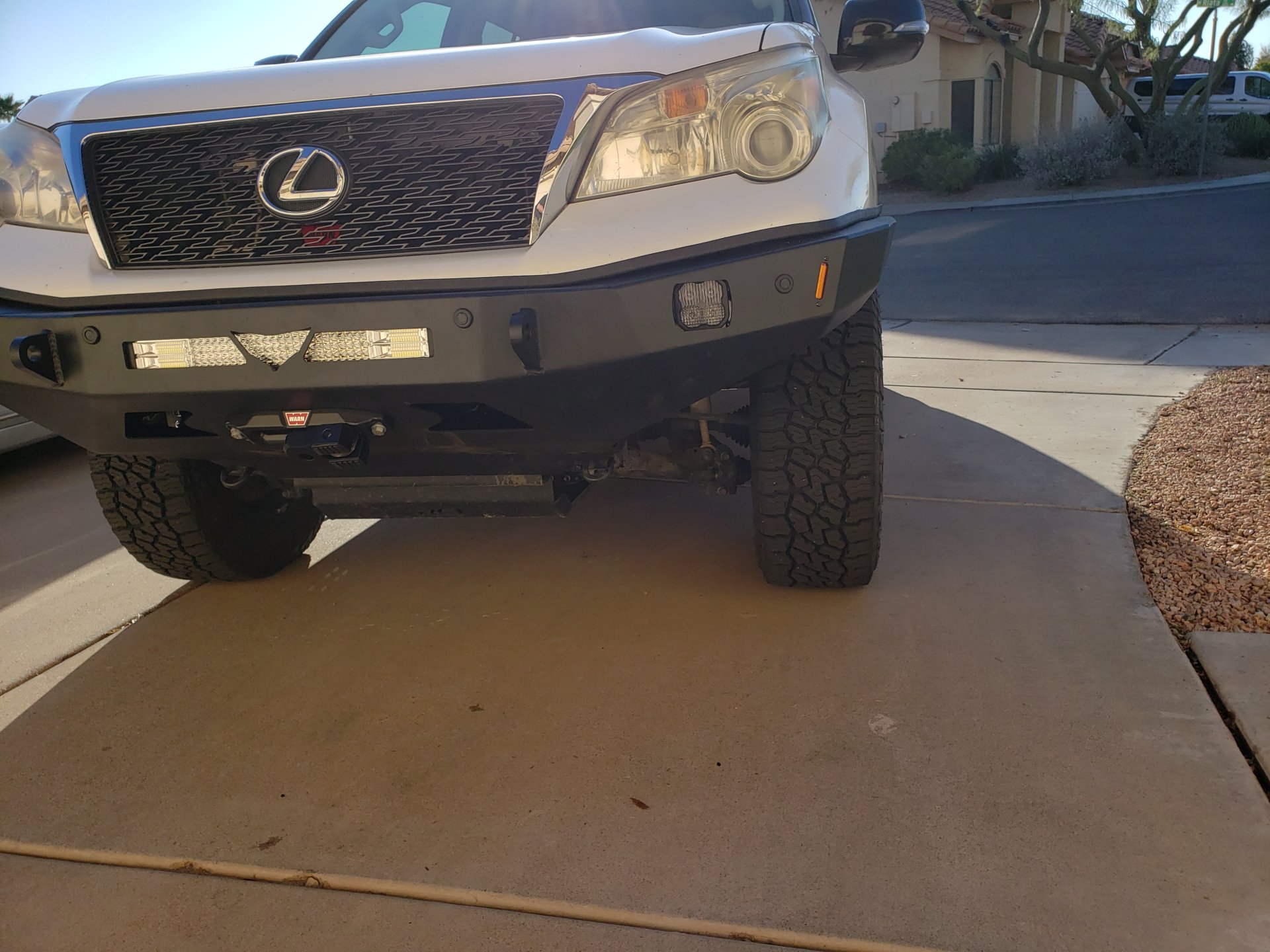

My GX is white pearl and I need to paint my parking sensors black to match my Victory 4x4 Strike bumper. Can I rattle can these black? Recommended paint? Tnx in advance

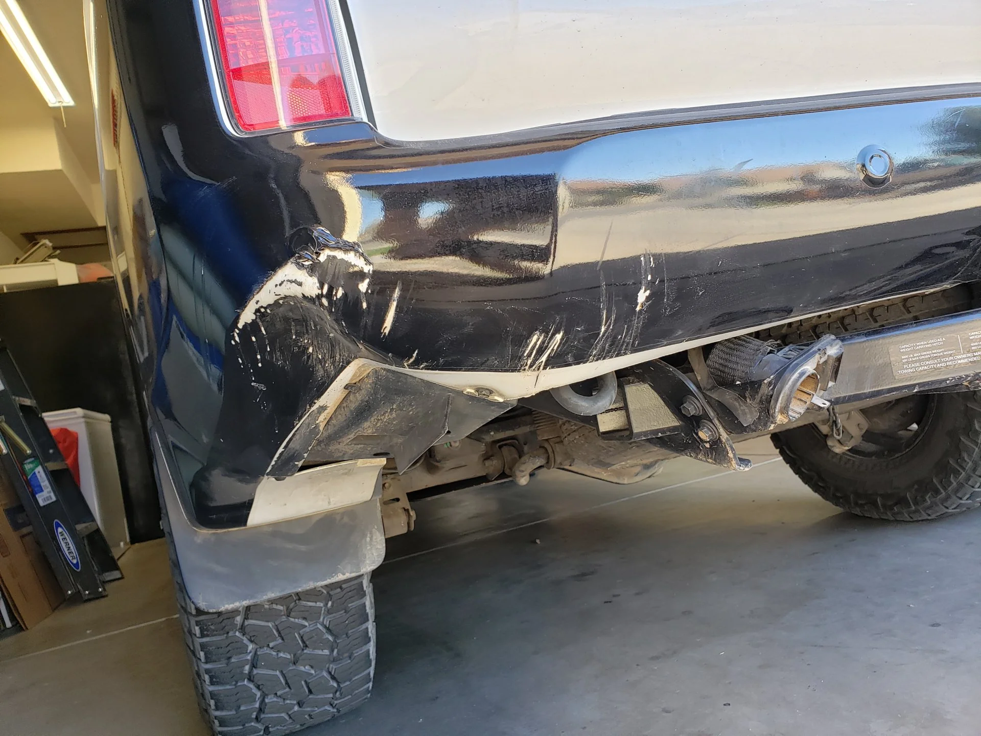

You know what REALLY screws them up more than paint? Not having a steel rear bumper...

I just rattle canned my white ones black. Works ok. Can't remember if I used wheel paint or bedliner...View attachment 3044900
Just checked, my fronts are rattle canned with black bedliner. My rear ones are covered with black vinyl. All of them function just fine.
