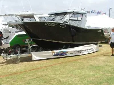

Just a couple of pics of aluminium boats that I have helped paint. I don't think they look to ****ty:flipoff2:. The black one just came second in the Australian Marine Awards Boat of the Year.
The trick with painting aluminium is preparation.
Use a good quality two-pack etch primer and then use good quality two-pack paint.
At the Boat Shows the first thing everybody does is tap the side of the boat because they don't believe it's plate alloy.
It takes a lot of elbow grease but the results are worth it.
