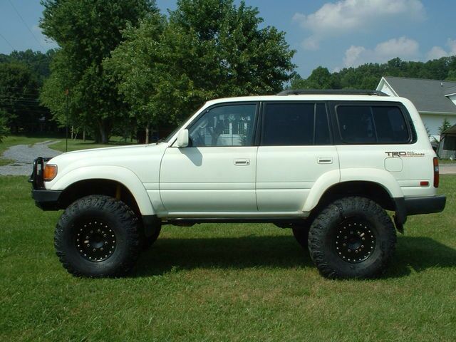

My paint is slowly but surely fading away. The clear has deteriorated so badly on the hood I can wipe it off with my hand. I still have a paint layer underneath that is holding up well but I am looking for a long term cheap solution.
Here are the options so far:
1) Monstaliner - they offer a blue that is a perfect match and it is cheap.
2) 50/50 - below body line will be monstaliner. above body line will be paint.
3) Clear - just clear the whole thing and stop the fading.
4) Peach/Maaco paint - IMO faded factory paint is better than a Maaco paint job.
5) Patina - leave it be until the rust starts. Long term care involves removing the rust and painting it with the first can I grab.
6) A REAL paint job - $$$$ and likely to be covered in scratches. This is what the wife wants but worst option.
Just looking for opinions.
