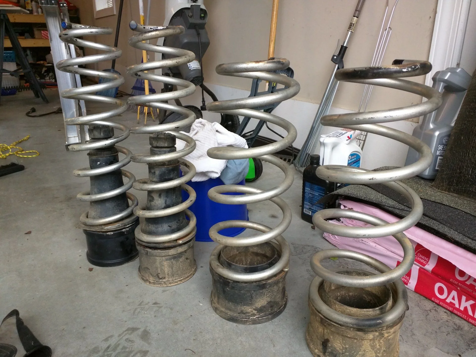

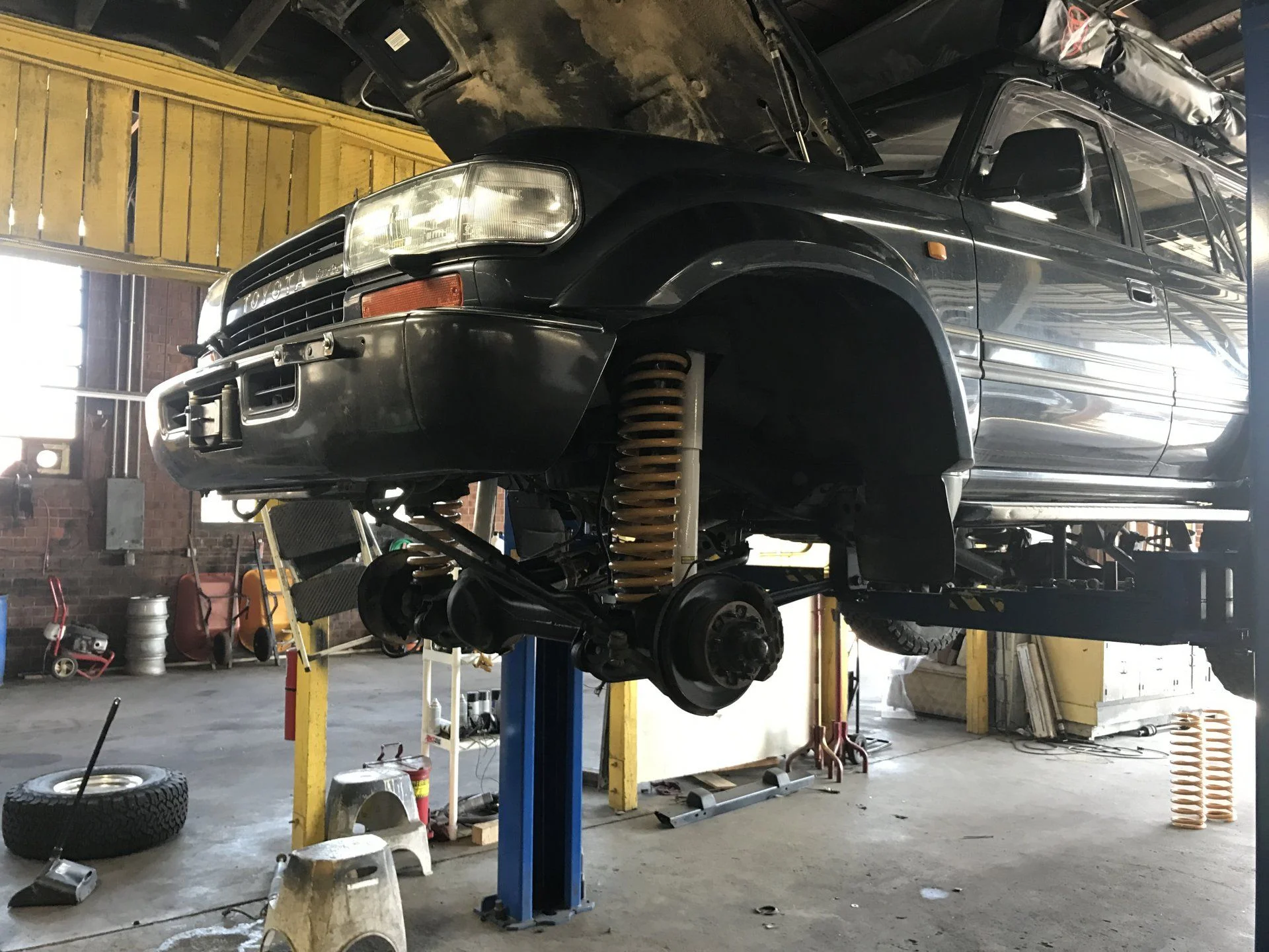

Springs n things, @CharlestonG8R . Finally got the Ironmans installed. I neglected to actually measure the spacers I had on there before, which were 4".
These 6" heavies add a little more than 2" to previous. I think the ride is ok, but will probably be more stable when fully loaded up and if I ever get armored.
Ended up having a place in HKY do the work since I've kind of been taking it easy since I got my backeotomy. I may have to do some work to improve the handling. It's a bit floaty/dodgy on the highway. Luckily I already had all of the drop brackets and adjustable panhards.
Whohoo!! Love build threads.
Looks like you've got a bunch of rake. Was that planned?
Looks like you're ready for bigger tires :steer:
haha yeah, @CharlestonG8R warned me about that. I guess in the 6" they only make super heavy spring rate for fully built rigs. I do plan on armoring up and loading out for trips (you've seen how I pack) and the springs will help with towing a full trailer, but it is a bit much. It's even getting hard for me to climb in.
I thought the same about the tires as soon as I saw it. It's unavoidable at this point, really lol. I don't want to de-flare etc. yet though, so I think I will stick with the 35s for as long as I can.
haha yeah, @CharlestonG8R warned me about that. I guess in the 6" the only make super heavy spring rate for fully built rigs. I do plan on armoring up and loading out for trips (you've seen how I pack) and the springs will help with towing a full trailer, but it is a bit much. It's even getting hard for me to climb in.
LOL! Yeah, that was exactly the problem I had! Those are some seriously stiff springs. You should have seen how ridiculous my 33's looked... Just a thought, you might see if you can get some of the stiffness out by adjusting the panhard rod... Marshall mentioned that mine was extended too far and it should have been brought in a bit. We adjusted the panhard after we found where the springs relaxed, but maybe that was wrong?
Thats some LIFT! Have you checked post work caster? Overall alignment is a good idea, panhard rod is also a good idea as you have that frame farther off the ground. How about driveshafts angles? Pinion angles? Anything else you should review?
I think since I went from a 4ish to 6ish everything was reasonably close. The shop installs lifts and seemed to have an idea of what they were doing, though they don't really work on cruisers. I haven't looked too closely at it, but the handling is close to how it was before, just a little more tipsy. The ride isn't too rough. I would like to tweek on it once I figure out what to do. I was reading some of Slee's tech stuff today. I may spring for their lower control arm$ (pun intended) after I donate plasma a few dozen more times.
I do need to check everything over, angles and travel. It already had all of the drop brackets, but I need to verify breather lines. I don't really have any vibration in the drive line (it's actually a bit better than before. I got it aligned and it is better than pre-shop. I need to get some double cardan action going on up front. I do get some shimmy when steering right at 40+ mph. I know I could chase that forever.
