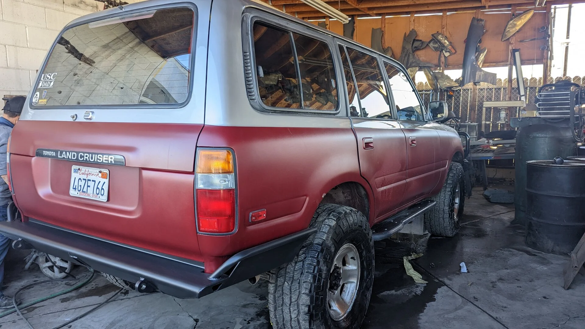

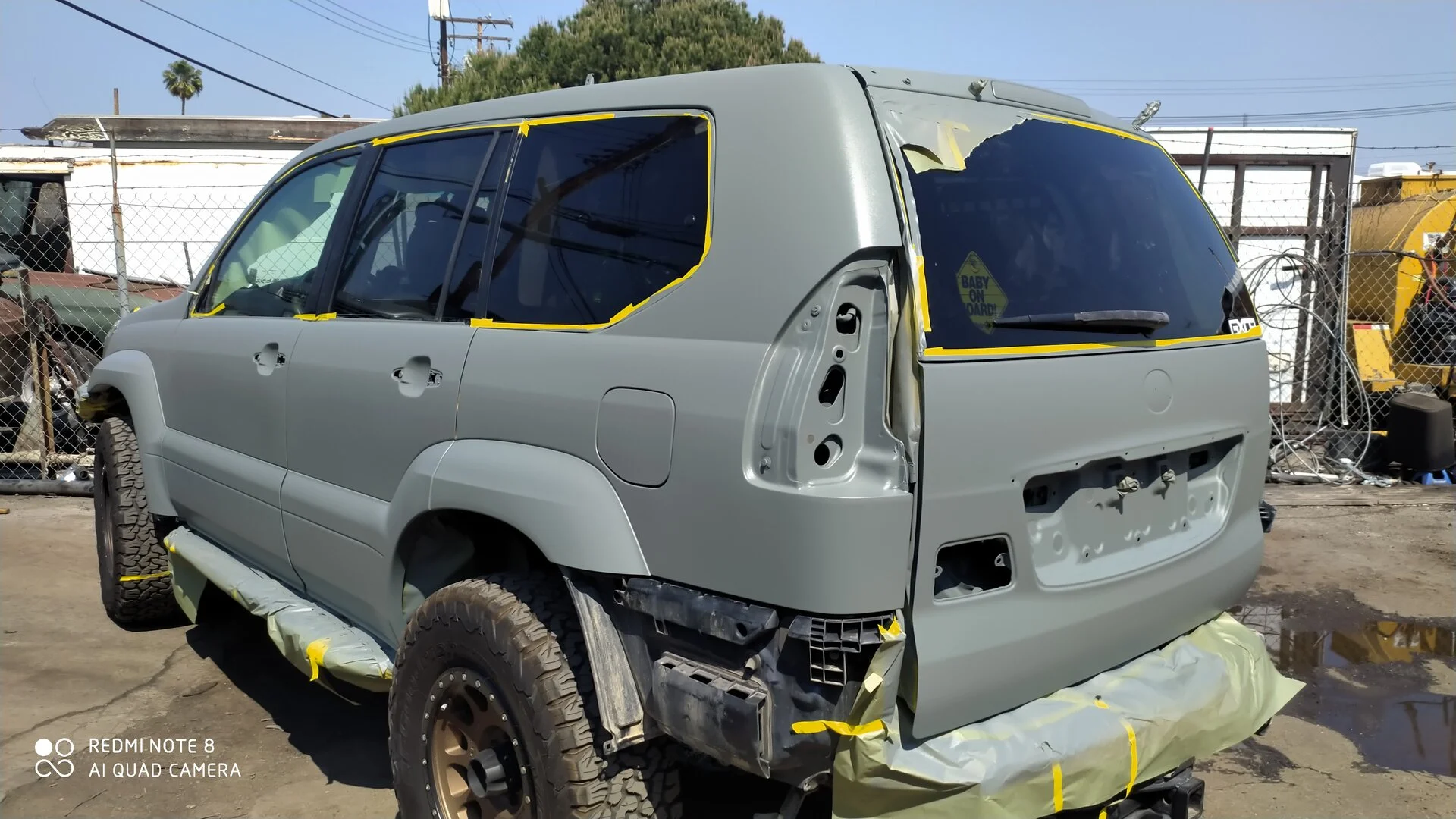

This one is one of Mud member. flare delete, 10 hr of bodywork on quarter panel from rubicon, dual tone with silver and raptor linner red.

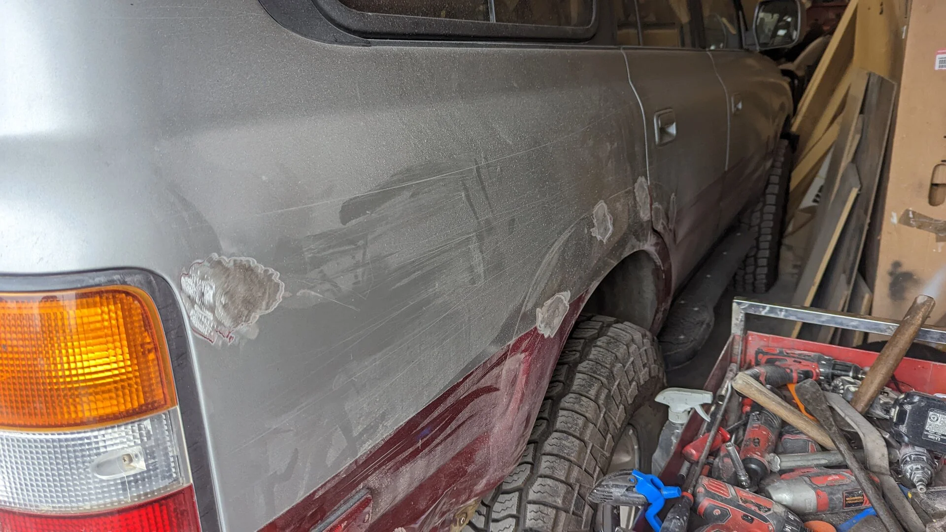

@azngarage Good to know! Approx time and cost to reintstall OEM fender flares using all OEM parts? I have all the OEM parts in hand to reattach all four flares including the gasket.

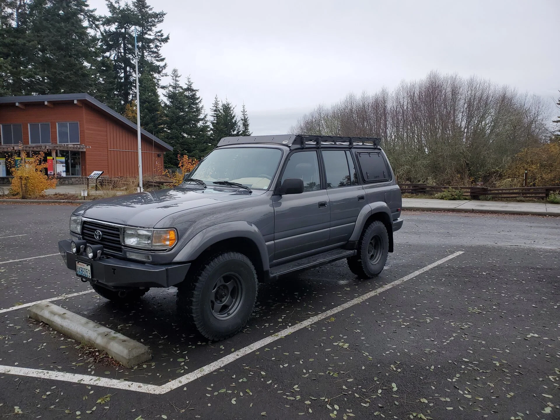

I recently had my 80 repainted (original Moonglow Pearl), glass removed, new seals, they had to remove 2 prior repaints that did not adhere well and the clear was peeling. Had 15 hours or so of body work and no rust at all. Good southern Cali truck. We started at $12,000 ended up at $15,000 and it's pretty good not perfect which is what I wanted, perfect costs $$$$$. And I was fairly confident going in that I had a no rust and no major body damage to repair and I was correct. I would do it again. It's still worth more than I have into it,
in my eyes
I recently had my 80 repainted (original Moonglow Pearl), glass removed, new seals, they had to remove 2 prior repaints that did not adhere well and the clear was peeling. Had 15 hours or so of body work and no rust at all. Good southern Cali truck. We started at $12,000 ended up at $15,000 and it's pretty good not perfect which is what I wanted, perfect costs $$$$$. And I was fairly confident going in that I had a no rust and no major body damage to repair and I was correct. I would do it again. It's still worth more than I have into it,View attachment 3217933 in my eyes
