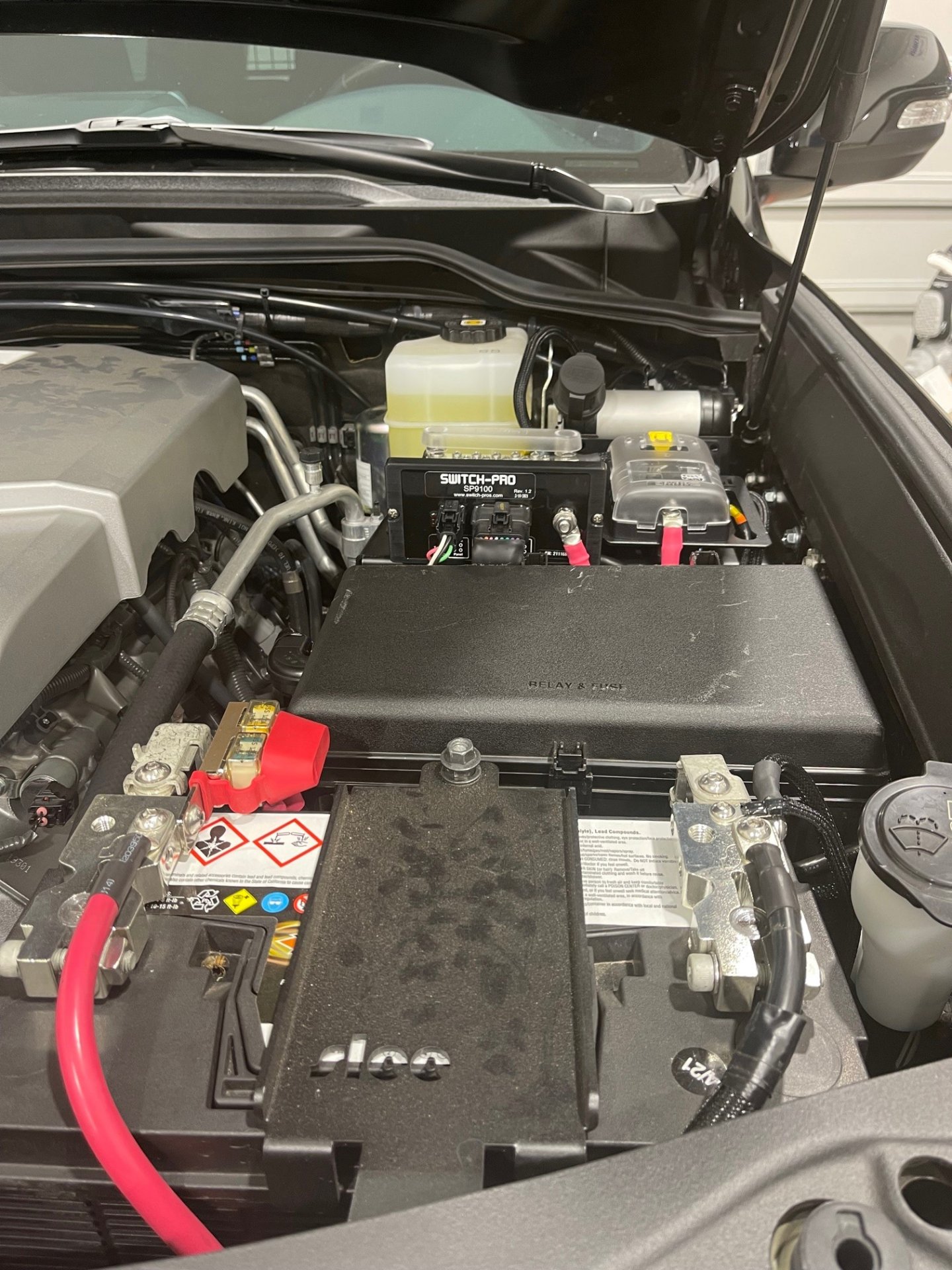

A number of people are using the SwitchPros block which is a solid state system of relays with a bit more logical available. I agree with you on minimizing power takeoffs with add-a-fuse taps. I would prefer direct of Battery with a relay to control its on/off. Some taps are useful, not for powering, but for tigger signals. These I try to place on less critical circuits .. lets not reduce reliability. I too ran a 4 gauge to passages rear fuse block. Mine is relay controlled from a SwitchPro switch, intent to be able to cut all power if some unexpected drain. This fuse block powers the USB and power outlets in cargo bay, L & R sides, back side of drivers console and a lead for either roof or rear for auxiliary camping light outlets. Freezer power is run fused, but unswitched from (pending install) Aux Battery with a switch over to Main battery in event of powerless (i.e. redundancy 15 amp circuits)

One idea - throw a silicone boot over the exposed power lug of your switchpros and your battery terminal extension. I've seen wrenches turn into welders inadvertently.

I run a similar setup with future plan to fit a 2nd battery on LHS as Aux.
I run a SwitchPro (of Main Batt, Later Aux) which controls aux lighting: Light Bar Hi/Lo, L/RH Scene, Rock, Rr Flood, RrFog & Rear Power Relay
Rear Pwr Relay feeds a 4AWG run to rear for cargo bay power & USB outlets, center console USB's and a power run to roof top for RTT outlets.
ARB air compressor, DC-DC charger, underhood lights, fuel transfer pump, fridge, backup lights, etc run direct off Terminal fuse bocks & small ATC fuse blocks
