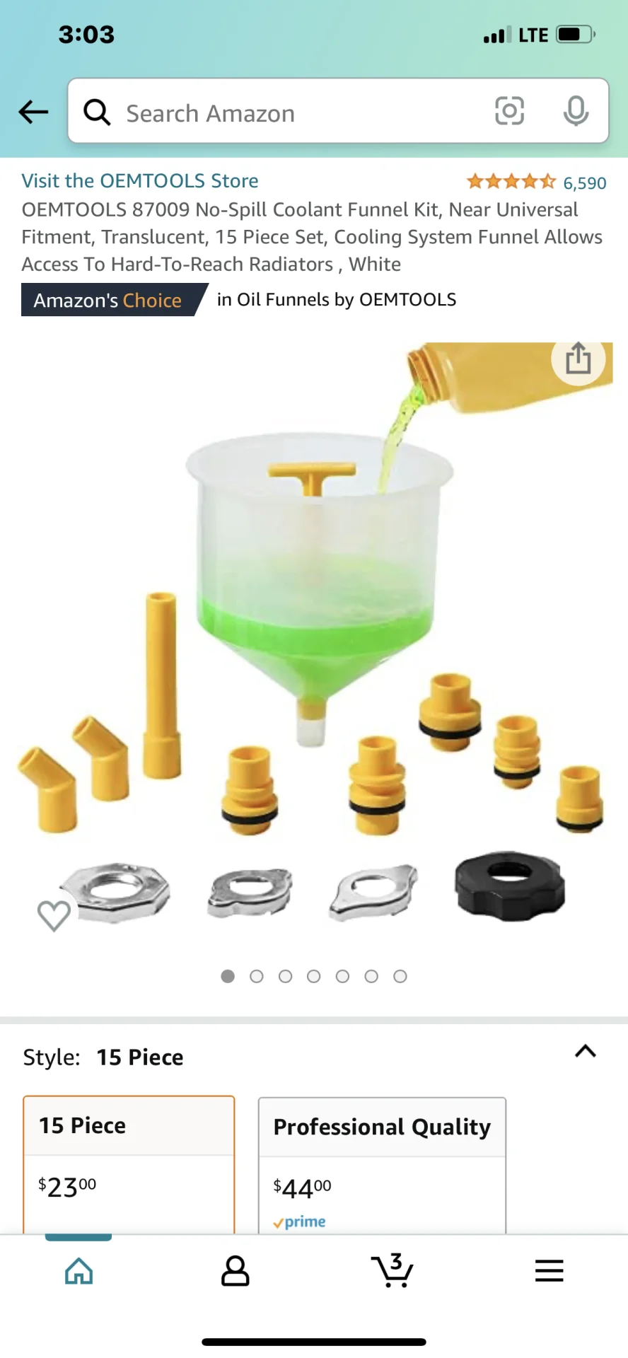

Are you sure your thermostat opened all the way also if you didn’t get all the air out that can cause issues. If you jack the truck up and run it it sometimes helps with the air getting out. I prefer a coolant filler funnel they work great bleeding the air out and don’t make a mess.
Im going to add that even parking the truck on a sloped driveway/street with the engine on the high side will help be sure you have all of the air out.

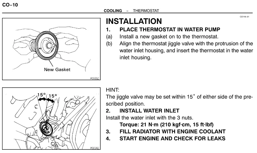

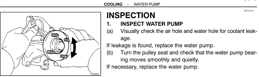

Could be a few things, first thought is your t-stat is acting up or not opening consistently (may be installed upside down or out of the 15deg range either side of the prescribed position?). If that's not it, my second thought would be to check the internal blades and bearing condition of the water pump. Either way, sounds like you are going to be draining the coolant again. I would suggest draining the block this time also.
This is from the FSM...
