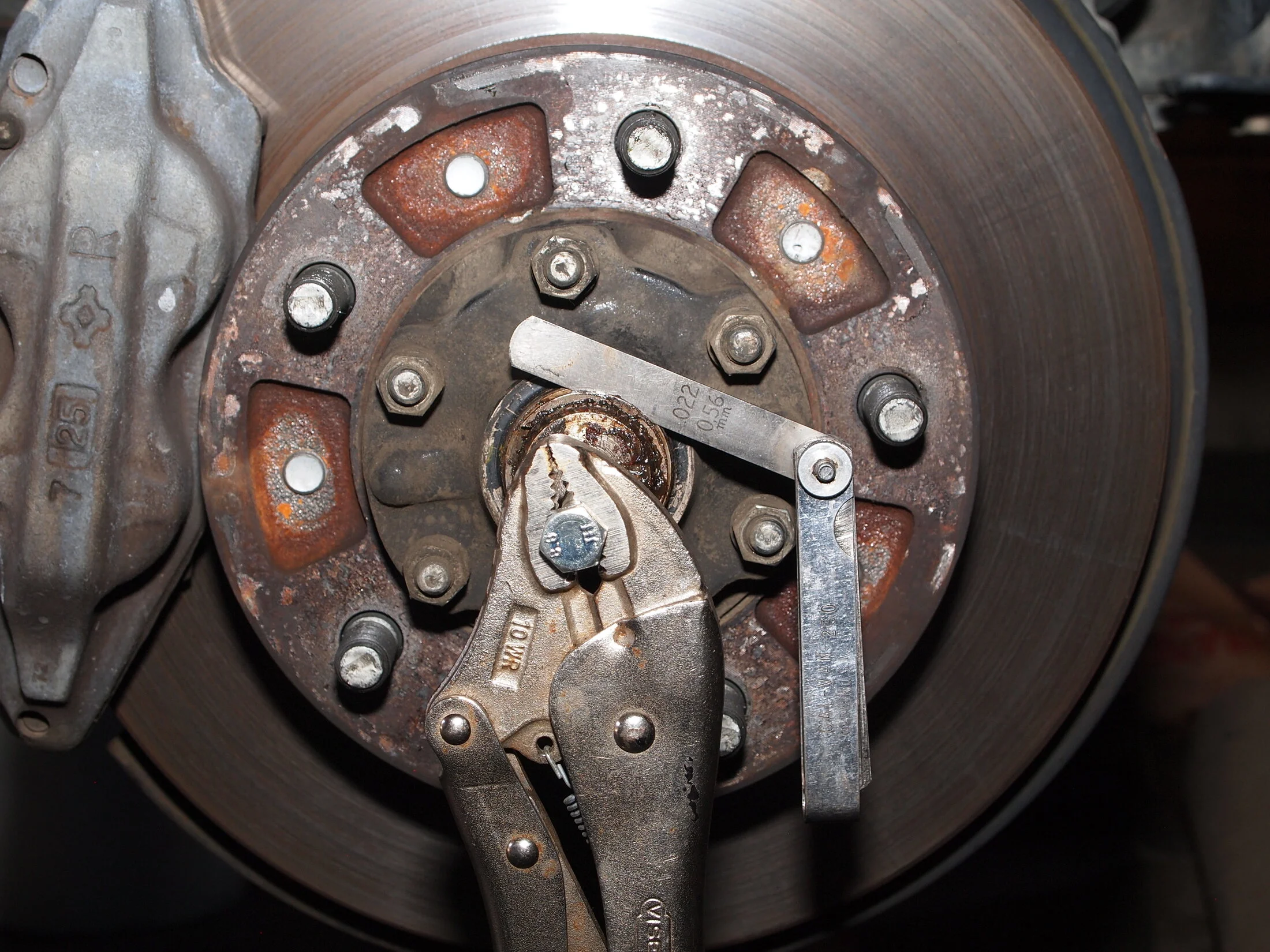

Setting snap ring gap, after driving to settle grease with tire/wheels on the ground or jack under LCA, holding weight of vehicle to push axle out. We only need to pull out on axle, with a 8x1.25 bolt.

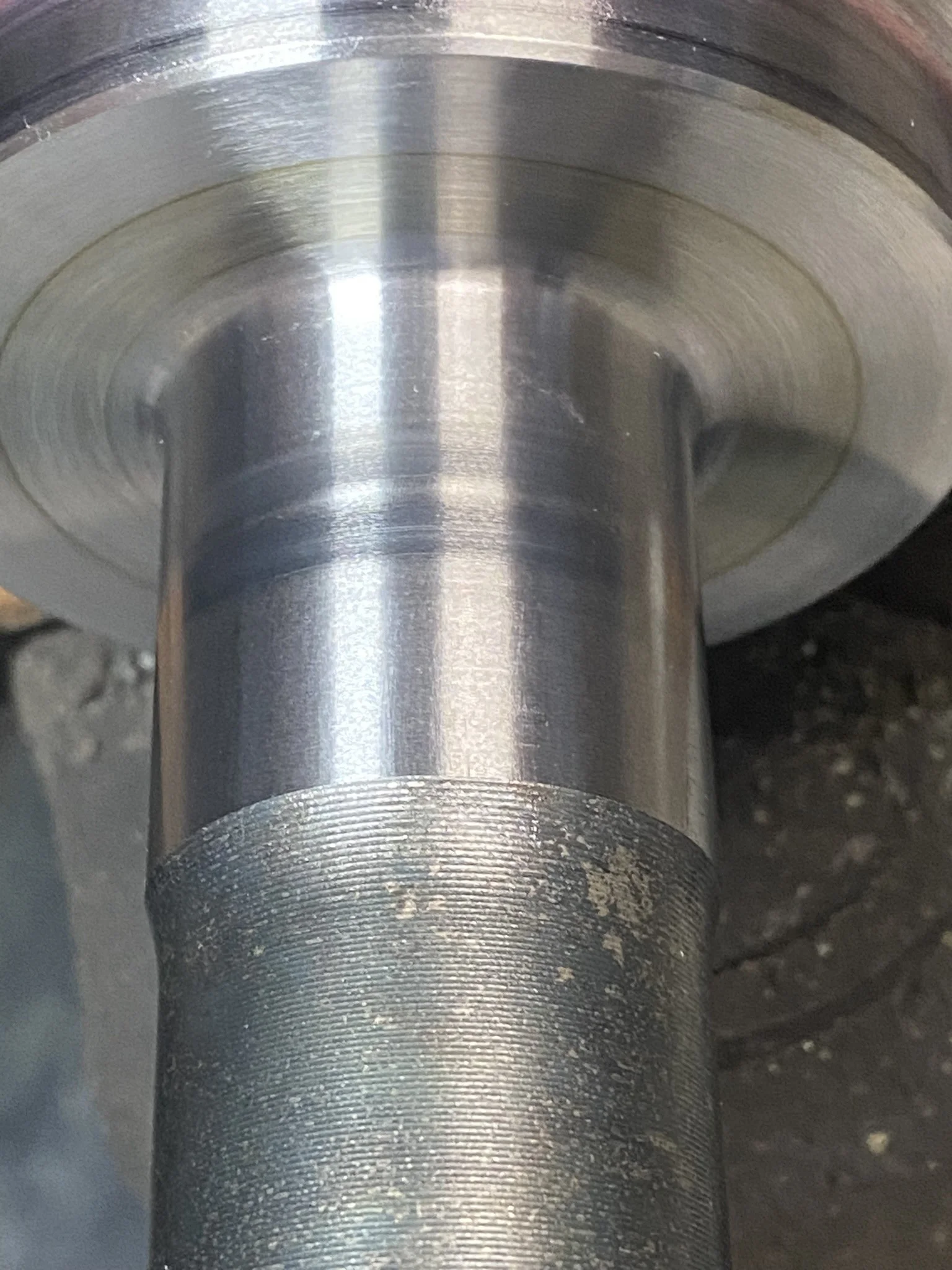

Axle needle bearings condition, are very hard to make the call if good or bad. Axle scoring, is best clue, in making the call. This FDS has ~2K miles on it. You can see where needle bearing rode and brass bushing butted.
Notice the scoring where needle bearing rides on axle. It's uneven shading for one and ride in narrow bands. Needle bearing was passed useful life.

I knew I had made the snap ring gap extremely tight. If fact, I had to tap in to seat in groove of axle. Tapping on having zero gap, is not a good idea. But the only thing that happens, is brass bushing wears until there is some gap. But thinking brass bushing may be making the rub sound. I checked gap after about 1K miles, which it now had some, before pulling knuckle again.
Note: Snap ring gao of >0.20mm, keeps FDS seal pulled into knuckle seal properly. Making water tight seal!
I had looked at outer axle of FDS, where needle bearing rode. It look okay at first. But later, I went back and reviewed the axle picture above, which only had 2K miles on it, I then saw, I missed the scoring. I replaced the needle bearing and sound gone, finally.

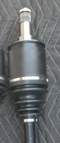

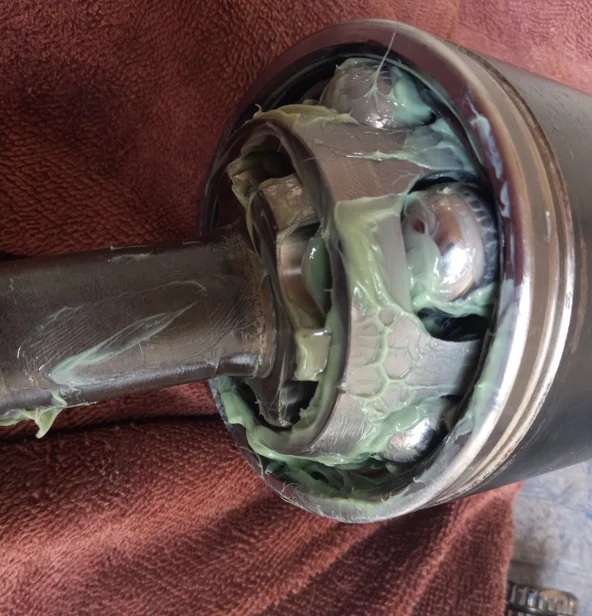

No movement other than me being able to feel some micro fractional amount of play behind the CV boot from the Rzeppa ball and cage.

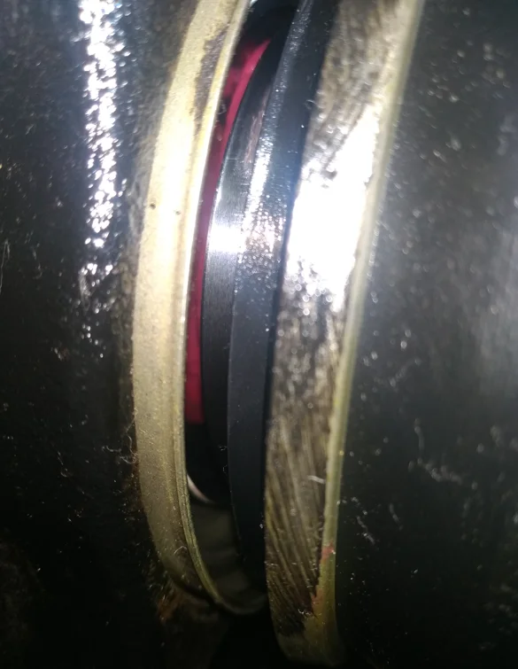

The inner snaps into place with c-clip. I would need to use a pry bar to cause it to shift -- under load.
Thanks…I just checked mine again. I’m going to say my small amount of play is in the cage area shown in your picture. Upon further investigation, it seems I may have a bit of up down play in the outboard shaft where it goes through knuckle. Toasted needle bearings / spindle?
