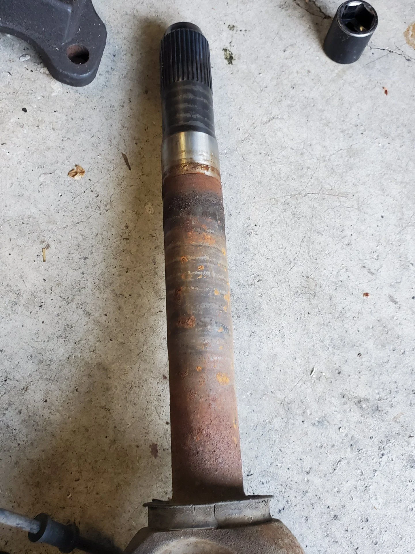

The long PS axle did not want to release at all... had to bang up the knuckle/bearing dust seal to get it to pop. Even then it was 20 minutes of constant pressure on my huge bar. Had to go and double check there were no c clips holding it in.
Short DS outer seal had failed at some point hence the surface rust on the axle. But the inner more important seal is fine so the diff is still ok. Going to put it to the side, order all new seals and bearings, cut away the mounts and expose more tube for my new mounts. And then wait for the rear and then more money for lockers and long arms.

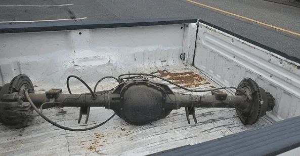

Going to pick up the matching sterling 10-5 rear for this front axle tomorrow.
I gave myself a few weeks to try and find a locking rear from a 11+ but for all the 100s of people saying they picked up one for under $500 the absolute cheapest I could find was $699 and most were over $1k
But the good news is I found out you can order a brand new locking carrier from ferd for only $450, if you shop around. Watched a few videos on installation.... might be time to get my feet wet with setting up a third member.
So $50 for the axle and $450 for the locker... will make street driving on such a short wheel base that much better. I should be able to sell the current locked axles for enough to cover the purchase of an ARB for the front, or the new arms needed for the swap.

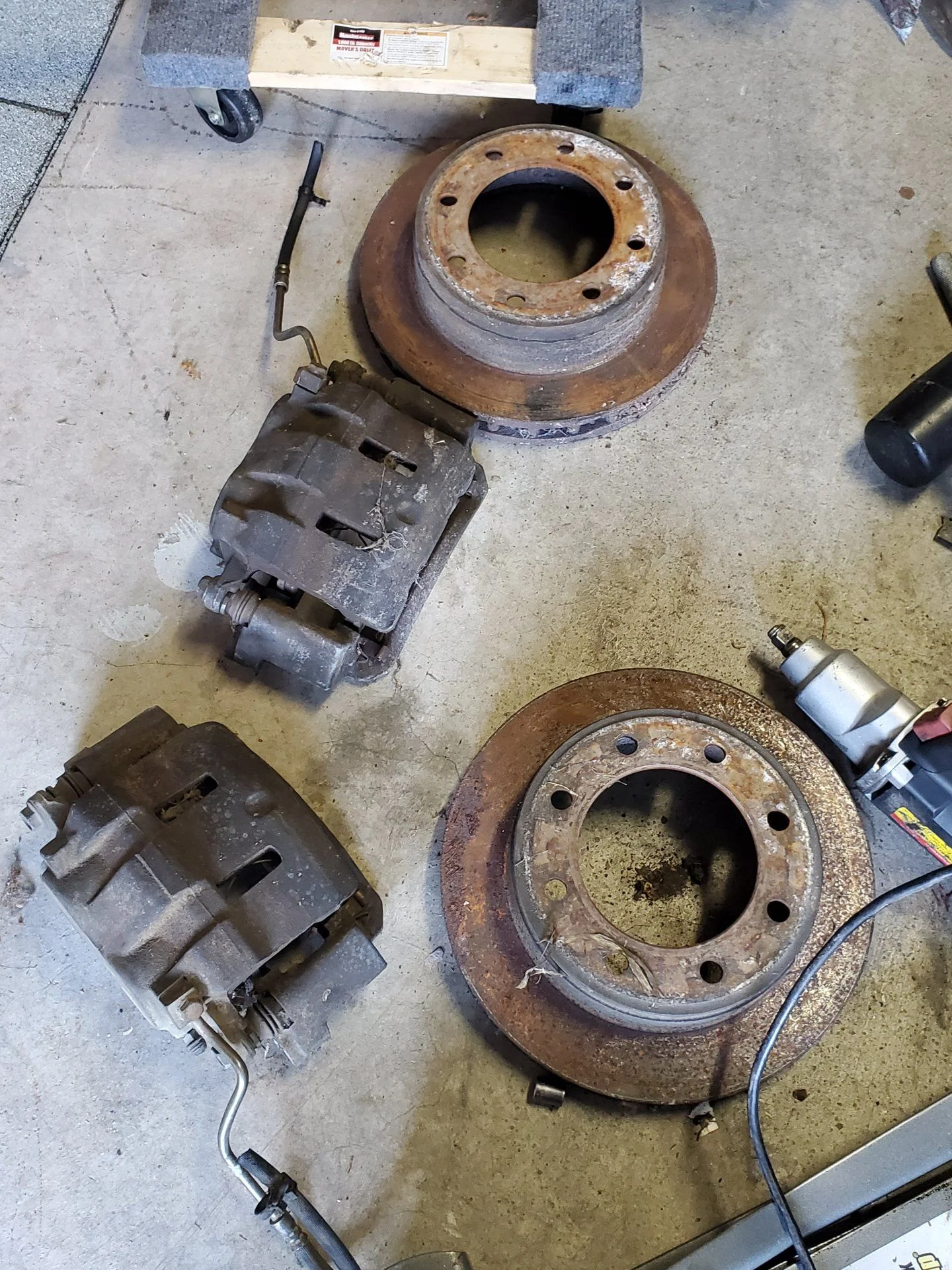

Guy has no idea where he put the other rear caliper so i'll have to find a used one or rebuilt one somewhere for it.
