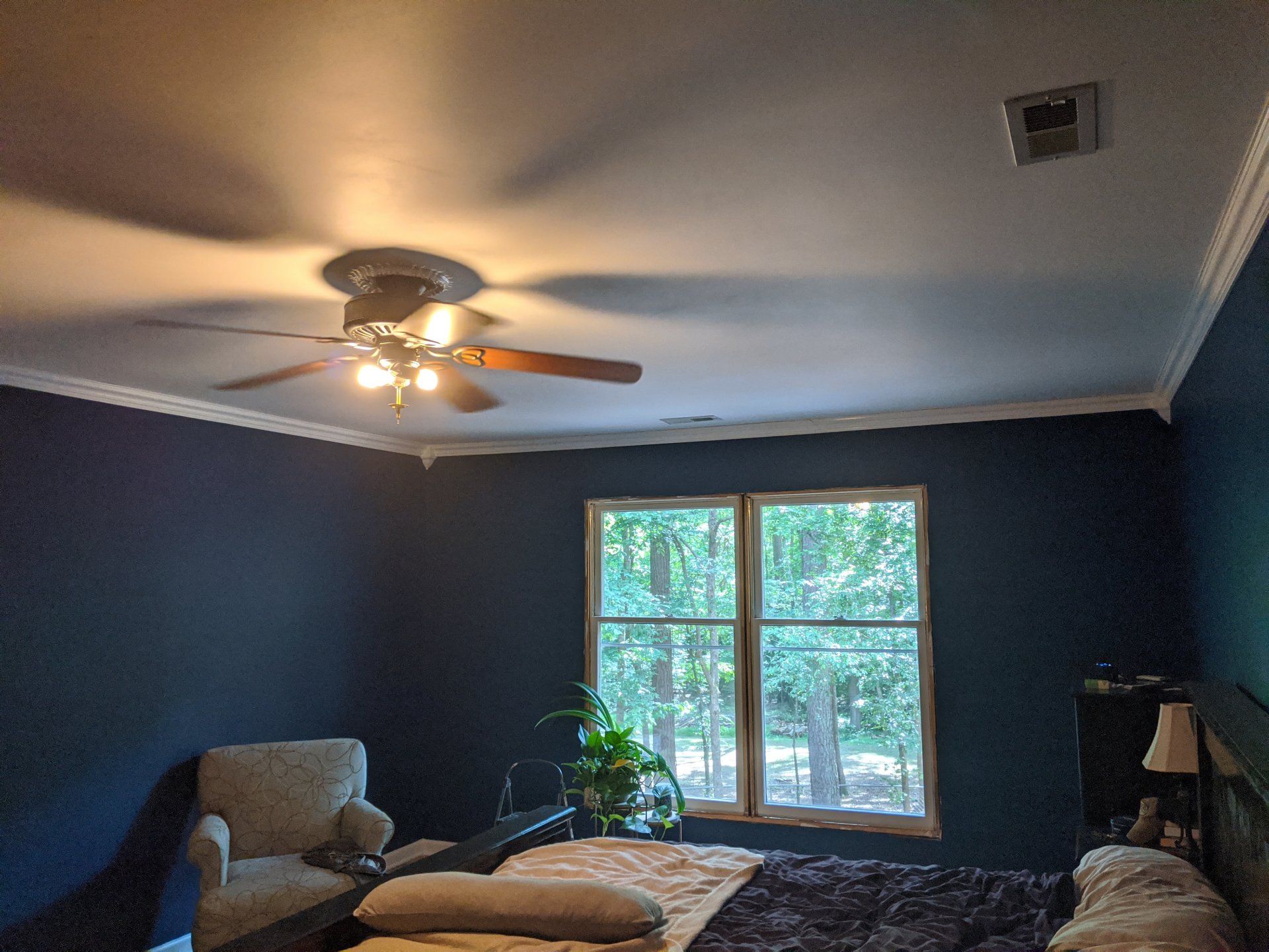

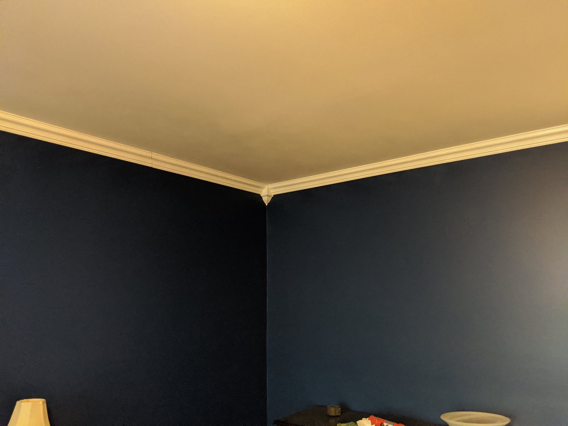

Laura has been working hard refinishing our master bedroom. She removed the popcorn ceiling, repaired/patched all the drywall, then painted both the ceiling and walls. Today I added crown moulding. Felt good. Door/window trim next.
Oh man, I removed exactly one room worth of popcorn ceiling in my life. I’d burn the house down and start from scratch before doing it again.
That's why God invented bead board! We have popcorn ceilings as well. When the time comes bead board is going in. Laminating it with 3/8" sheet rock is also popular.
Smart man using the pre-fab corners. I had to learn the hard way 😒
It's not that hard once you do enough of it. First piece straight into the corner, second piece mitered. Cut upside down and backward in the power miter and finished off with coping saw. Cut the piece 3/32 long and snap it into place. I was a builder for years and ran 3-5 piece crown molding a lot when I was trimming houses.
Lol, yup. I used mitres when I did the crown in my living room. Wanted something more substantial in the corners this time.
Nice work @coinoperated40 !! I'm a jack of all trades, master of none kind of guy... I'm going to try to tackle this live edge mantel with the limited tools, knowledge and skill I have > what could go wrong :rofl:
Got to get back to normal so the wife will quit watching home improvement videos and starting new projects
Also, removing the popcorn isn't that bad in our house as it's not sealed/painted over. Spray with some water and scrape it off with large putty knives. It's a lot of work, but not too bad.
Martin had a hell of a time with his house's ceilings though. Iirc he had to mud the whole thing to make it flat, just couldn't get the popcorn down.

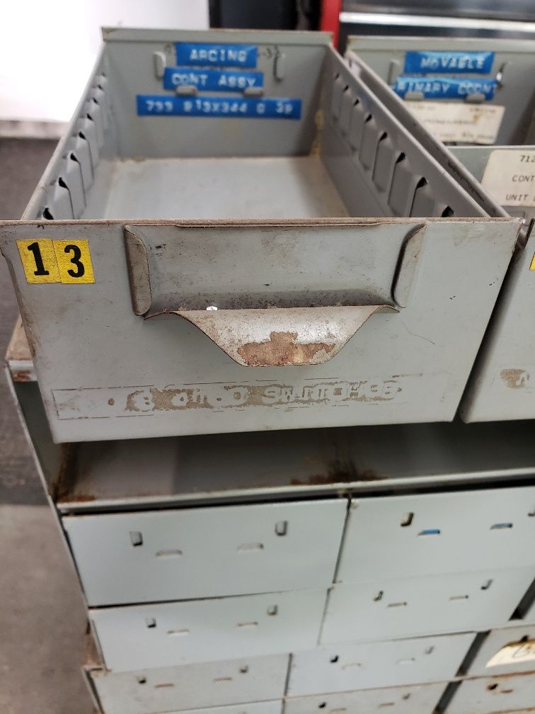

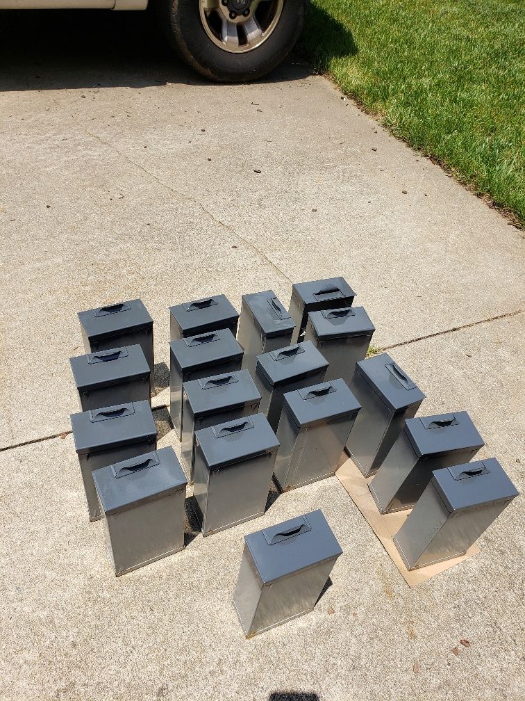

A mini-project but it has been on the to-do list for some time.
More drawers!

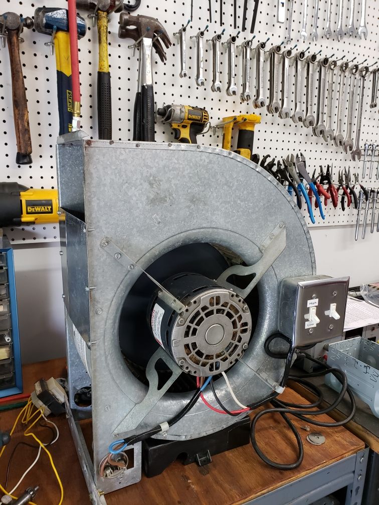

The stars finally aligned when @fj40z had some drawers to get rid of and traded me for a squirrel fan (another COVID project ... not because I needed a fan but to fight off boredom).
Physics on everyone!
More drawers!
Man I was just thinking about doing something similar with the ones I had left. That turned out nice and I love the squirrel fan!
