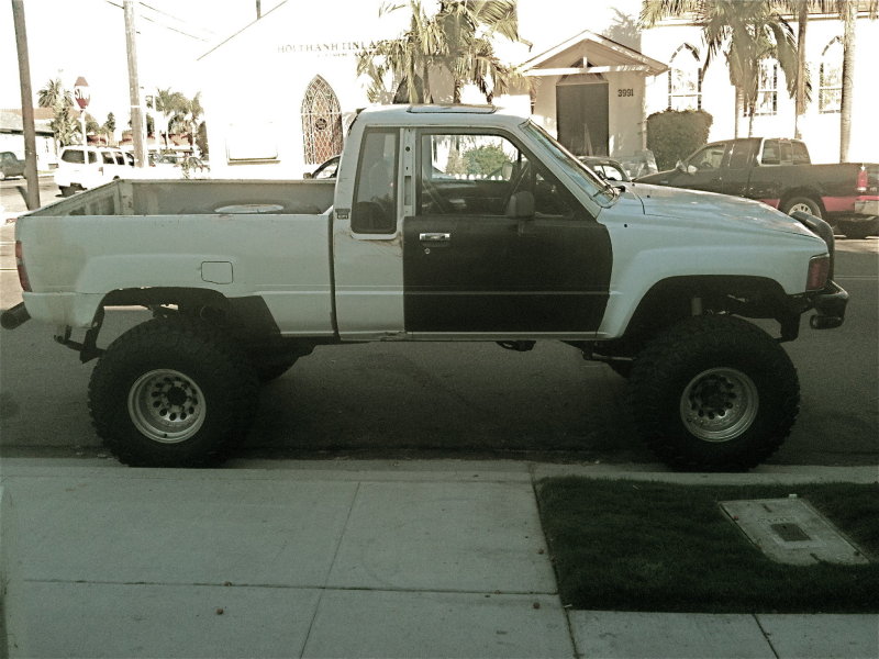

It seems like the biggest concern is the d/s angle. If I can reduce the lift I will improve the angle. I need to decide what the cheapest way to do that is. Seems like shorter shackles, removing that shackle hanger double whatever in the front, then maybe a new set up with the leafs. take one out from the back, and/or replace whats in front. Then I just need to be mindful of how that affects or does not affect the steering stuff.
Something I just realized. That is not the original front axle. It is not a fully trussed housing. Not a big deal, but if you wanna wheel that thing you might want to add a truss to the front axle.
They never had gussets on the top of the axle from the factory. That is a 85 axle from what I can tell.
I wouldn't add a top gusset my self, to much risk of warping the axle. If strength is a concern I would buy a aftermarket front housing.
double check the front ubolts. I can see a gap between them and the axle tube but unfortunately is not unheard of. Just simply double check that they are tight
Saw that gap too. I dunno about just tightening the u-bolts. Looks like the wrong u-bolts were used (round instead of squared off) scary things happen under braking torque with the wrong u-bolts. Replace 'em, they're cheap. Rig does look good with that bobbed bed though.

If I lower the lift via raising the front spring mount, and shorter shackles, less leafs, wouldnt that reduce the sketchy d/s angle?
On my 80 the double cardan drive shaft was helpful with this angle problem. I think the p/o might have said something about that... What do you y'all think about a D/C front d/s.

Just find a moderate 2 /12 inch lift kit and replace it all since i don't want it this tall anyhow, and 33s would be better for power and gas. Im going to see if there is any info on a decent moderate lift kit out there... Only worry is would that mean different drive shafts... not sure, these cant be the stock d/s can they?
Go for the moderate lift and shackles, D/C's are either bank of bust, and I don't wholly trust them.

Just an update. Picked up the pickup and drove it home. When I saw the rig in person it was uglier than it looked in the pics, more rust than you can see. A lot of oil leaking from a poorly replaced timing chain and timing cover. The steering sounded pretty bad, and the tires were pretty old.
On a positive note the engine ran good and I took the 101 fwy to avoid the grapevine. I had to downshift into 4th on a few areas especially just south of Oxnard.
So this is what is being done..:wrench:
Remove body lift on rear shackle mounts and on the front spring perch.
Put new Marlin springs in the front to match the rears.
Replace the u-bolts to fit axle.
Replace timing cover
Change oil
Replace the radiator
Replace leaking steering box with new re-man.
New Hankook 35" M/Ts
Install A/C (hopefully)
Install Alpine H/U and speakers
Adjust the headlights
In the near future I am looking into a new exhaust from the manifolds all the way back, a Maaco paint job, then some new shocks. I am not sure what length I need/can buy with my set-up. I also need to replace broken glass on sunroof, some matching unbroken side view mirrors, and shift boot.
Last but not really last:D a carpet kit. So I should have some pics up soon, probably Tuesday..:cheers:

Your front axle is 55" wide. The V6 (not taco) rear axle is 58" wide, the same as a 60 Cruiser axle.
I would personally lower those front spring hangers- they look like you could stand to lose 3" of ride height, and take some out of that front shackle too. This would lower the ride height, allow you to keep the springs, make your steering angle better, make your pinion angle more usable, and be stronger as well. The rear could be lowered a bit by losing a couple leaves and either ditching the long shackles or sleeving them through the frame.
There is no reason to use the FJ60 front axle. Sure, it's wider and slightly stronger in the diff, but it's also bigger, heavier, and more complicated in setting up for an SOA- more than likely you'd have to outboard your spring perches out to get around that differential.

More or less that is what I am trying to achieve here. I did in fact ditch the 60 axle idea, and through adjusting the spring perch and shackle mounts which both are mounted on funky fabbed up drop brackets/spacers I hope to achieve a better pinion angle.
Chuck: I agree with you whole heartedly and I have to admit something to all of you... I am not doing this work myself, due to three things: 1. Lack of experience, and no help. 2. No place to work (live in a condo). 3. I wanted to have this truck ready by next Tuesday..
I did have the vision and some instinct and understanding of the situation, just have not done this kind of stuff before. I do have a 40 that I am going to practice some small work on, since I now have 2 cars for the first time in my life. In our parking area I could see doing some gasket replacement and little things but this work needed on the truck: paint, suspension, and removing cooling system and timing cover would surely bring me some :mad: from the HOA. ;) They already don't like my leaky 40..:flipoff2:

Got the rig home tonight and its pretty great. Still working to get the a/c working, but it should get ironed out. I think part of the joy comes from the last 6 months having a 3spd, no a/c, no p/s, no radio, 60mph max, FJ40 as my only transpo. Having the solid feeling of the 85 with 5 spd gear box, bucket seats and shoulder belts, tunes and so on, it's great. I think one of the smartest things the p/o did to this truck is the 4:88s.
When the sun comes up I will get some pics posted. The other great news is the angle of the front drive shaft was significantly improved just by removing the spacers/brackets or whatever they were.
