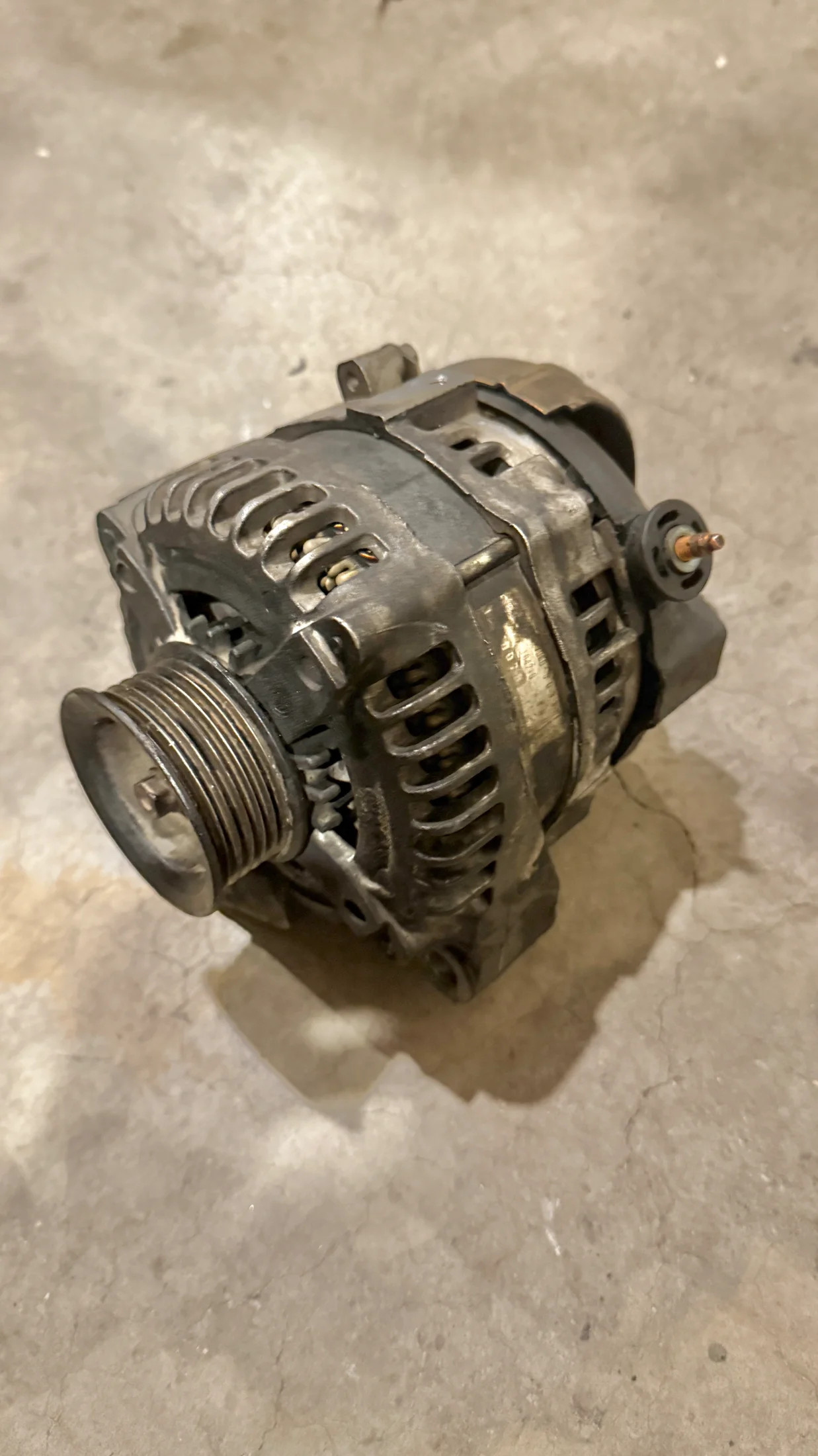

I left Sedona on my way back to Seattle last week and the battery light came on in Flagstaff roughly 1,400 miles from home. I assumed it was the alternator because the battery is only 7 months old. The only place that had an alternator in stock (Toyota included) was Auto Zone. Put in a new alternator and battery light was gone and all is good. Light has never come back and no electrical issues.
The funny part is the OEM alternator was tested at Auto Zone (several times) and tested good. There was a small amount of corosion on the ground post connection but it does have 240K miles on it. Should I turn it in for the $40 core charge? or is there a way to rebuild the OEM unit? If I can rebuild it for cheap its not really worth turning in the core. It spins freely but I do hear a small amount of what could be bearing noise.
Any opnions?

Do you have a photo of your old/failed alternator? This is an example of a failed one, soaked power steering fluid from a leak from the hose and high pressure fitting:

I’m in the process of changing out my alternator. When I have time, I’m going to see if I can fix my broken OEM unit.
It's really easy to open up and test the rectifier and regulator, like what other's mentioned brushes is easy and cheap fix for alternator. My 93 truck's alternator(OE) quit at 290k and all it needed is a set of brushes and tested strong after. You could also buy the regulator and rectifier if needed but the rectifier is the most expensive part besides the rotor and stator.
Get it rebuilt by a good starter/generator shop. Put it on the shelf. That's what I do.
Alternatively, you can buy a used 150A Tundra/Sequoia for $40-60 and rebuild that instead.
