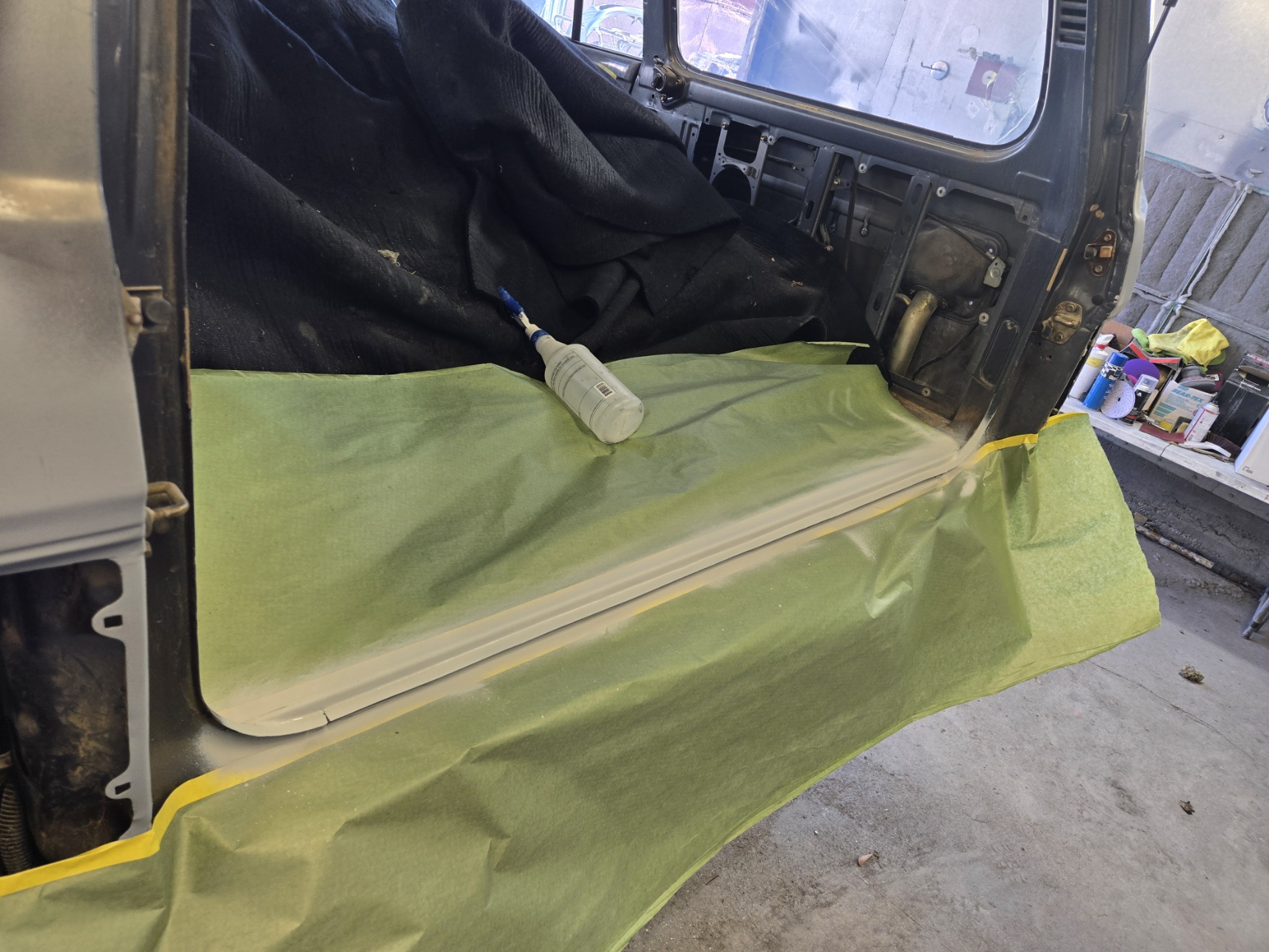

Anyone else had to repair this rust spot?
Didn't even know what it was called. Couldn't find it anywhere. Had to just cut some sheetmetal and weld it on...
Aye, I have to actually. There's an ~9" section of the seam rusted away above the right hinge that I need to weld in a replacement for. Not looking forward to it.
It's all there, so in better shape than most. It's hard to remember to remove moldings and stuff and get in under them to see what's going
on. I have sprayed mine with anticorrosion stuff and have it under control. Haven't gotten to actually cutting and welding yet, the molding grabs fine and I keep it dry now.
