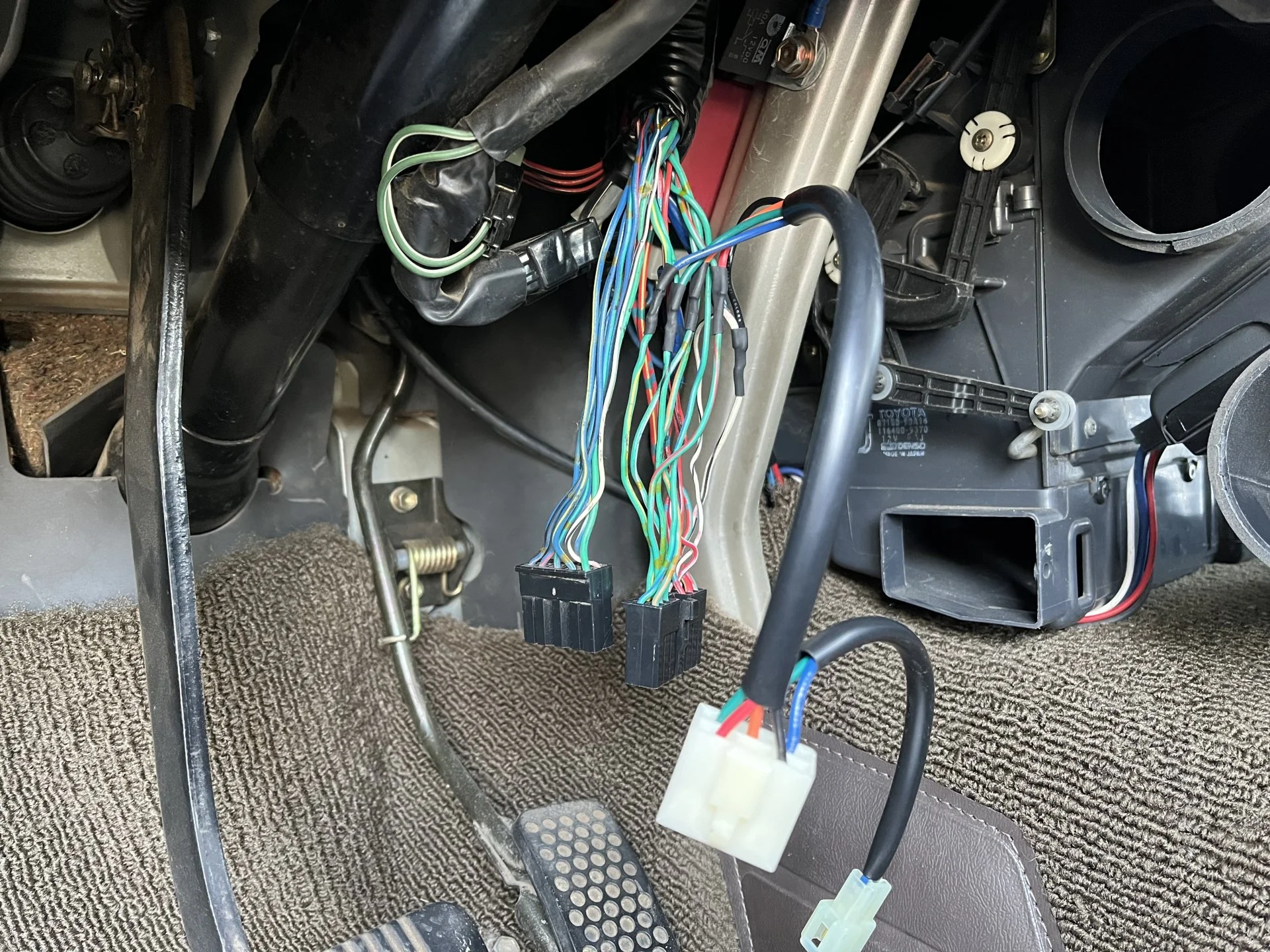

Recently I was daily driving my 62 for about three weeks, and one of the things I've missed while driving it on the FWY was the one-touch turn signal. ( I do tend to use my turn signal )
Most of the other vehicles I'm driving have that feature, so I thought I should bring my 62 into the 21st century.
Here's what I did :

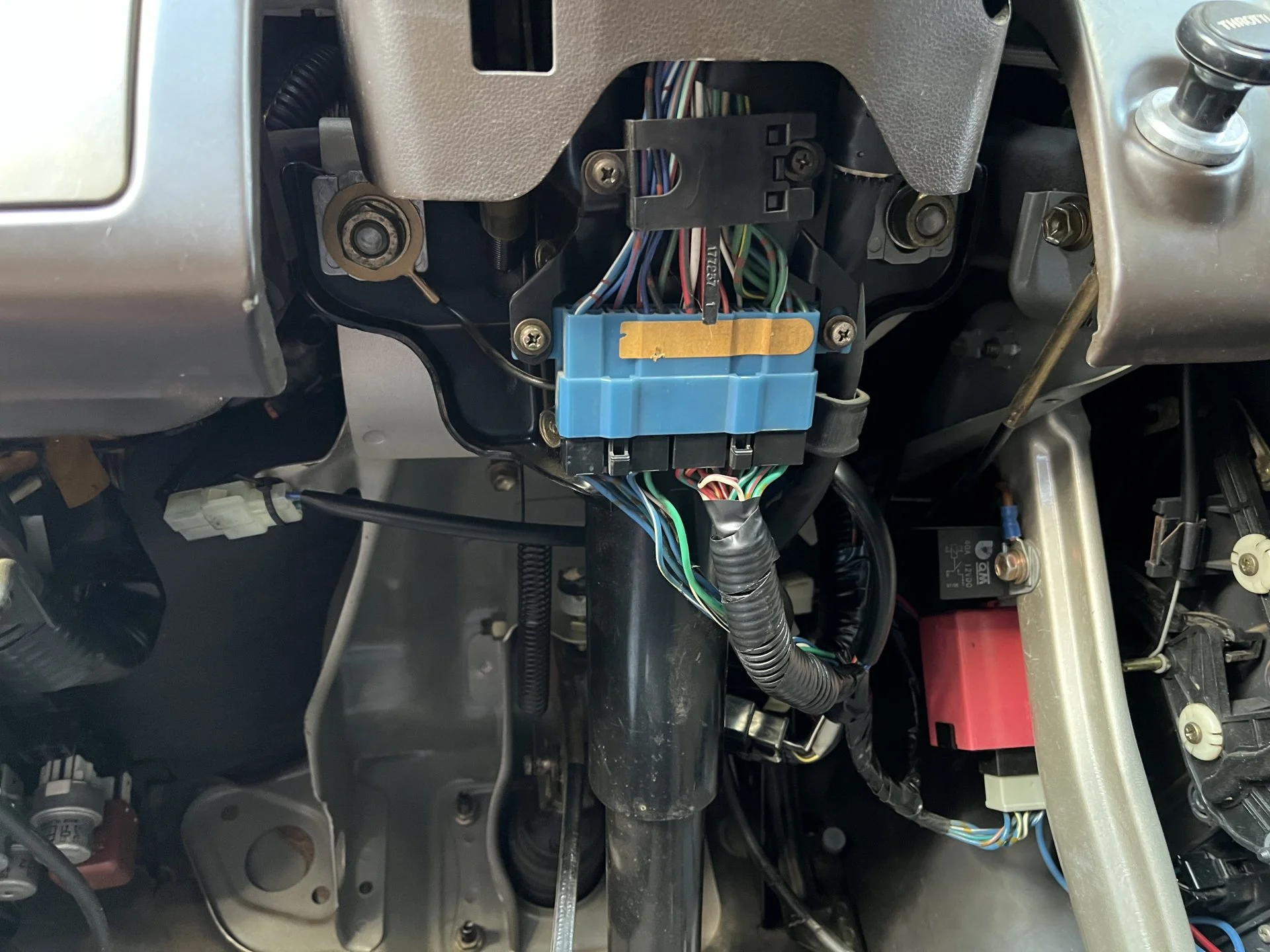

Located the turn signal wires under the steering column. Wires are in the larger black connector with the split loom.
I've made a small harness with a connector and a pig tail to connect to the factory wires. All connections were soldered
and insulated with heat shrink tubing.
After finishing I've put the loom back on the harness and plug everything back to it's original place.
It works like any other car with the one touch turn signal from the factory.

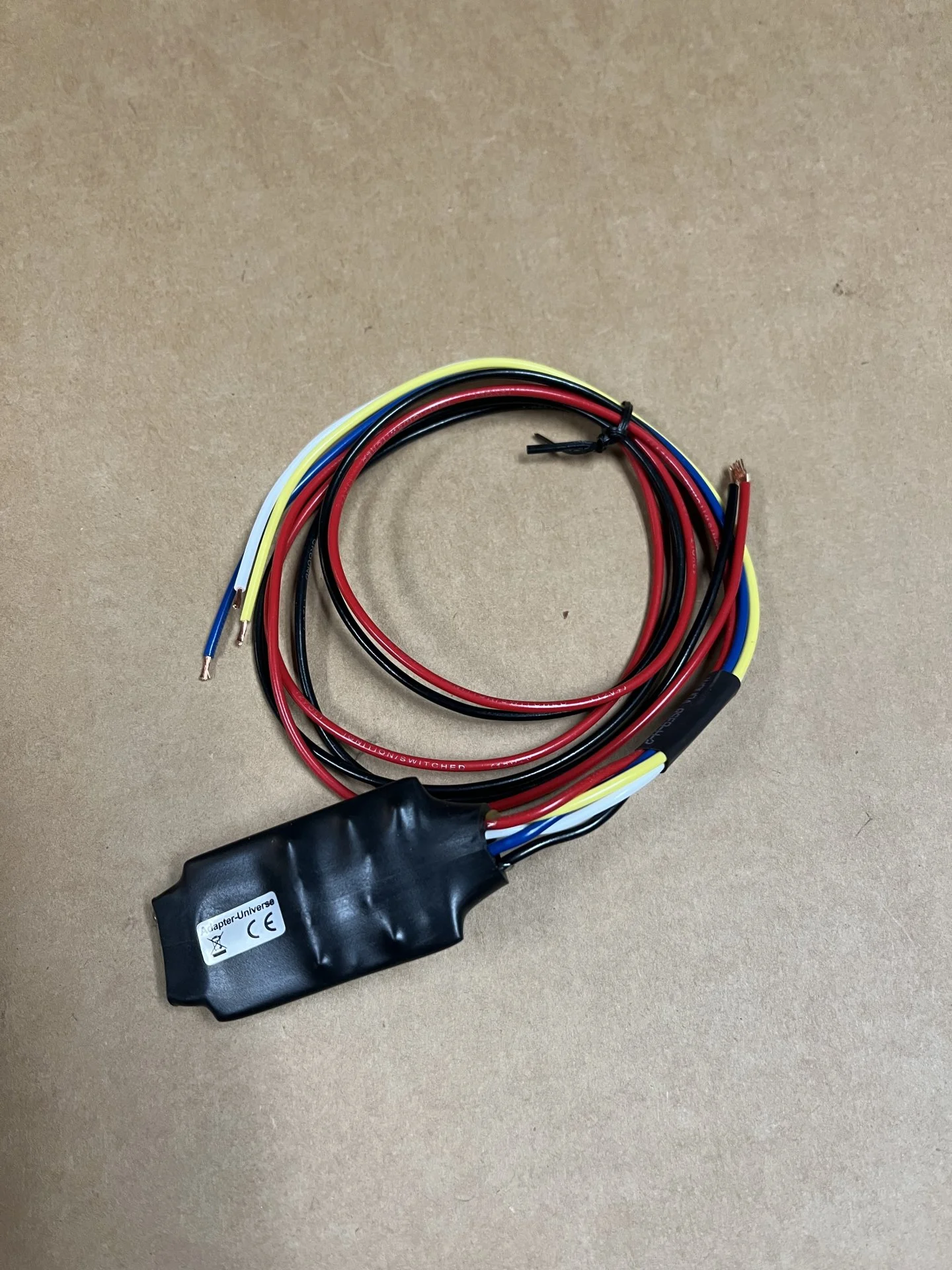

These modules can be bought online from various vendors for about $60-100.
It's a straight forward install only 5 wires, all of them are in one connector. No need to cut any factory wires.
The wires are : --- Factory colors:
1: switched 12V --- green /red ( it's marked NCA on the diagram ) It might be different color on yours
2: ground --- white/black
3: left turn signal --- green/black
4: right turn signal --- green/yellow
5: turn signal relay --- green/white
Let me know if you guys need any more info on this mod.
So the triple blink module is off camera to bottom right, off the white connector in the last photo? Never thought adding this aftermarket would be an option, this is a nice convenience upgrade.
